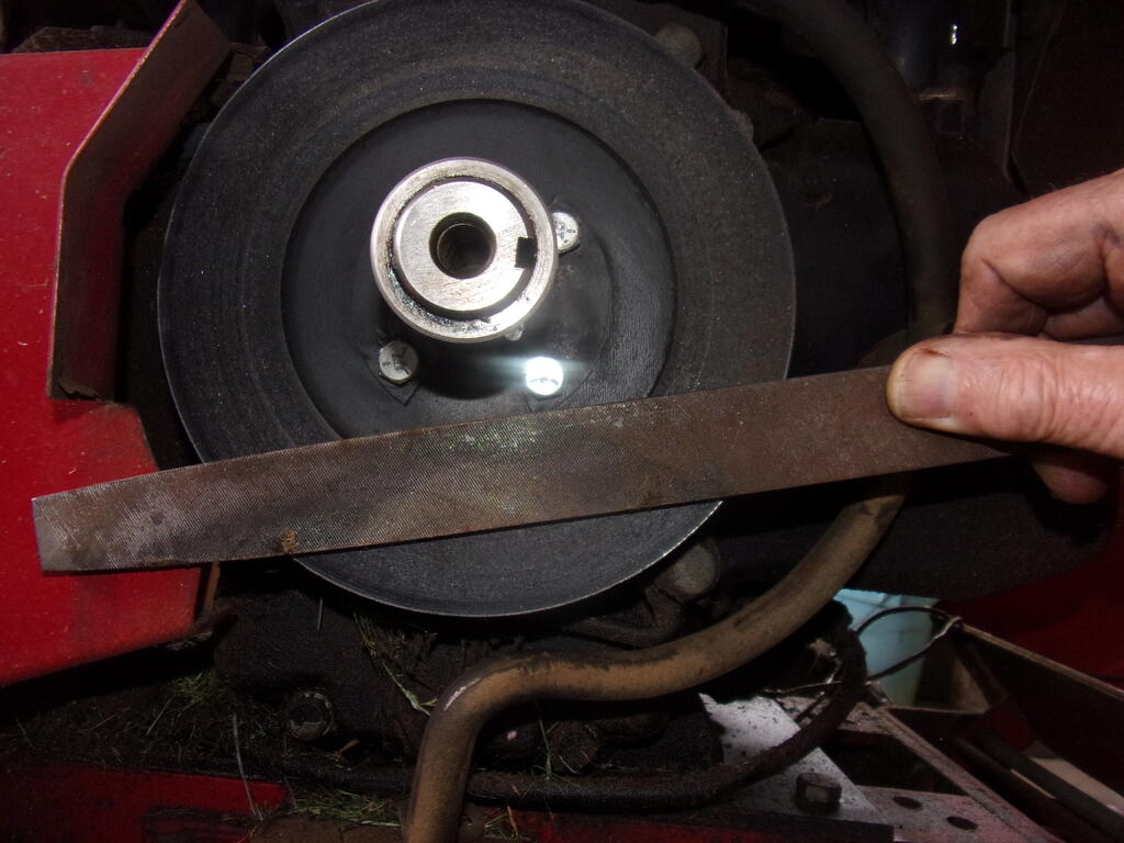

wallfish 20,658 #11 Posted December 30, 2023 2 hours ago, Wayne0 said: Hey, Ed, I don't get out to this machine very often. I'll check which pulley it's on in the next couple days.I bought it the way it is and never paid attention. Worked OK last season, but could see room for improvement. Check for the PTO bell slipping on the clutch. Or the belt slipping on there too. If that bell gets pretty hot under load it's from slipping friction of either or both slipping. You can flatten the metal surface of the bell with a belt sander and I use a block with sandpaper to flatten the clutch material. The more surface area contact between those two, the less it will slip. Adjustment for the tension too. The PTO pulleys on the 520 I got was used to run a 60" deck prior to me. The first time using it for the 2 stage there was horrible performance. Turned out the pulley grooves were worn and no amount of tension would work. Wasn't easily noticeable until an up close inspection of it. 1 1 Share this post Link to post Share on other sites
Ed Kennell 47,594 #12 Posted December 30, 2023 (edited) 1 hour ago, wallfish said: Check for the PTO bell slipping on the clutch I used a fine file and the engine to machine mine to get full contact. Edited December 30, 2023 by Ed Kennell 3 Share this post Link to post Share on other sites
