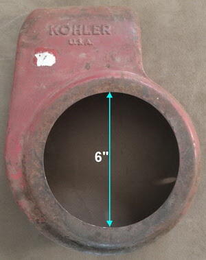

rmaynard 16,771 #1 Posted December 29, 2023 I have a blower cover from a K-161. I am trying to modify it for another project and need to expand the diameter of the front opening. Considering that I don't have a machine shop, how would you suggest that I neatly increase the inside diameter from 6 inches to 6.25 inches? 1 Share this post Link to post Share on other sites
wallfish 18,857 #2 Posted December 29, 2023 Mark the circle 1/8" from the edge. a grinder You can get metal blades for a jig saw and clamp the saw upside down in a vice Same for the grinder as it's probably easier to control the piece vs the tool 6 1 Share this post Link to post Share on other sites
Kenneth R Cluley 654 #3 Posted December 29, 2023 Drum sander in a drill press. Mark at 1/8" and lock quill. Attach a piece of plywood to table, slide, rotate cover until desired size. 10 Share this post Link to post Share on other sites

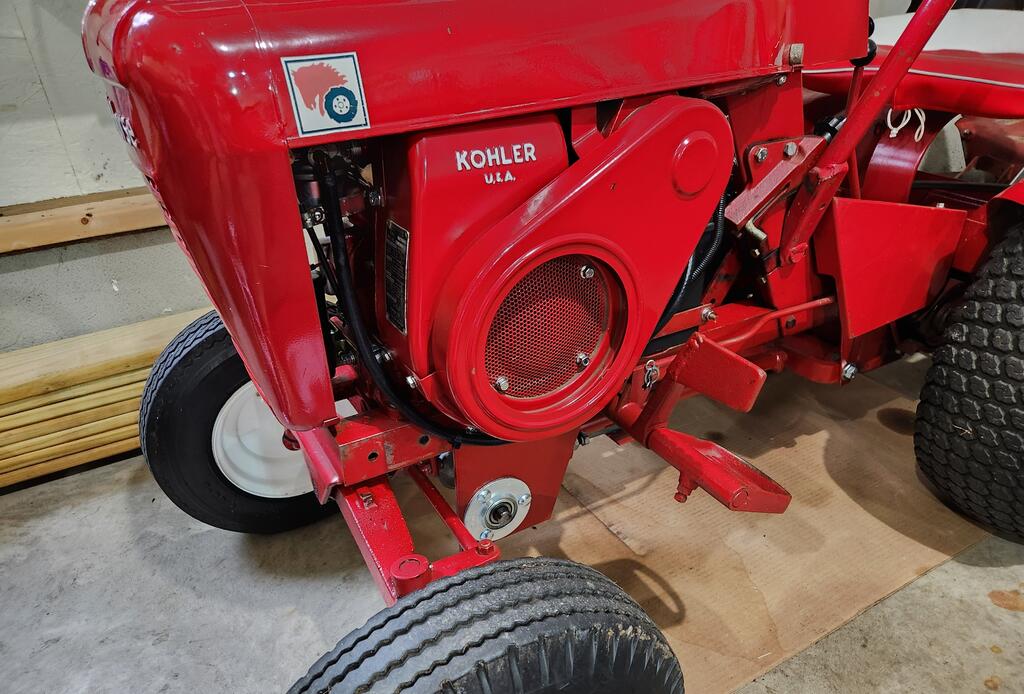

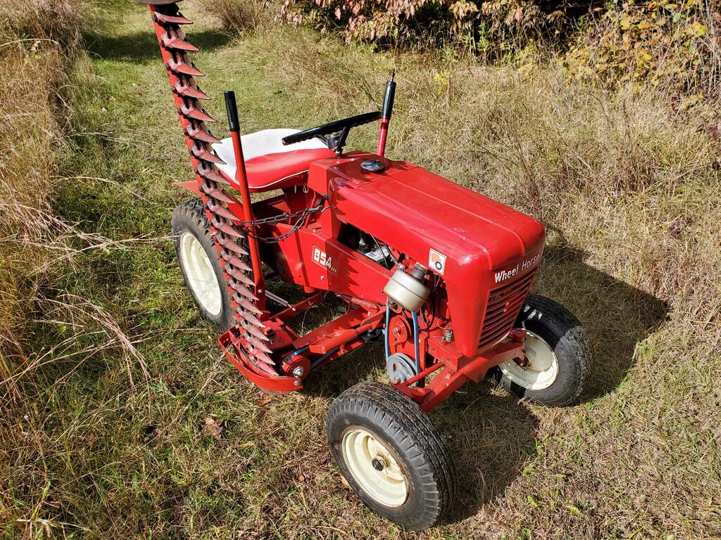

Racinbob 12,504 #4 Posted December 29, 2023 I recently did just that (except to 6.5") with a jig saw. I swapped the electric start goodies on a 181 over to a yank start 161. I had the shroud firmly fastened to the work bench but you might find it easier clamping the saw like John said. You can't see it in this picture but you couldn't tell it was cut. High speed on the blade but slow and easy as you cut. 9 3 Share this post Link to post Share on other sites
rmaynard 16,771 #5 Posted December 29, 2023 Thanks for the quick replies. All very good. I'll keep looking to see what others come up with. My idea is to take my 150mm hole saw (should fit inside of the 6" opening) and wrap it with self-adhesive 80-100 grit emory paper, slowly grinding and adding layers until I reach 6.25". Sometimes these ideas sound good in my head, but in practice not so much. 2 1 Share this post Link to post Share on other sites
Handy Don 15,608 #6 Posted December 29, 2023 1 hour ago, Racinbob said: yank start 161 Bob, This modification to the mid-hitch has me very curious. Can you please explain & add pics from the other side? 😁 1 Share this post Link to post Share on other sites
8ntruck 8,472 #7 Posted December 29, 2023 22 minutes ago, Handy Don said: Bob, This modification to the mid-hitch has me very curious. Can you please explain & add pics from the other side? 😁 Probably a jack shaft for the mower drive. Round hoods were built before the invention of the front mule drive. 1 Share this post Link to post Share on other sites
Handy Don 15,608 #8 Posted December 29, 2023 6 minutes ago, 8ntruck said: Probably a jack shaft for the mower drive. Round hoods were built before the invention of the front mule drive. I don’t see any sort of latching or mower frame, so this appears to be a complete “permanent” replacement for the round hood style mid hitch, at least on this side, using a permanent bearing. 1 Share this post Link to post Share on other sites

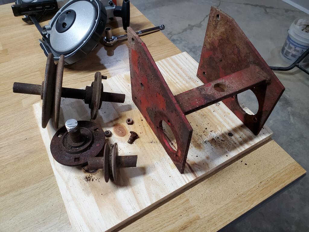

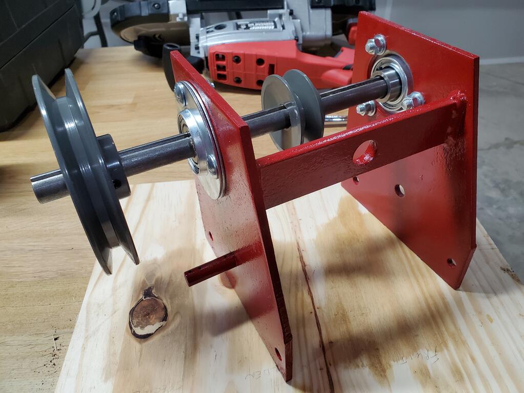

Racinbob 12,504 #9 Posted December 29, 2023 50 minutes ago, Handy Don said: Bob, This modification to the mid-hitch has me very curious. Can you please explain & add pics from the other side? 😁 Typical setup for a sickle bar mower guys. Not modified, just rebuilt using components from Surplus Center. The entire mower was a frozen pile of rust when I got it. The attach-a-matic has to be replaced with the sickle drive setup. 8 3 1 Share this post Link to post Share on other sites

CCW 1,457 #12 Posted December 29, 2023 @rmaynard The sandpaper idea has some merit. Perhaps start with drawing the outside diameter of the new hole with pencil or marker and grind close to the line. Then use your hole saw and sandpaper to bring it closer and finish with a file. 1 1 Share this post Link to post Share on other sites
rmaynard 16,771 #13 Posted December 29, 2023 2 hours ago, CCW said: @rmaynard The sandpaper idea has some merit. Perhaps start with drawing the outside diameter of the new hole with pencil or marker and grind close to the line. Then use your hole saw and sandpaper to bring it closer and finish with a file. Good idea. Thanks 1 Share this post Link to post Share on other sites
peter lena 9,642 #14 Posted December 29, 2023 @rmaynard might try curved tin snips , draw , scribe ,your intended increase , try tin snips on a trial piece , for actual , cutting ability . done a lot of tin snipping , its a doable thing , Pete 1 1 Share this post Link to post Share on other sites

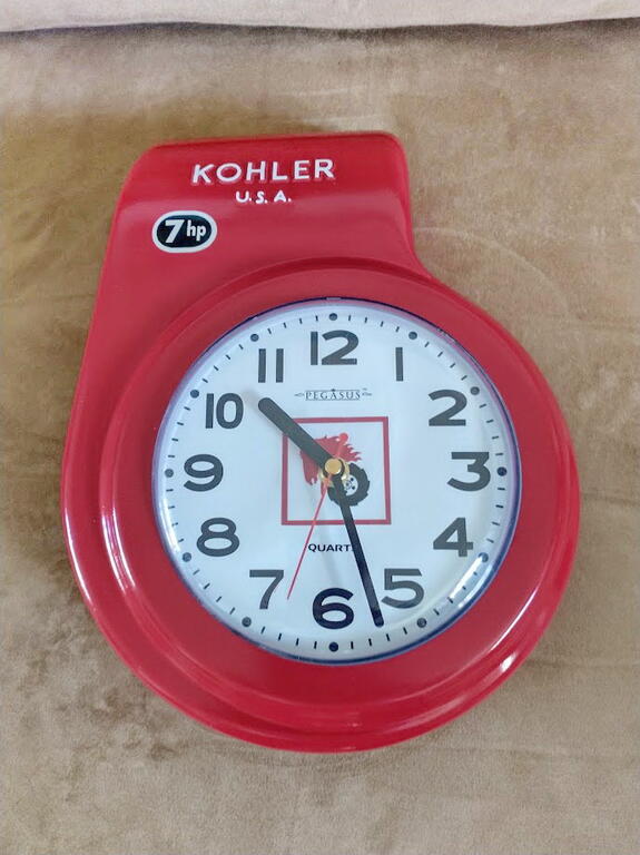

rmaynard 16,771 #17 Posted February 4, 2024 Follow-up Using the suggestion of @CCW "start with drawing the outside diameter of the new hole with pencil or marker and grind close to the line" was the method that I used. Then I finished with the hole saw with abrasive attached. Finished project Before: Grandson Mason loved it. 8 1 1 Share this post Link to post Share on other sites
