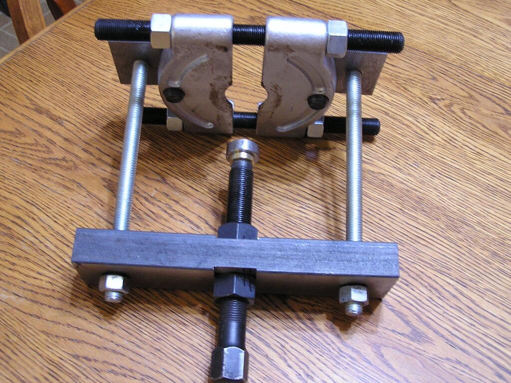

peter lena 10,074 #1 Posted December 29, 2023 https://www.grainger.com/product/23M596?gucid=N:N:PS:Paid:GGL:CSM-2295:4P7A1P:20501231&gad_source=1&gclid=CjwKCAiA-bmsBhAGEiwAoaQNmituGJatrMr9yqEQZmfbdCRJDP5wr2GTCpPGUzmaMEdUKhHRWR4IkxoC6tMQAvD_BwE&gclsrc=aw.ds all to often , see the wrong type puller used on the weakest spot of , hub , that would be the outer bolt flange , the closer you get to axel mount / hub start point . the more effect your pull will be , KROIL is what you want , on / in that area , days out , remove any holding bolt / Allen plug ,DRIVE it around , get that KROIL CREEPING , thats what it does best , usually a rust run out track , will show its working . a pull on the axel / flange inner start point is what you want , strength against strength , not against outer bolt flange . get that KROIL , working , shop around for similar , puller at H/F . just a suggestion , puller pete 5 1 3 Share this post Link to post Share on other sites

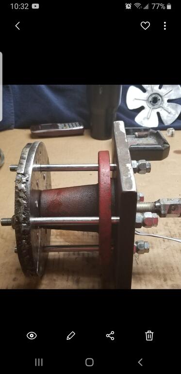

ri702bill 13,080 #2 Posted December 29, 2023 You mean like this?? 7 2 Share this post Link to post Share on other sites

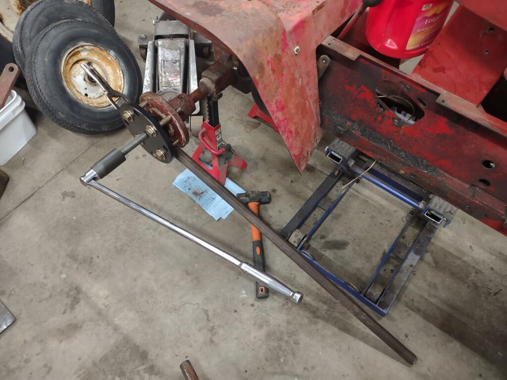

Achto 32,781 #3 Posted December 29, 2023 (edited) 2 hours ago, peter lena said: all to often , see the wrong type puller used on the weakest spot of , hub , that would be the outer bolt flange So far I've been lucky using the bolt flange. In the pic below you can see the extreme amount of pressure that I was exerting on this hub. One bar to keep the puller from turning as I tightened the jack bolt with a 36" long breaker bar. Tons of pressure, rap on the smaller portion of the hub to create vibration, hub moved about .010", more pressure, more hammering, etc. This hub fought me every inch of the way like this, but I finally won without damaging anything. Yes there was plenty of lube involved as well. Edited December 29, 2023 by Achto 4 3 Share this post Link to post Share on other sites
peter lena 10,074 #4 Posted December 29, 2023 @ri702bill thats what you want ! that solid movable strength , pulling on a solid hold , has moved more frozen failures than , anything else tried , also used variations of the initial pull , also lubricate all related threading , that sheer strength on dry threads , will damage , threading , thin / sharpen them . as suggested , KROIL is a killer for rusted anything , do it days out , as well ; as during pull. make a point of just , a drop of Kroil , on any possible problem point . that solid release , with the right combination , is like magic, thats what you want, Pete 2 Share this post Link to post Share on other sites

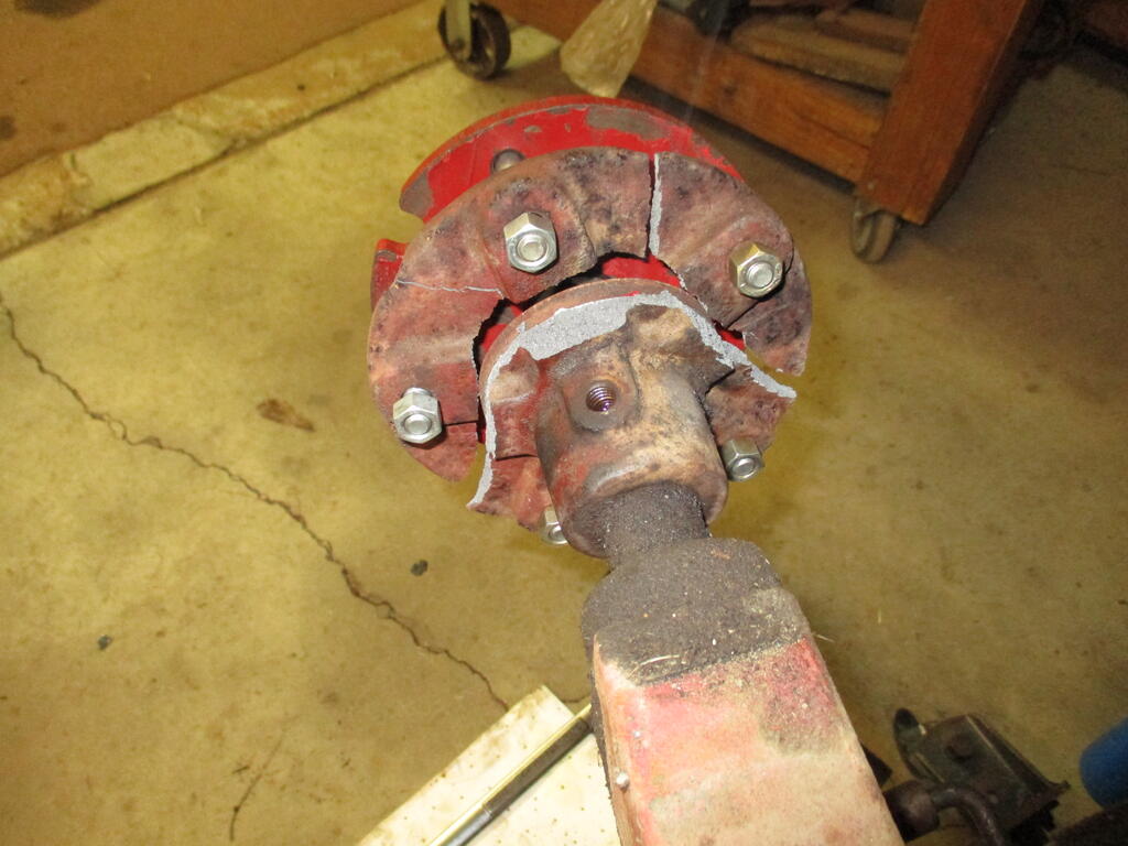

pfrederi 21,167 #5 Posted December 29, 2023 59 minutes ago, Achto said: So far I've been lucky using the bolt flange. In the pic below you can see the extreme amount of pressure that I was exerting on this hub. One bar to keep the puller from turning as I tightened the jack bolt with a 36" long breaker bar. Tons of pressure, rap on the smaller portion of the hub to create vibration, hub moved about .010", more pressure, more hammering, etc. This hub fought me every inch of the way like this, but I finally won without damaging anything. Yes there was plenty of lube involved as well. Until a couple weeks ago I had great success with a set up like yours...But that is a newer hub much thicker flange I just broke one of the older thinner flange hubs. For D series and GT14 hubs pulling from the back is the only way to go 2 4 Share this post Link to post Share on other sites
ri702bill 13,080 #6 Posted December 29, 2023 Yeah Paul, those star style hubs are all too easy to break - no choice then but to get tough with it - slit it and crack the hub remains off. Too bad the seal was not leaking more for longer - usually makes removal easy... 4 Share this post Link to post Share on other sites

EB-80/8inPA 2,116 #9 Posted December 30, 2023 9 hours ago, Achto said: In the pic below you can see the extreme amount of pressure that I was exerting on this hub Do you use a torque wrench to make sure the load is evenly distributed around the hub when setting that up? TIA. 1 Share this post Link to post Share on other sites
Achto 32,781 #10 Posted December 30, 2023 9 hours ago, EB-80/8inPA said: Do you use a torque wrench to make sure the load is evenly distributed around the hub when setting that up? I just spin all the bolts in by hand until they run out of threads. 1 Share this post Link to post Share on other sites

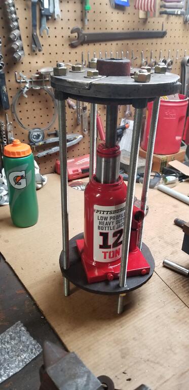

gt14rider 1,278 #11 Posted December 30, 2023 This pulls from back. Made from scrap laying around. 5 Share this post Link to post Share on other sites

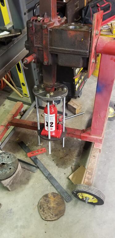

gt14rider 1,278 #12 Posted January 3, 2024 Here's another version. 3 Share this post Link to post Share on other sites
ebinmaine 80,756 #13 Posted April 27, 2025 On 1/2/2024 at 7:46 PM, gt14rider said: Here's another version. @gt14rider Thanks for posting this lower pic with the transmission hanging. It's always good to see "in process" shots of how people accomplish their tasks. Share this post Link to post Share on other sites
