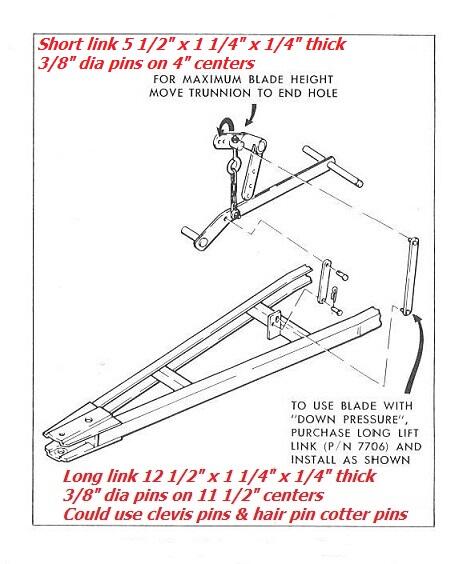

Wayne0 1,634 #1 Posted December 23, 2023 So, I currently use a 3' piece of rail road track on top of the blade for down pressure. WH made a special link so the plow wouldn't "float". Following specs I found online, I made one, as they are no longer available. My question, is, where does the link attach to the tractor? The original lift arm has a chain. Does it attach to the rock shaft instead of the chain? Pics would help. Share this post Link to post Share on other sites
8ntruck 9,305 #2 Posted December 23, 2023 The solid link replaces the lift chain. 2 Share this post Link to post Share on other sites
ebinmaine 80,756 #3 Posted December 23, 2023 We put ours from the outermost hole of the upper rock shaft to the plow frame. 2 Share this post Link to post Share on other sites
Wayne0 1,634 #5 Posted December 23, 2023 Thanks all for the info!! 1 Share this post Link to post Share on other sites

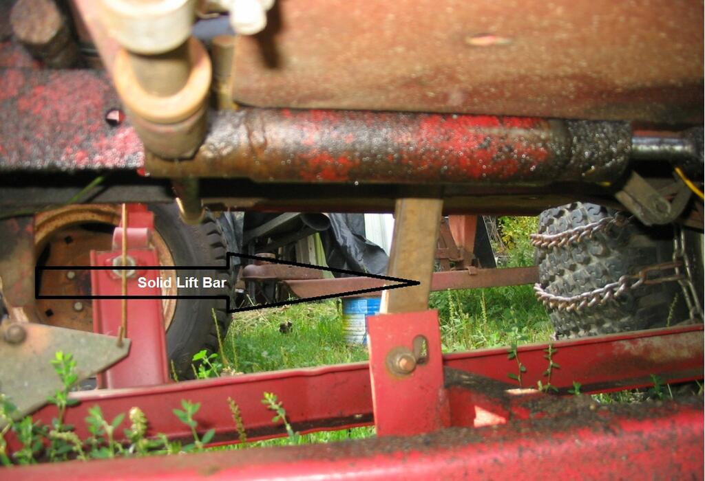

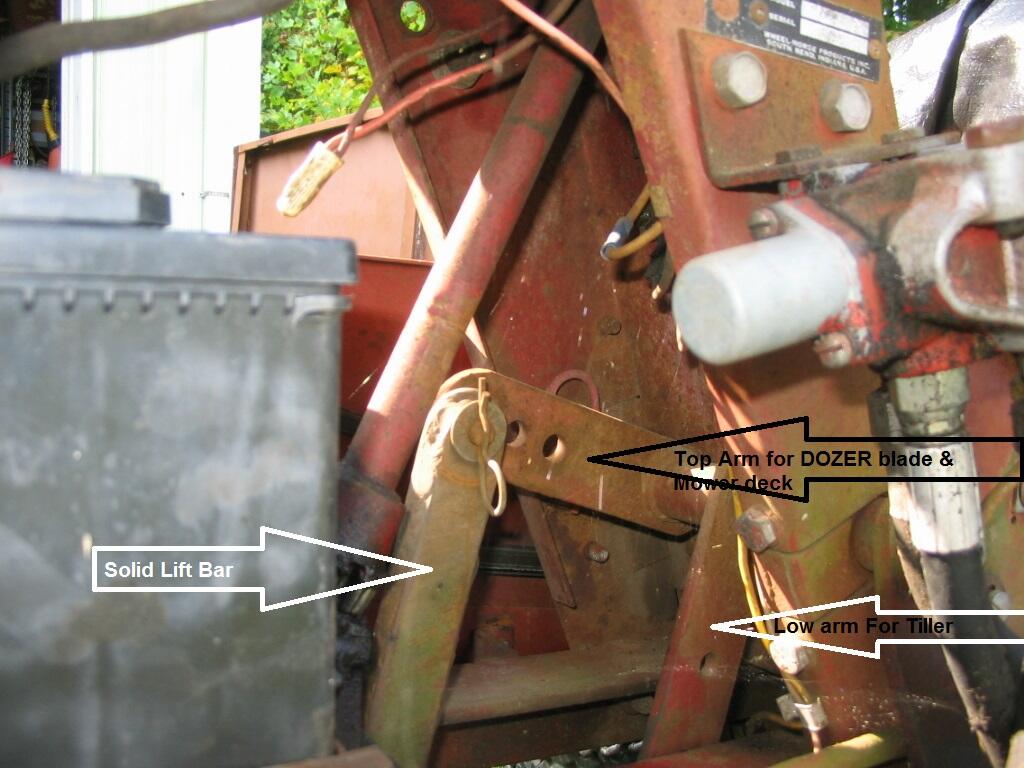

daveoman1966 3,884 #6 Posted December 24, 2023 Here it is on my C-160 Auto... 5 Share this post Link to post Share on other sites
wallfish 20,618 #7 Posted December 24, 2023 The thing with a solid link on hydro lift is that it won't allow the blade to float or at least as much. With a manual lift the handle will still move with the blade and allow it to float with the terrain. IMO it's better to use weight and a chain on a hydro. The holes for a solid link can be slotted to allow for some float and you can see the slotted hole in the pic above but it's not being used. Of course everyone's situation is different whereas a nice flat concrete surface is much different than a crowned bumpy gravel driveway. 2 Share this post Link to post Share on other sites

ri702bill 13,080 #14 Posted December 24, 2023 (edited) Using the long link, like I do with the C81, you have 2 choices as to what to do with the upper rear pivoting lift arm - it gets in the way of the plow frame. I used a large zip-tie to hold it up and left it there . . so-so. Now I remove the arm - real easy with one C-clip - no issues. Using the short link to replace the chain you still have the arm to deal with... Edited December 24, 2023 by ri702bill 1 Share this post Link to post Share on other sites

wallfish 20,618 #16 Posted December 24, 2023 32 minutes ago, Wayne0 said: Good point! Hadn't though of that! Might make it hard to steer. Use the slot hole on the plow frame if you try a solid link. The slot can be made longer which will allow for a bit more float and adjustment. Pretty easy to make a solid link. Raise the lift all the way up. Support the plow blade in the up position and measure the distance between the 2 holes. Cut a piece of flat bar and drill the two 5/16 holes at the distance you measured. Use bolts and nuts to secure it. In order to not pinch it tight and allow for those parts to move easily, use 2 nuts per bolt pinched tight to each other and leave the link a loose fit on the rockshaft and the plow frame. 3 Share this post Link to post Share on other sites
Racinbob 13,199 #17 Posted December 24, 2023 1 hour ago, ri702bill said: Using the long link, like I do with the C81, you have 2 choices as to what to do with the upper rear pivoting lift arm - it gets in the way of the plow frame. I used a large zip-tie to hold it up and left it there . . so-so. Now I remove the arm - real easy with one C-clip - no issues. Using the short link to replace the chain you still have the arm to deal with... I always use the long so I can control downforce and the lift arm is a bit of an issue. It doesn't hit the plow frame but it's kinda in the way of the long link. It rubs it pretty hard. It would be an easy fix if I just made another long arm with 1/4" spacers and there would be plenty of clearance. I could either weld one up (but no welder) or just use bolts and spacers like John mentioned. Every year I tell myself I'm gonna do that but every year I end up removing the lift arm since it's so easy. 2 Share this post Link to post Share on other sites
