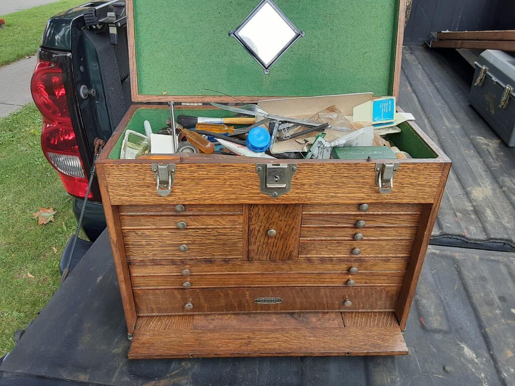

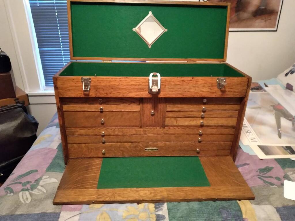

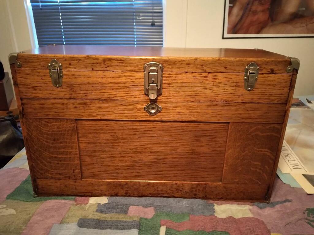

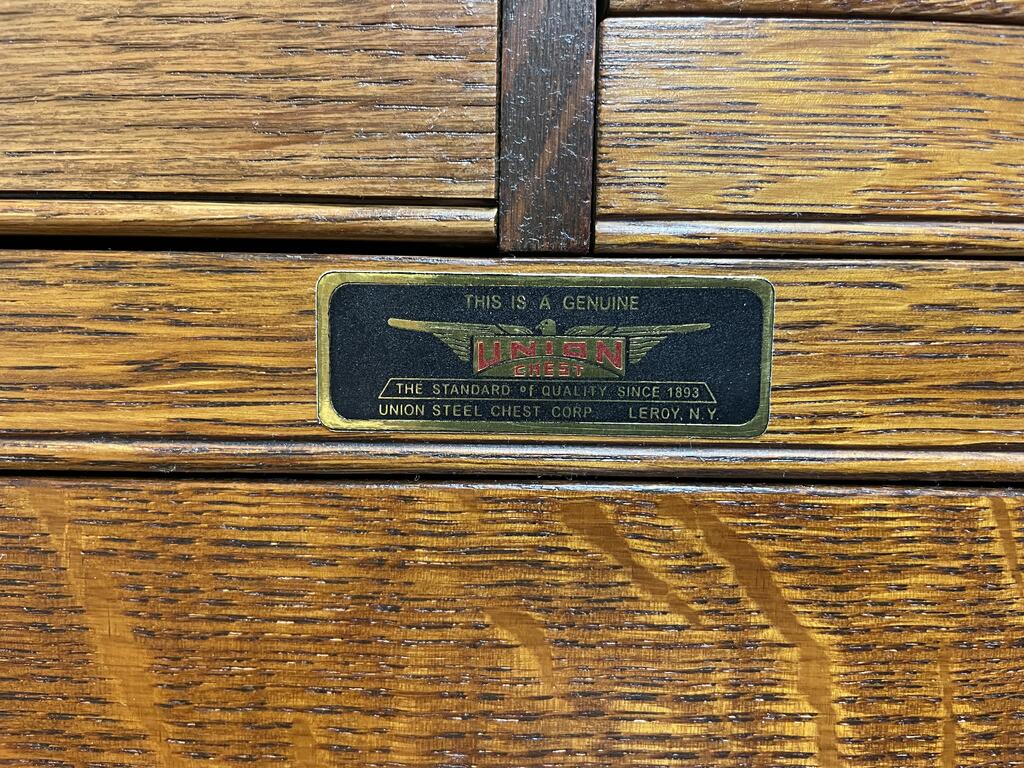

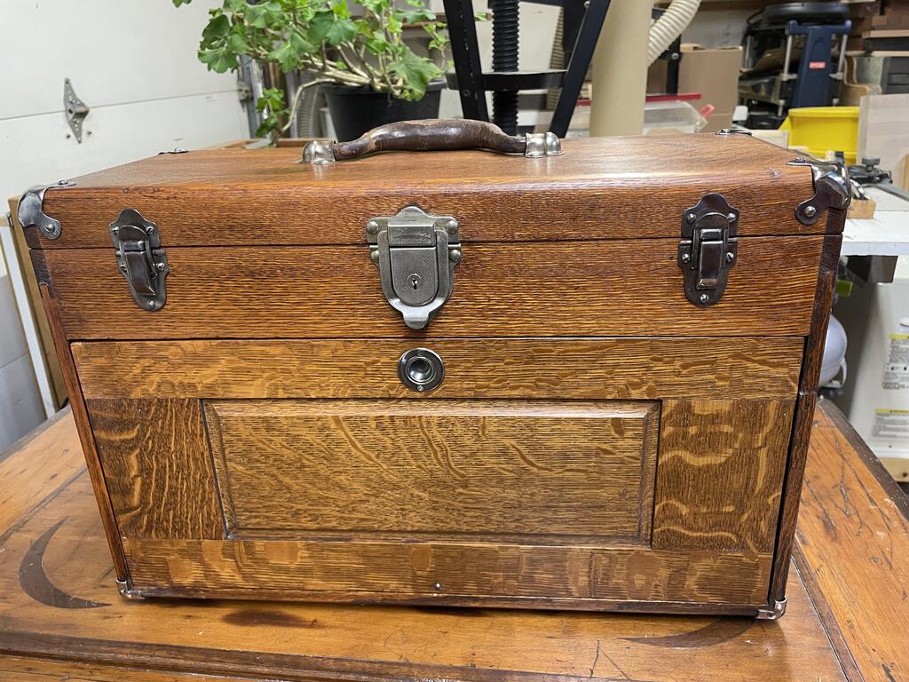

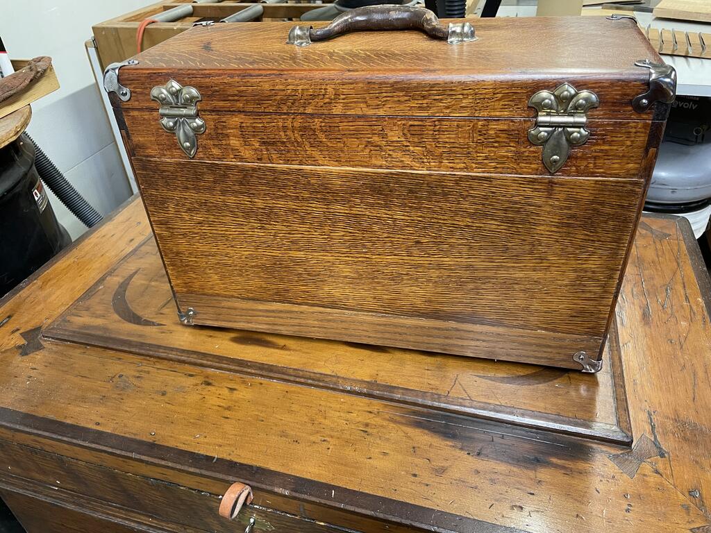

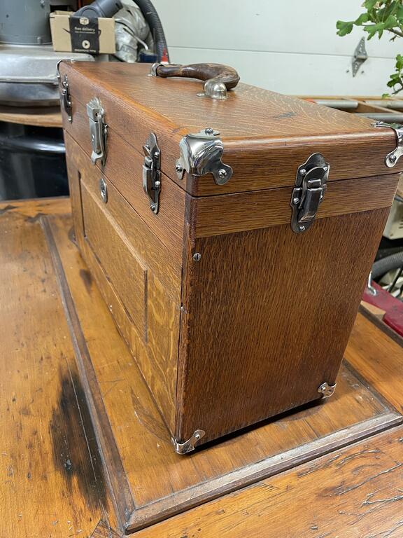

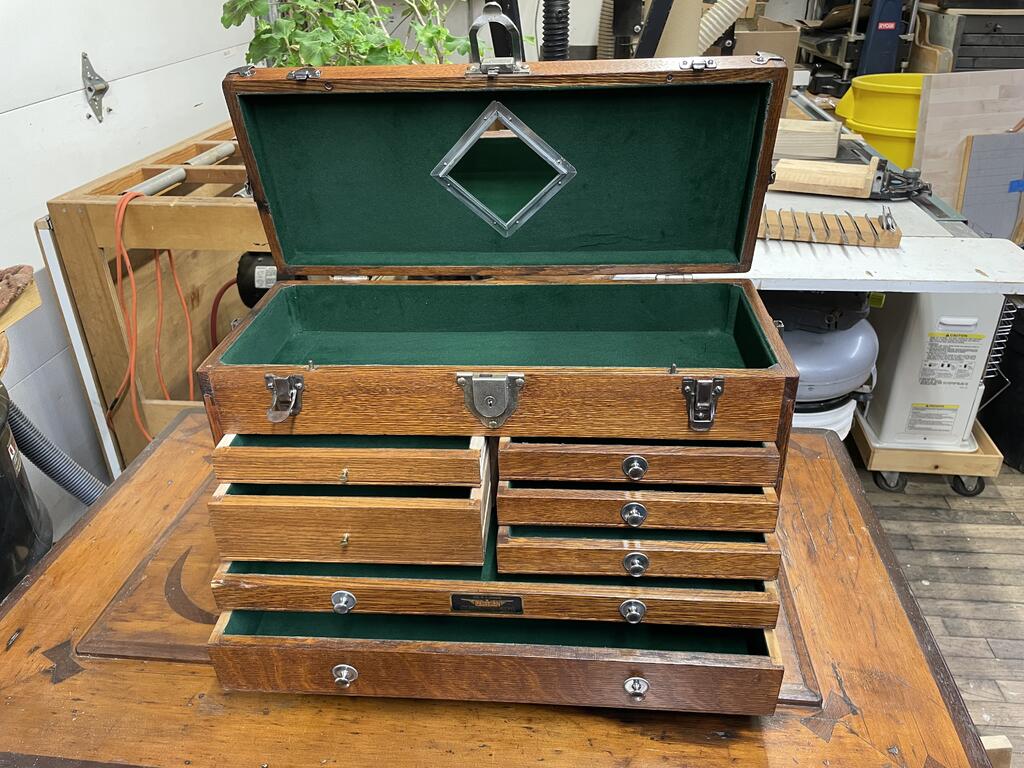

formariz 12,381 #1 Posted December 22, 2023 I was offered this vintage machinists tool box by @Handy Don who was kind enough to even bring it to me. It is from the 50s. It was missing two drawers and at some time in its life it was exposed to water. Some veneer in back had delaminated and broken off. As soon as he offered it I knew right away its future function. My oldest son has given similar machinists boxes , but in metal to each one of the boys. So I am giving this one to my granddaughter. She can keep her little stuff in it and it can also be a future jewelry box. It’s Union Tool Chest model B20 from 1950. It is stamped on the interior with number 394 which I am sure it’s the serial #. Made two new drawers and repaired veneer. Also lined all the drawers with new felt this time lining the entire inside surface of drawers . Removed the old damaged finish , restained it and applied some wipe on poly . Finally cleaned and reinstalled all hardware. Even found a reproduction factory tag for it. I just need to find two correct little pulls for new drawers. Rather than being discarded it now will have a new life and purpose for at least another generation. Thank you @Handy Don Before After Before After 2 16 4 Share this post Link to post Share on other sites

formariz 12,381 #10 Posted December 22, 2023 2 hours ago, WHX?? said: Could those drawer pulls be turned on a lathe? They could. However last night I found that Gerstner sells identical backplates. They also sell the little knobs although the shape may be a little different. I have already ordered both. Share this post Link to post Share on other sites

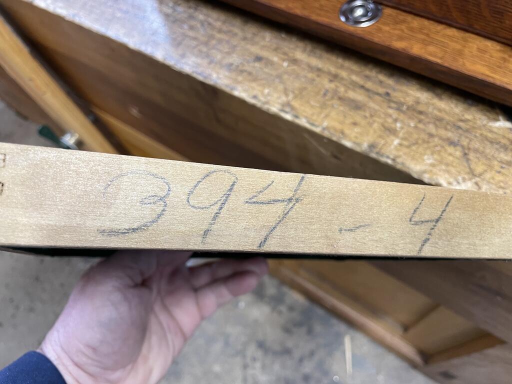

formariz 12,381 #11 Posted December 22, 2023 Correction. The number 394 stamped inside box is not a serial number but rather a number to identify all the parts belonging to box during manafacturing and or assembly. Front lid is also stamped on edge with same number and drawers have it hand written on back along with their respective locations within box. 3 Share this post Link to post Share on other sites
Handy Don 17,484 #12 Posted December 22, 2023 (edited) Makes perfect sense when you figure there was likely some handwork to do final fitting of the drawers and door. Probably also had to do with grain matching. Edited December 22, 2023 by Handy Don Share this post Link to post Share on other sites

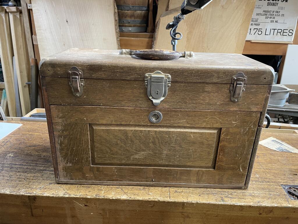

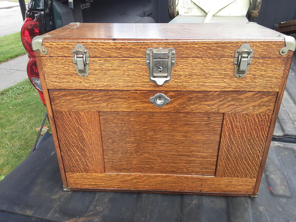

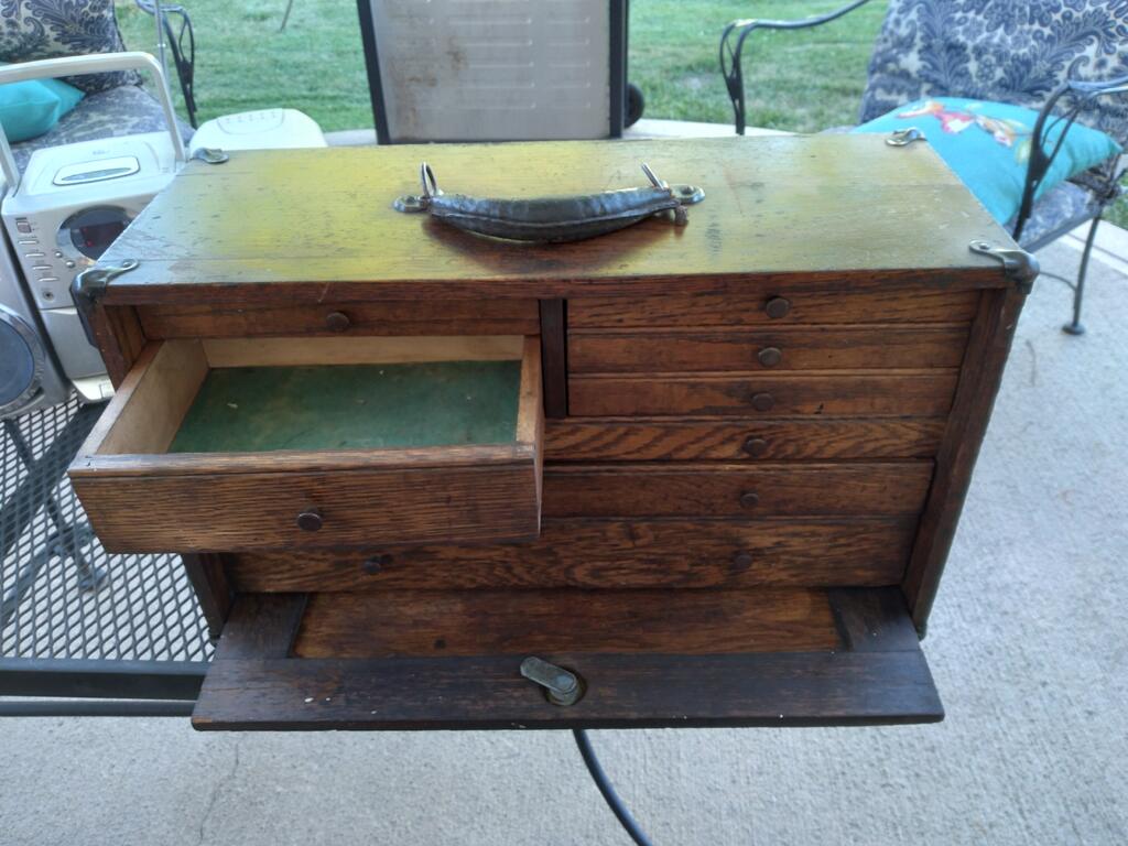

D_Mac 9,339 #13 Posted December 22, 2023 (edited) Love those old chests. I have had several of them. One on my dresser now that i keep my watches, pocket knives, and other things in. I have ordered keys, felt, and locks from Gerstner before. Now i get emailed to death by them. I dont mind because i like looking at there stuff. Did you stamp the drawers you made with the same number? Here are a few I have owned. Also have had several Kennedy's as well. Edited December 24, 2023 by D_Mac 1 Share this post Link to post Share on other sites
