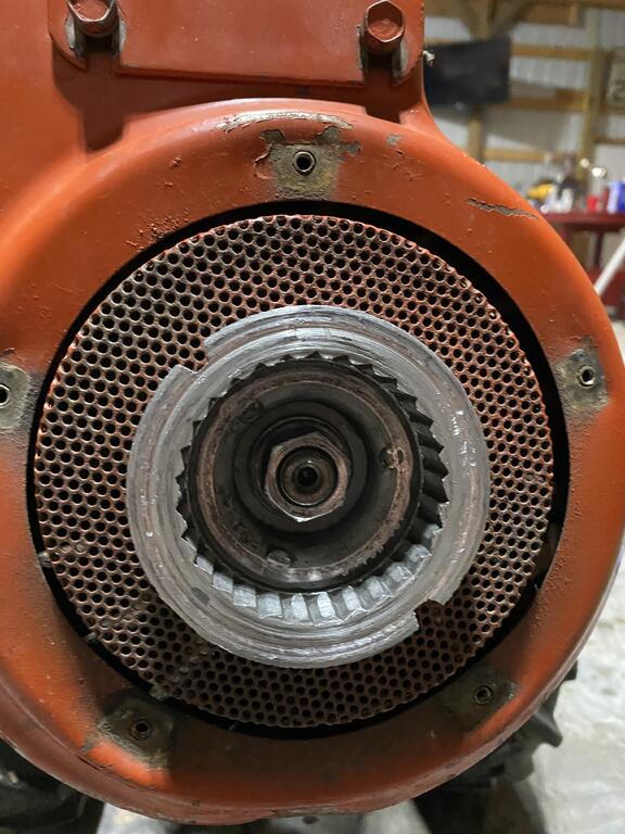

MikeDR 0 #1 Posted December 18, 2023 Hi Everyone, New to this Forum. I have a K161T SPEC 281271 on a Horse Tiller that I got back a few years ago, just starting the process of getting it up and running. The retractable pull start was pretty stiff, so i went through a rebuild which worked out great. The problem is that it looks like the cup attached to the flywheel was used for a while with the pawls only partially engaging, resulting in the gear/groves being stripped out in the cup. I've looked everywhere for a replacement, 1 found one on ebay for 200 bucks, which seems ridiculous. I thought that I'd start on here and see if anyone had an ideas to get this thing starting. Mike Share this post Link to post Share on other sites

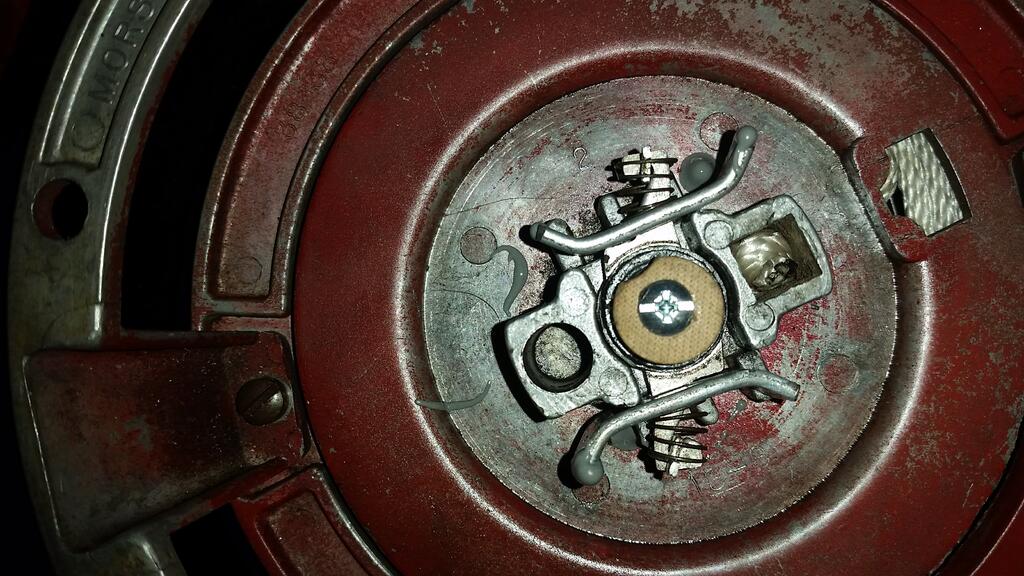

MikeDR 0 #6 Posted December 19, 2023 I’ll post over in the classified. I don’t see a part number on the back, but from my research it should be 41 071 08-S which superseded 41 071 02-S. Here’re some pics 1. Front of starter cup 2. back of starter cup 3. pull mechanism with pawls Share this post Link to post Share on other sites

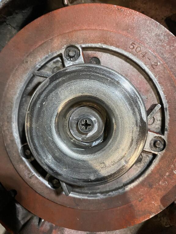

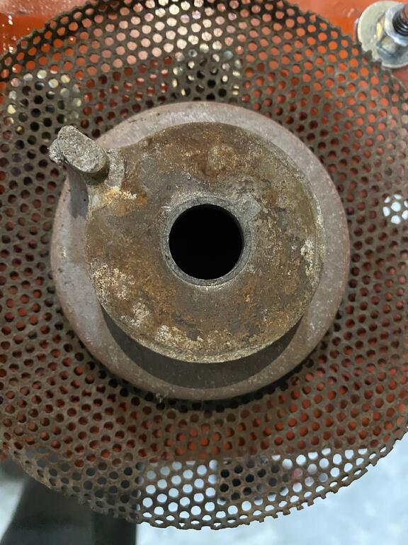

Racinbob 13,210 #8 Posted December 19, 2023 If I recall correctly the Tecky and Kohler cups were two different depths. I believe the Kohler was deeper. This shot doesn't show the depth but I can check once it gets light outside. Is this like yours? Share this post Link to post Share on other sites
squonk 48,207 #9 Posted December 19, 2023 I know I used a Tecky cup on a K141 Share this post Link to post Share on other sites

wallfish 20,652 #11 Posted December 19, 2023 20 hours ago, MikeDR said: Front of starter cup Maybe try using a file to get those flats the paws catch on a little deeper. It's already broke so nothing to loose while searching for a new cup 3 3 Share this post Link to post Share on other sites
Ed Kennell 47,554 #12 Posted December 19, 2023 1 hour ago, wallfish said: Maybe try using a file to get those flats the paws catch on a little deeper. And sharpen the rounded off pawls. 1 1 Share this post Link to post Share on other sites

MikeDR 0 #14 Posted December 20, 2023 15 hours ago, Racinbob said: If I recall correctly the Tecky and Kohler cups were two different depths. I believe the Kohler was deeper. This shot doesn't show the depth but I can check once it gets light outside. Is this like yours? It looks very close, 3/4 inch deep at the teeth and 1 1/2 inches at the center. Share this post Link to post Share on other sites
