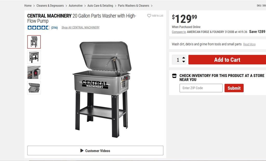

Achto 29,820 #2 Posted December 18, 2023 40 minutes ago, Just getting started said: What do you do to deal with this ? I have one of these. I use mineral spirits in mine with no issues. Been in use for at least 4yrs now. https://www.harborfreight.com/20-gallon-parts-washer-with-high-flow-pump-58679.html 6 Share this post Link to post Share on other sites

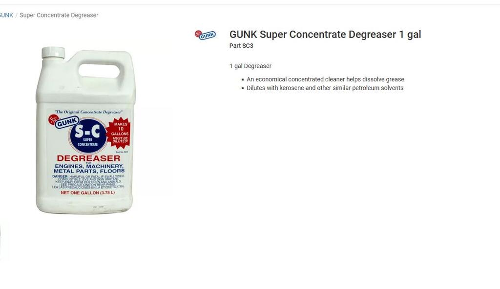

pfrederi 18,970 #3 Posted December 18, 2023 I have had one of these cheap washers for many years I use the SC gunk and kerosene 3 Share this post Link to post Share on other sites
Just getting started 22 #4 Posted December 18, 2023 8 minutes ago, Achto said: I have one of these. I use mineral spirits in mine with no issues. Been in use for at least 4yrs now. https://www.harborfreight.com/20-gallon-parts-washer-with-high-flow-pump-58679.html That is good news, I like using mineral spirits for cleaning a lot of things. And it's fairly reasonable. Thanks. 4 Share this post Link to post Share on other sites

953 nut 62,162 #7 Posted December 19, 2023 I have the same HF parts washer as @pfrederi and @Achto but I use the parts cleaning solution from Tractor Supply. It works great and you don't have to put up with the mineral sperits odor. https://www.tractorsupply.com/tsc/product/crown-psc-1000-parts-cleaner-5-gal 4 Share this post Link to post Share on other sites

pfrederi 18,970 #9 Posted December 19, 2023 I have tried it as a spray on but the Gunk Kerosene works better for me. 1 Share this post Link to post Share on other sites
