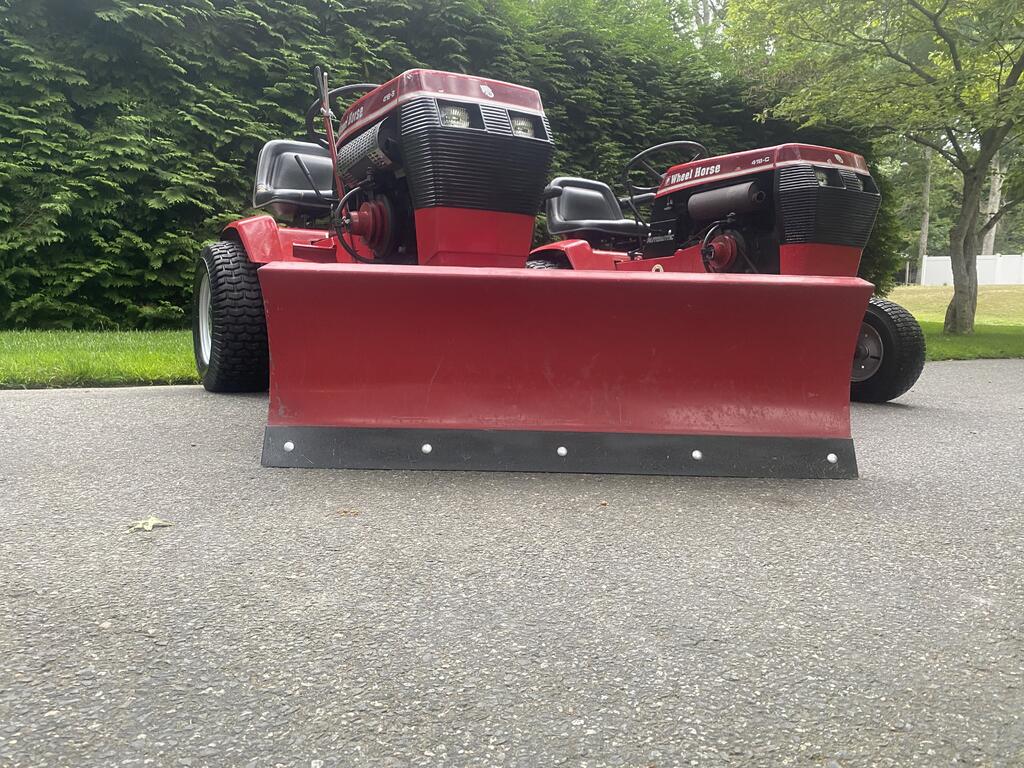

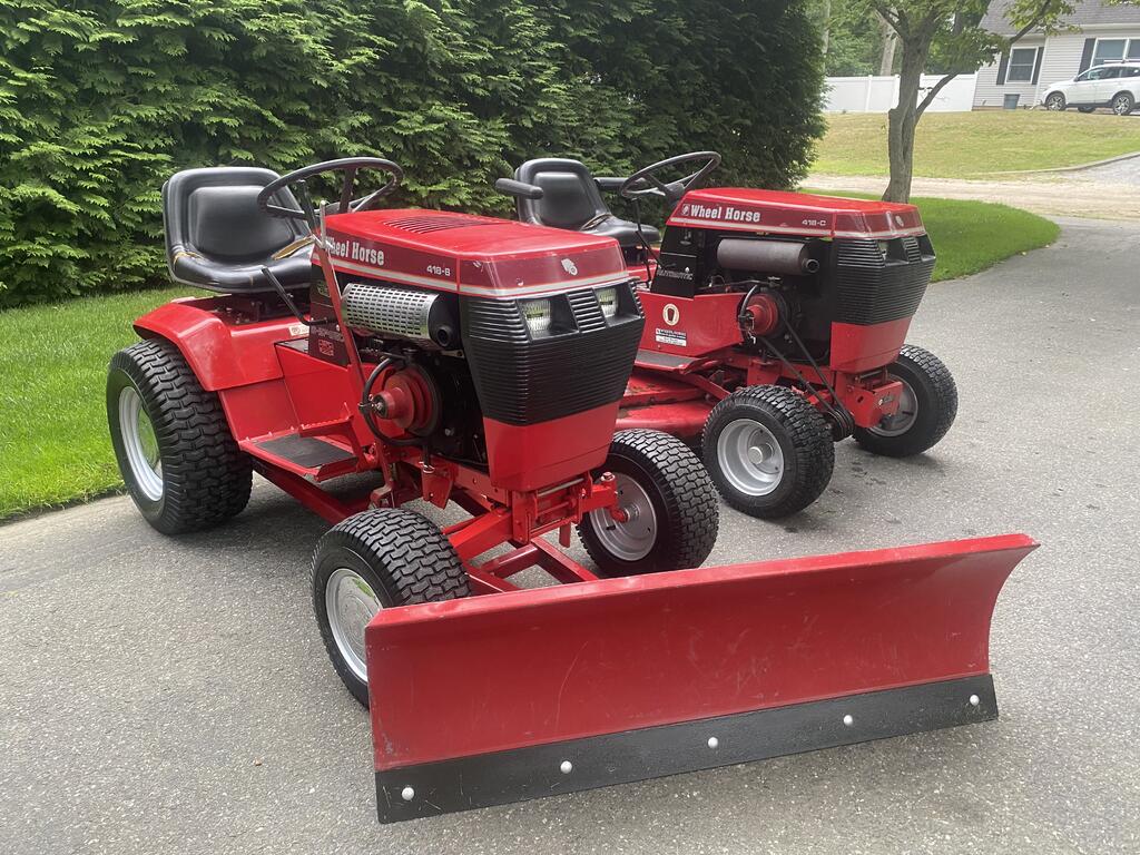

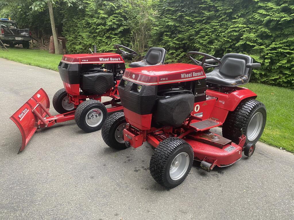

c-series don 12,363 #1 Posted December 16, 2023 Hello gents, I am looking for your opinions on this. I am wondering if I should switch my plow to the 418-C for the snow? Since I purchased the 8-Speed I really haven’t used it much other than to roll the lawn, so that’s kinda why I want to use it to plow. It has electric lift so I wouldn’t be lifting the plow manually. I’ve never plowed with an 8-Speed tractor, a 13 Speed truck yes but not an 8-Speed tractor 😂. I know the C is one of the fastest Wheel Horses ever built and that can be an advantage when plowing snow. What do you think? 5 Share this post Link to post Share on other sites

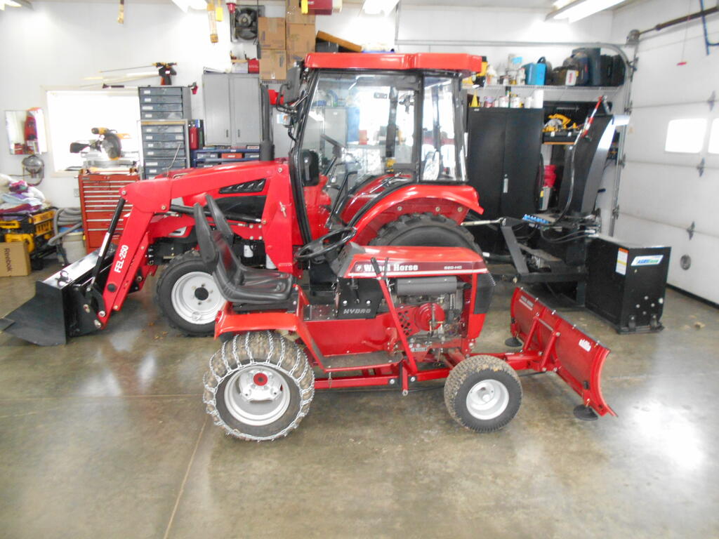

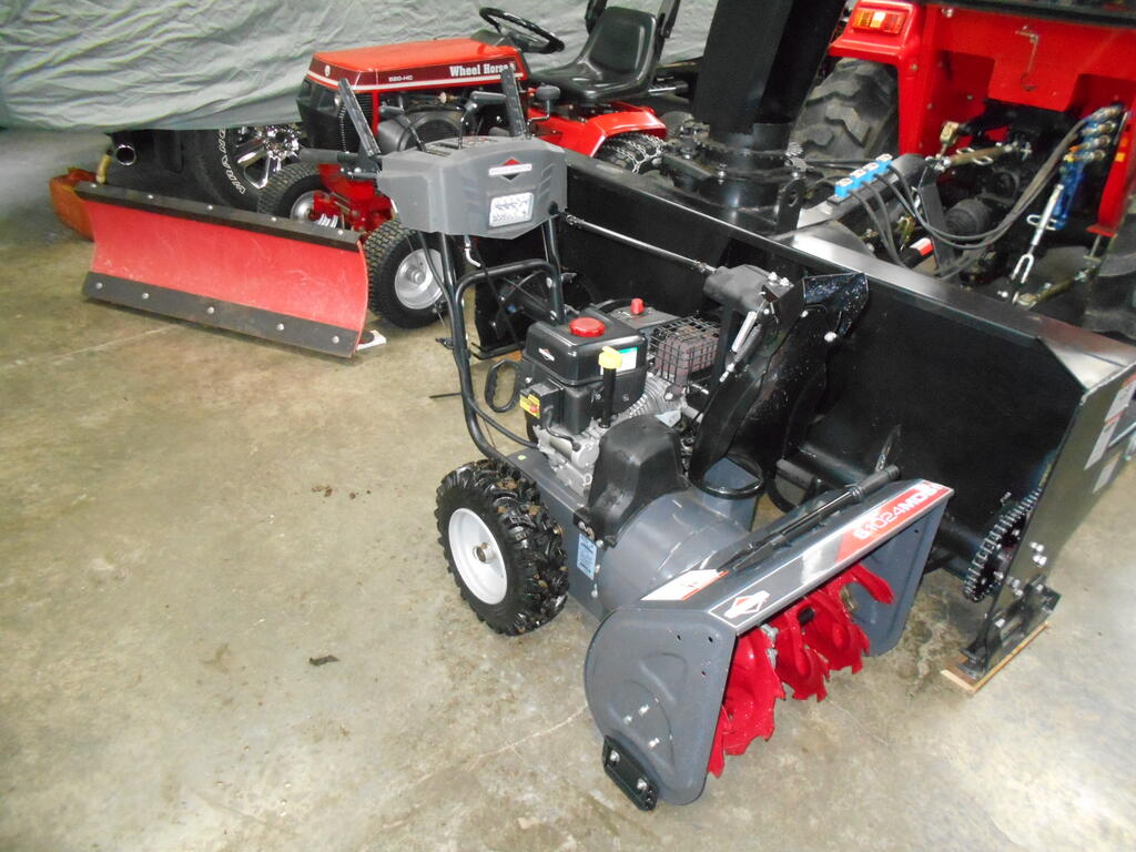

cleat 9,227 #12 Posted December 18, 2023 (edited) My snow team for this winter. 520HC with foot control and plow. Dongfeng 304G with 60" loader and 72" 2 stage blower with hydraulic chute rotation and deflection. Tractor has no chains but it has fluid filled industrial tires and 4 wheel drive and has great traction. Dongfeng is manual but it has a shuttle shift. Walk behind blower is a little briggs and stratton 1024 I picked up this past summer and have not used yet. My plan is to use it to clear walkways and interlocking stone areas. Edited December 18, 2023 by cleat 4 Share this post Link to post Share on other sites

Handy Don 17,316 #14 Posted December 18, 2023 7 hours ago, cleat said: Walk behind blower is a little briggs and stratton 1024 I’ve picked up two of these abandoned at the curb. Ebay carb, fuel line, filter, lube, plug and done. They do a good job. Gave them both away though one recipient insisted on at least paying for the parts--Ok. Both still in regular use. 2 1 Share this post Link to post Share on other sites
