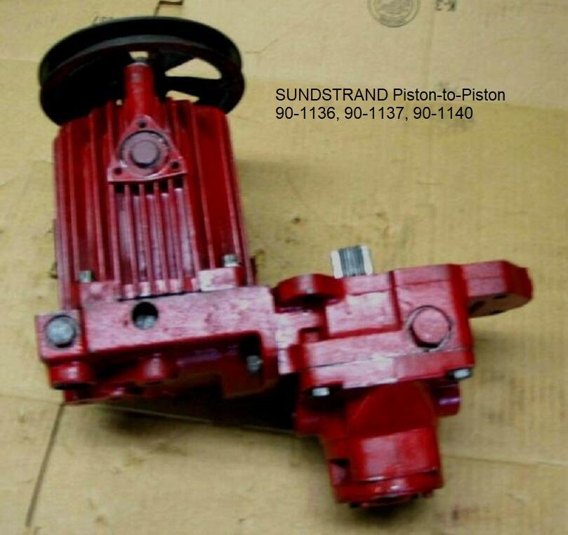

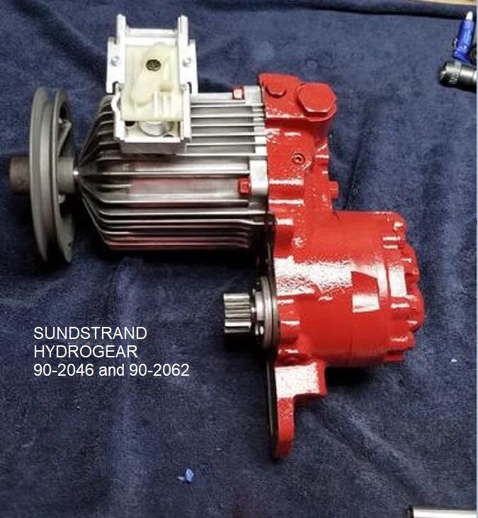

daveoman1966 3,882 #9 Posted December 15, 2023 (edited) There are TWO types of Sundstrand Hydros. 1) Sundstrand Hydrogear (models 90-2046 & 90-2062) and 2) Sundstrand piston-to-piston (*models 90-1136, 90-1137, 90-1140). Hydrogears were used on older models like Charger, Bronco 14, or the GT-14. Later models starting is about 1973 are for 'B' and 'C' series Autos i.e., B-100, C-120, C-160 etc. In either case, I have prepared a FREE download repair manual with photos and narrative of how to do the rebuild. It is NOT difficult to do. Rebuild files are here too... SUNDSTRAND PUMP & MOTOR Parts list.pdfSUNDSTRAND HYDROGEAR refurb.pdf Edited December 15, 2023 by daveoman1966 files 1 1 Share this post Link to post Share on other sites
