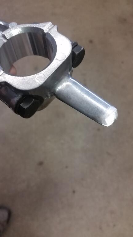

WHX?? 57,461 #4 Posted December 13, 2023 (edited) I would ask I Save if you can get his kit if you don't need the carb. I get my kits off flea bay too but in any case make double sure you order the correct size piston/rod. My 1055 241 with fleabay parts came out well. One thing for sure is don't forget to shorten the dipper if you have a new rod. Edited December 13, 2023 by WHX?? 2 2 Share this post Link to post Share on other sites
Handy Don 16,961 #5 Posted December 13, 2023 52 minutes ago, WHX?? said: One thing for sure is don't forget to shorten the dipper if you have a new rod. 2 Share this post Link to post Share on other sites
WHX?? 57,461 #6 Posted December 13, 2023 1 hour ago, Handy Don said: Whoops... Dang near did. Just getting ready to torque when whoa... Just bob to close to the original and a quick manicure. Hole in rod towards the cam. 11 hours ago, 1mor Project said: got a recommendation for a good machine shop Care to share? Always interested in a shop that will mess with our motors. 1 Share this post Link to post Share on other sites

Sailman 1,307 #9 Posted December 14, 2023 On 12/13/2023 at 8:33 AM, WHX?? said: One thing for sure is don't forget to shorten the dipper if you have a new rod. Please elaborate for us novices....Might be tackling my K161 in the future. 1 Share this post Link to post Share on other sites
953 nut 67,468 #10 Posted December 14, 2023 20 minutes ago, Sailman said: Please elaborate for us novices....Might be tackling my K161 in the future. Not all crankcases are created equally. The crankcase on an industrial engine will be deeper and the dipper on that rod is longer so you need to be sure your replacement rod's dipper is the same length as old one. Same holds true for the K-241-AS used on the 1055 etc where the short crankcase is used, rod is the same as the taller K-241-A so the kits have the longer dipper and it needs to be shortened up. 2 1 Share this post Link to post Share on other sites
WHX?? 57,461 #11 Posted December 15, 2023 (edited) Not the crankcase Richard it's the pan. I'm sure you having a brain fart. Blocks are the same just the shorter base pan they used to stuff a big block in a short frame. No fear @Sailman ... not applicable to small blocks. Excellent pinned thread in engines on identifying pan styles. Edited December 15, 2023 by WHX?? 1 1 Share this post Link to post Share on other sites
953 nut 67,468 #12 Posted December 15, 2023 10 hours ago, WHX?? said: Richard it's the pan. I'm sure you having a brain fart. Blocks are the same just the shorter base pan they used to stuff a big block in a short frame. Not quite the same, the blocks and oil pans are not interchangeable between the small base and large base Kohlers. I guess an adapter plate could be made to work. 2 Share this post Link to post Share on other sites
