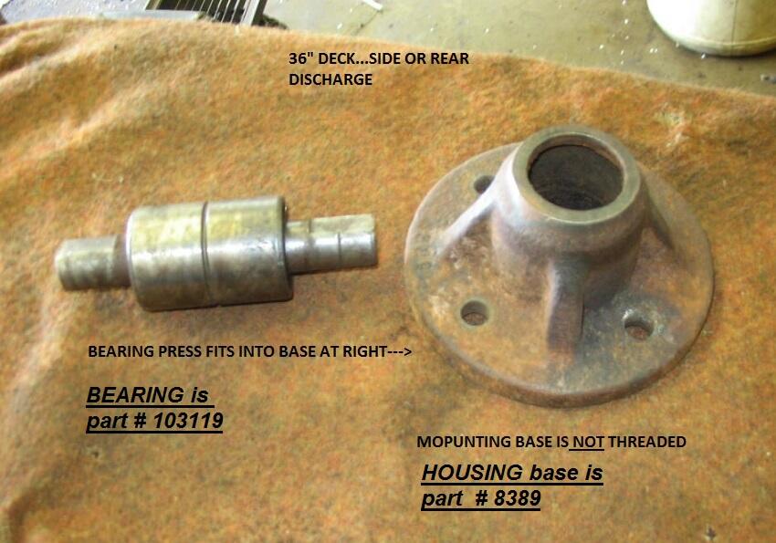

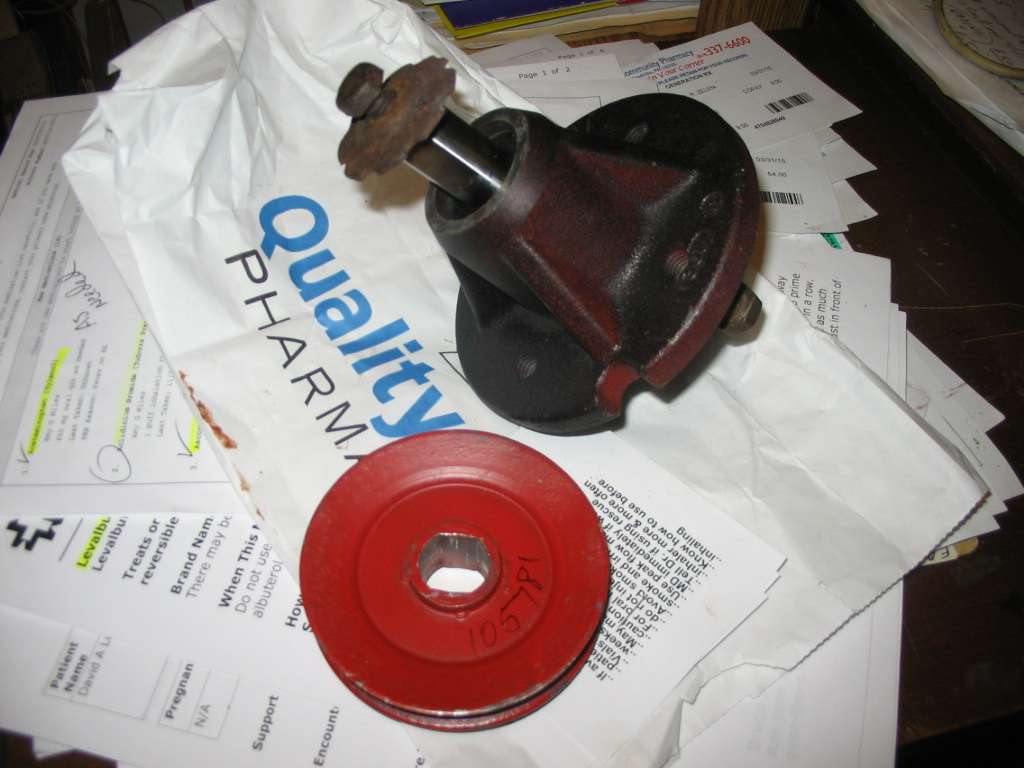

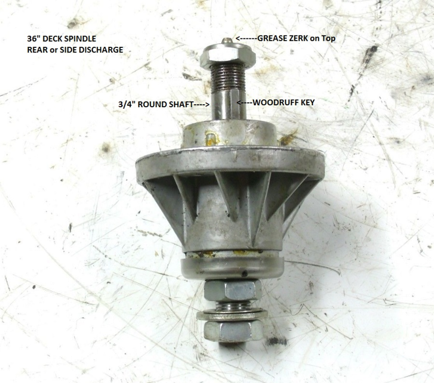

daveoman1966 3,884 #26 Posted December 12, 2023 (edited) As for the 36" deck...side or rear disch. I'd urge you to NOT acquire an old one (pre 72) that has the 'Double-D' spindle/pulley configuration....spindle looks like the SECOND pic here...with the RED 'DD' pulley. This style of spindle is NOT greaseable....no GREASE ZERK on top of the shaft. Try to find one that uses a spindle/pulley WITH the top grease zerk....looks like the FIRST pic here. There is a more recent variation on this FIRST pic...this 2nd style does NOT use the woodruff key....the spindle shaft is only 5/8 dia...but I don't have a pic of it. NOTE THE 4-hole bolt-mounting pattern is the same on all 3 of these styles. Edited December 12, 2023 by daveoman1966 Share this post Link to post Share on other sites

Handy Don 17,312 #28 Posted December 13, 2023 (edited) 1 hour ago, Brad Schroder said: Did the picture I sent look like the correct deck at least? I'll get the details on the spindle zerk. Could greaseable spindles replace the older ones? Yes, that is a 36” RD 3-blade deck. Yes, getting clear close-up images of the tops of the spindles will help. Yes, greasables can easily replace non-greaseable, but the replacements must include replacement pulleys, since the spindle shafts are different. When checking out a used deck, things to look at include: - greaseable spindles - freely spinning spindles without wobble or grinding (removing the belt that connects the three spindles, if at all possible, make this a LOT easier) - straight, clean pulleys (looking for trueness when they turn and no rust in the sheave) - integrity of the shell, especially looking for heavily rusted areas or penetrations (especially in places hidden by grass clumps), or big dents, or cracks at the frame mounts - integrity of the frame and gauge wheels (uneven wear, bends) It's hard to find a defect free deck, and you may be willing to cure some defects--just know what you are getting! Edited December 13, 2023 by Handy Don Share this post Link to post Share on other sites

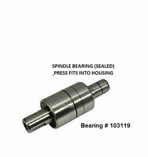

daveoman1966 3,884 #31 Posted December 13, 2023 8 hours ago, Brad Schroder said: That's a great detail to know, that little feature allows serviceability and long life. Did the picture I sent look like the correct deck at least? I'll get the details on the spindle zerk. Could greaseable spindles replace the older ones? Or drill, tap, and add a zerk? That does look like the right style deck. The older ones with "Double-D" configuration (for 36" deck) can't be greased...and you can't drill/tap a zerk for them either. The 'Bearing Assembly' # 103119 can only be replaced by driving it out and pressing a new one....for about $70 bux or so. The new one looks like this: With the more modern spindles, the top and bottom roller bearings can be individually replaced...not pricey eit her. 2 Share this post Link to post Share on other sites
