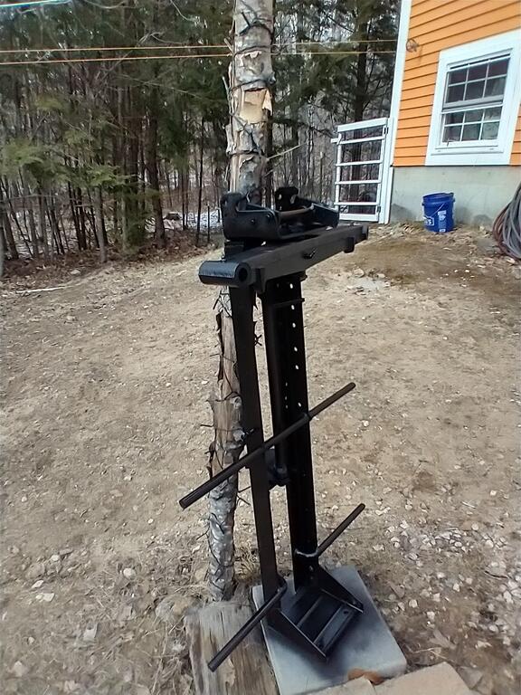

ebinmaine 80,713 #51 Posted March 22, 2024 The Power Washing Department got after the replacement frame today. Then a wash with acetone. Then some Rust-Oleum 2X Satin Canyon Black. 4 4 Share this post Link to post Share on other sites

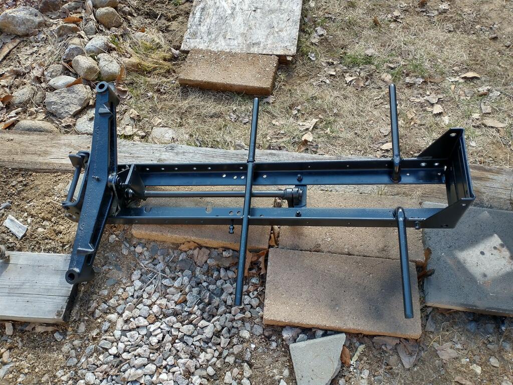

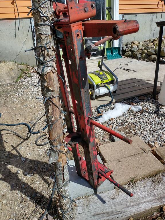

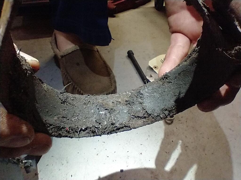

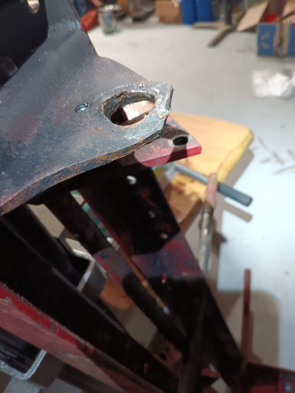

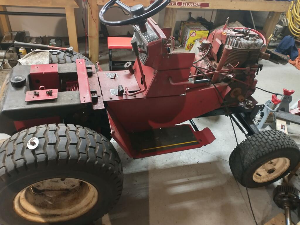

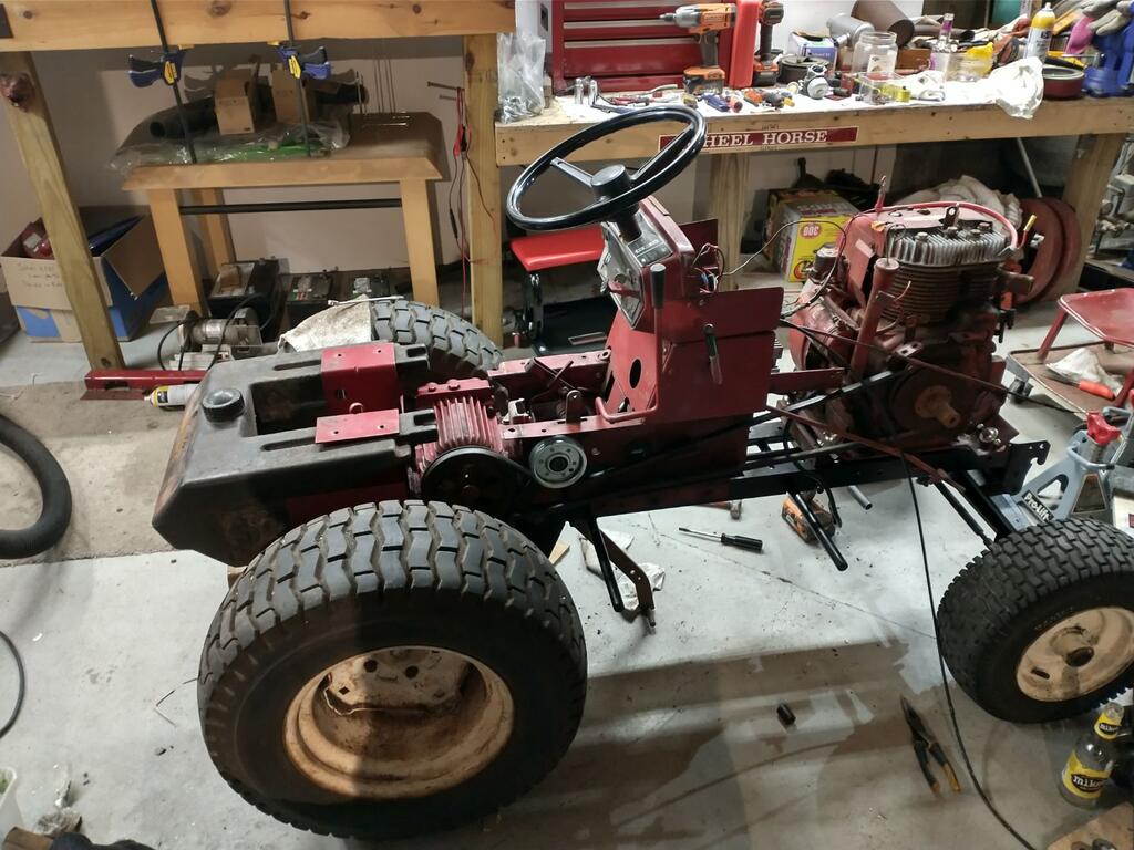

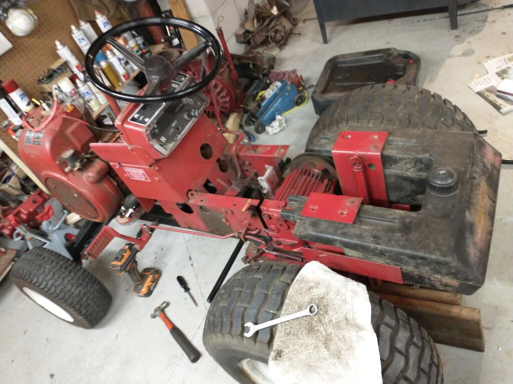

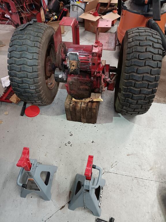

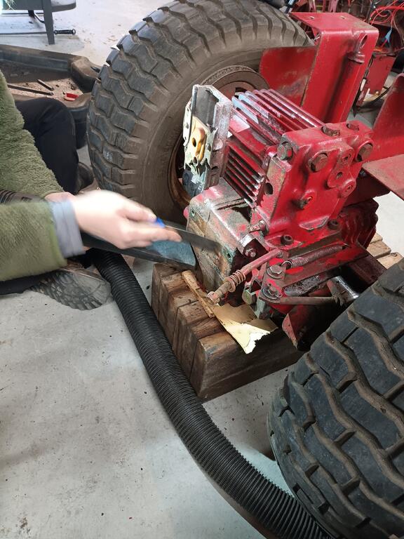

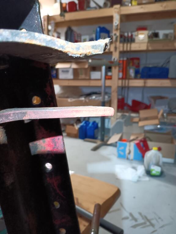

ebinmaine 80,713 #53 Posted March 23, 2024 We finished removing the steering tower, brake linkage and unbolted the frame. Here's the brake band we removed. More info here: These two pics show why I decided to replace the frame instead of attempting to repair. 5 Share this post Link to post Share on other sites
c-series don 12,447 #54 Posted March 23, 2024 Looks like now is a good time to make sure that the tow/push valve is working. Nice and easy to get to as it sits. 3 1 Share this post Link to post Share on other sites
ebinmaine 80,713 #55 Posted March 23, 2024 4 hours ago, c-series don said: Looks like now is a good time to make sure that the tow/push valve is working. Nice and easy to get to as it sits. Thanks for that reminder. I checked. Works good. 1 Share this post Link to post Share on other sites

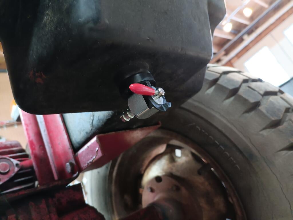

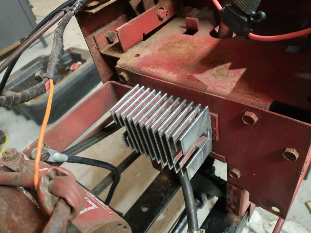

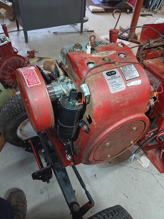

ebinmaine 80,713 #56 Posted March 23, 2024 We got the brake band situation figured out. Video below. The transmission is cleaned up and frame mounted. Trina noticed the old fuel tank grommet was seeping a tad. I put in a new Aircraft Spruce Company single 90⁰ lever valve and new grommet. Voltage Regulator is off to be cleaned up for better ground. Some minor setback on the engine being bolted in place. We swapped the Kerber solid mounts to the proper position. Used all 8 new grade 8 1/4" bolts but kept the 4 original Wheelhorse 3/8" grade 5 bolts in place through the center holes. Wrestled around screwing with lining up the bolts in all 3 positions. Finally got the whole setup where it needed to be. Then tightening THE VERY LAST @*^@$>/$ BOLT .... it snapped off in the cross mount. Well fine... I'll get another one outta our stock tomorrow after we clean up from today's snow storm. 4 1 Share this post Link to post Share on other sites

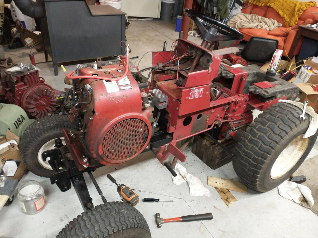

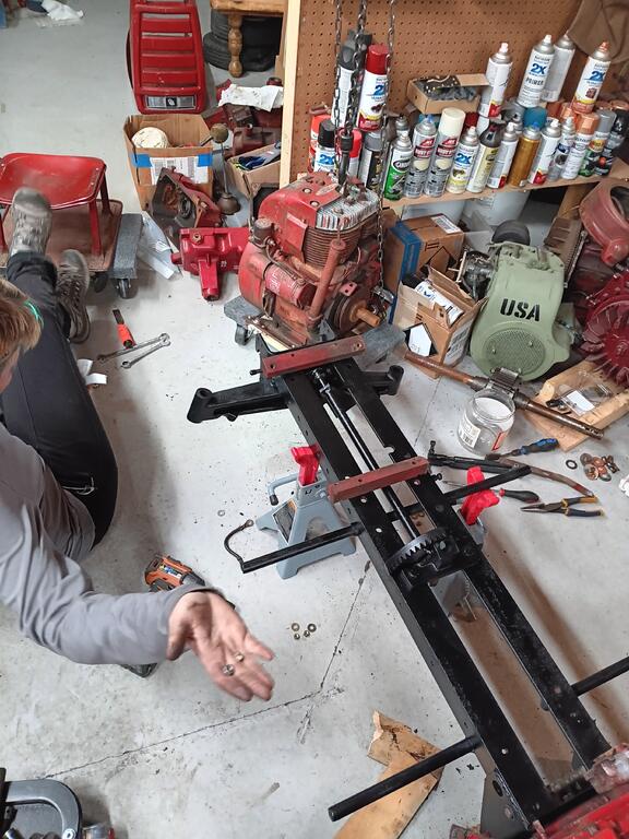

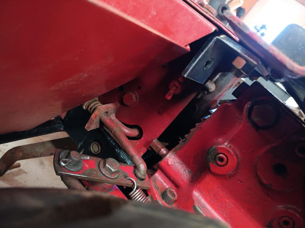

ebinmaine 80,713 #57 Posted March 25, 2024 Pretty good progress today especially considering we spent several hours doing snow cleanup. Swapped out the engine to frame bracket with the broken bolt. Got the engine all in and tightened down. Steering tower on and fastened. Brake linkage on and hopefully adjusted close. Even got the VR cleaned up some and put back. 2 4 Share this post Link to post Share on other sites

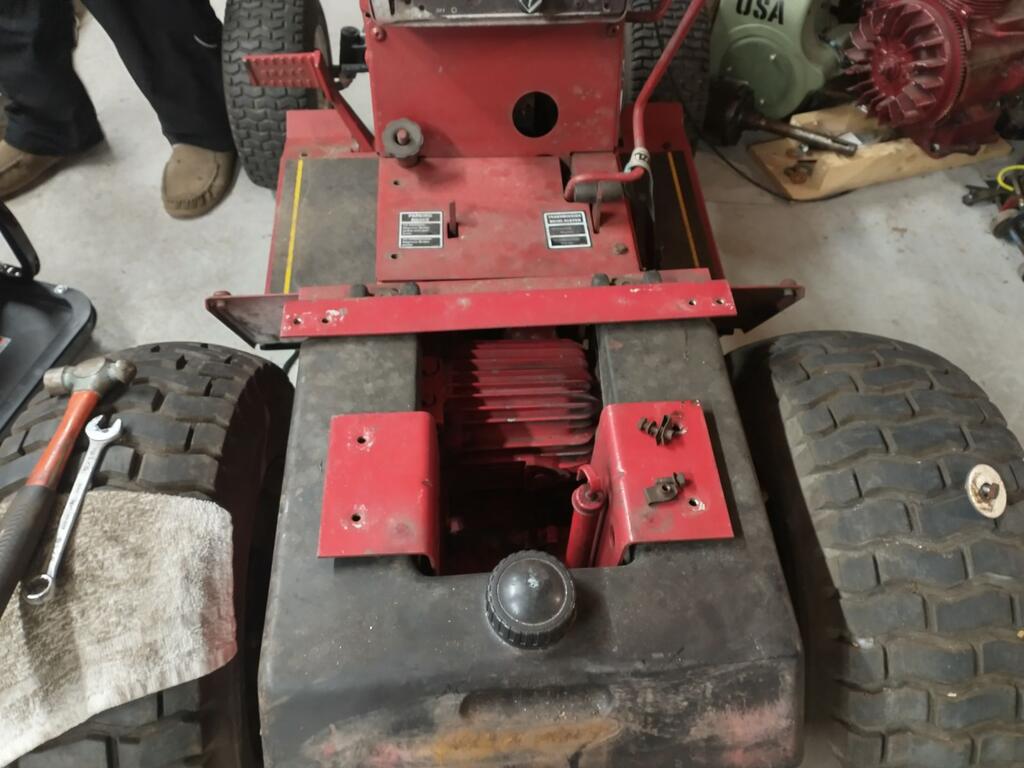

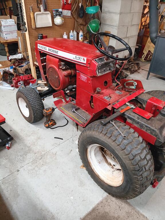

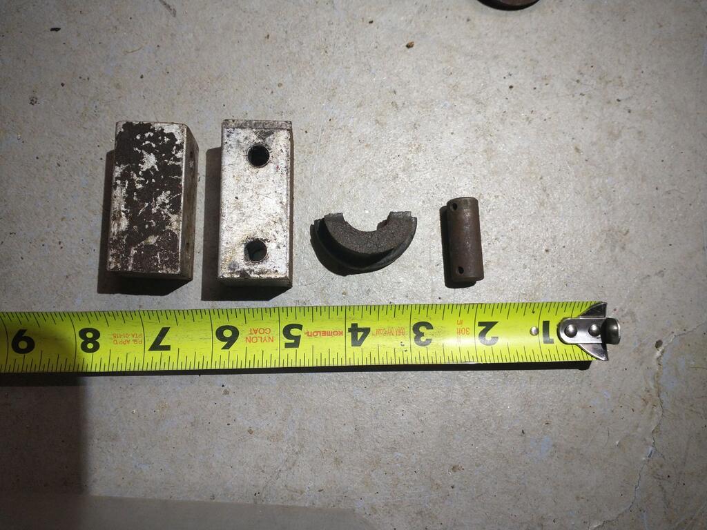

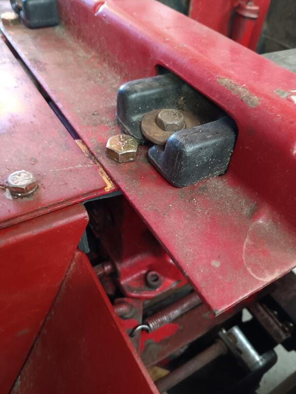

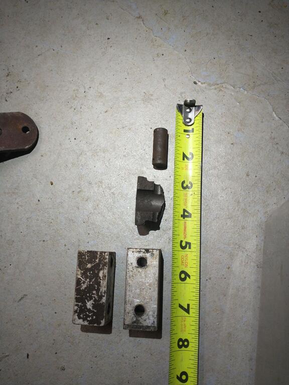

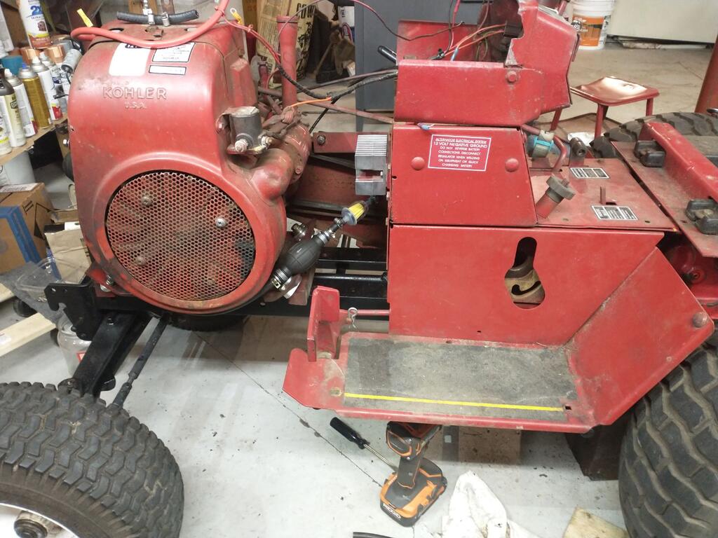

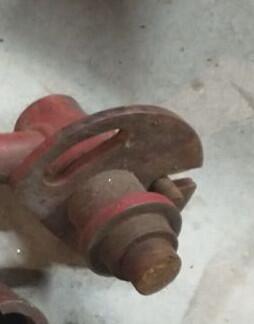

ebinmaine 80,713 #58 Posted March 27, 2024 This evening we installed the fuel tank, new "Low Permeation" fuel line, new filter. Also got the drive belt and spring on. The RH sheet metal is all bolted on. The LH sheet metal is just setting for the pics. I'll start a separate thread for this but can anyone tell me what these parts are? The broken circular piece especially? Also, we're in great need of this lift arm. I've started a classified. 1 2 Share this post Link to post Share on other sites

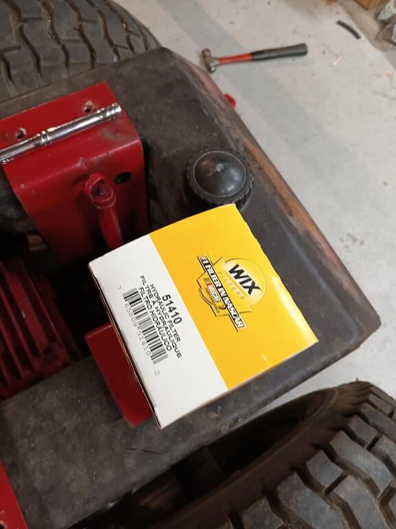

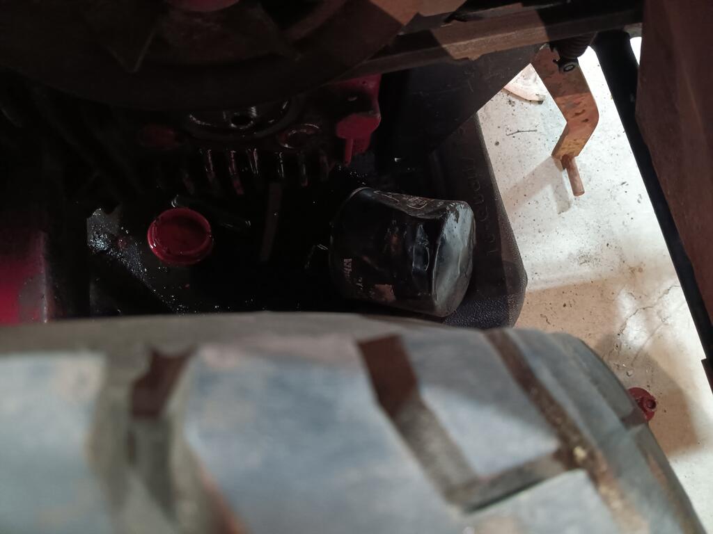

ebinmaine 80,713 #59 Posted March 29, 2024 A few more things done today. Engine oil added. Kinetix HD30. 1.5 qts. Dropped the transmission oil. Changed the filter. Test fit the hood. 5 1 Share this post Link to post Share on other sites

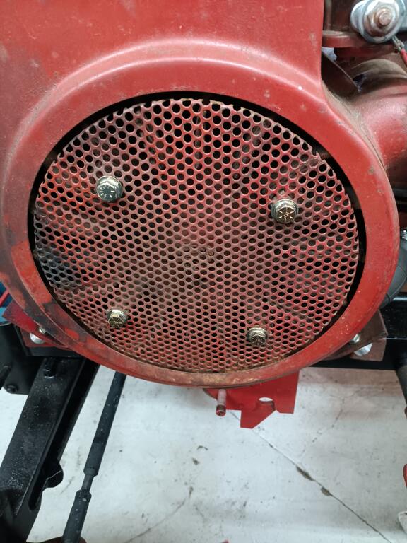

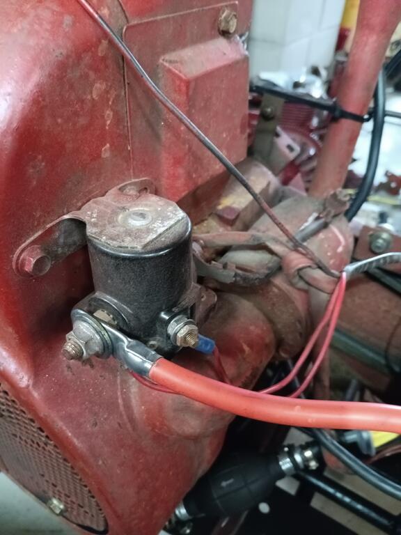

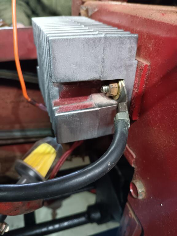

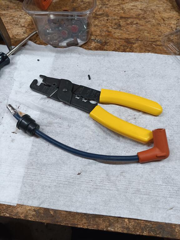

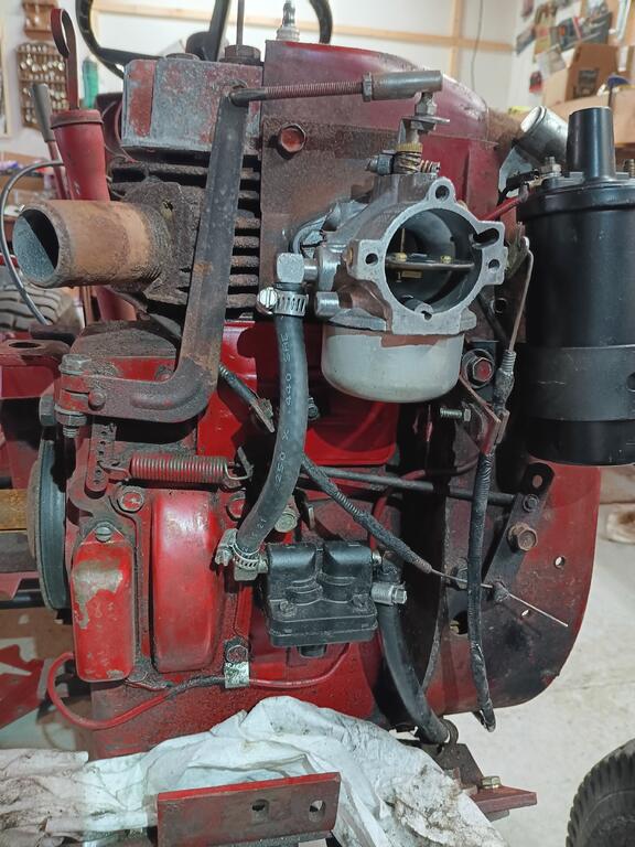

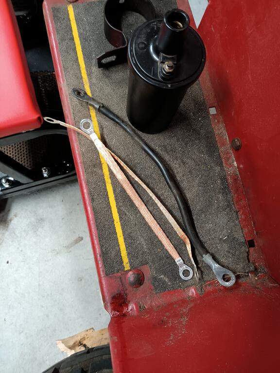

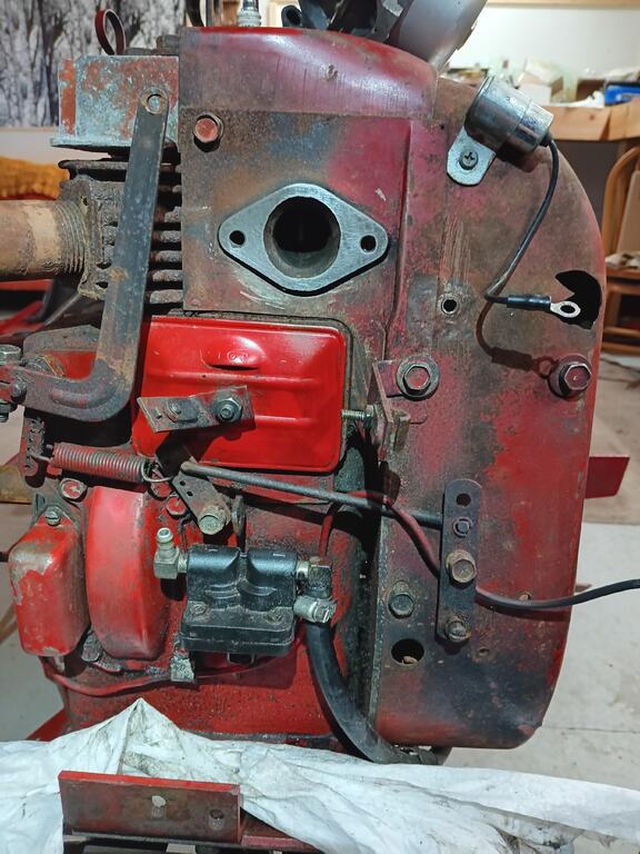

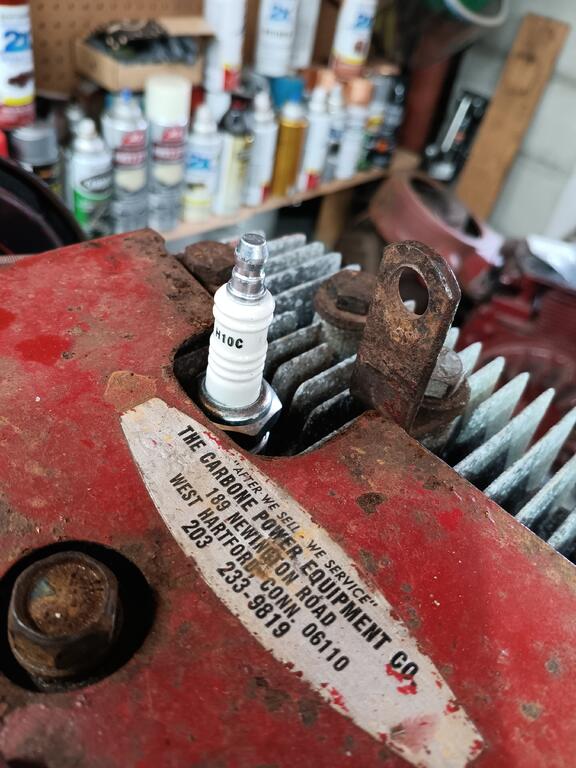

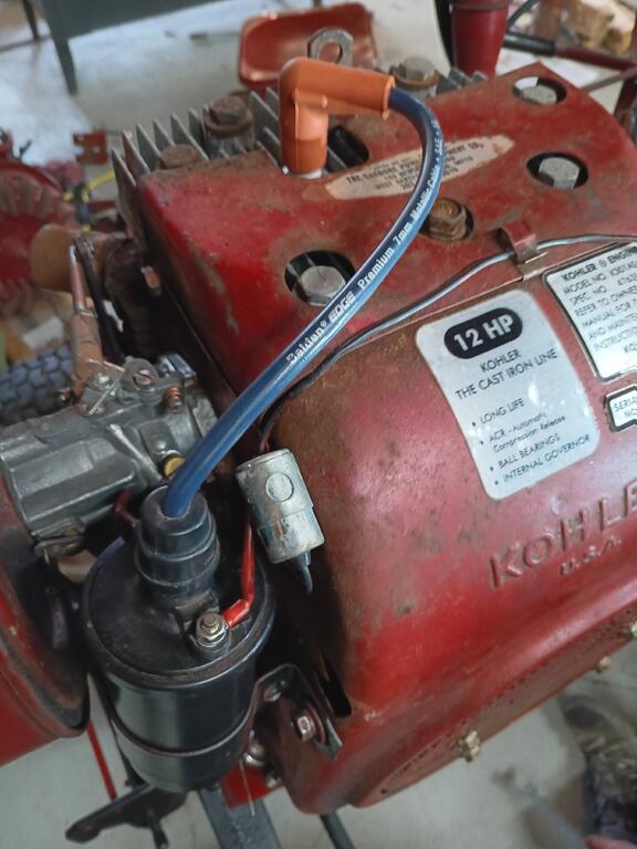

ebinmaine 80,713 #62 Posted March 29, 2024 Fair amount of small things checked of today. Coil on. Got out some ground straps. Cleaned up the engine Coil on. Carb and all linkage on. Used new screws with built-in lock washers to hold the air cleaner housing on All buttoned up New flywheel bolts with flat and lock washers New sparkable plug Ran a separate ground wire to the Voltage Regulator Cleaned up the solenoid terminals and installed the positive wires. Made a new sparkable plug wire from NOS Belden cable and Napa ends After her work was done for the day Trina got the Mid Hitch Tachamatic on. 1 5 Share this post Link to post Share on other sites

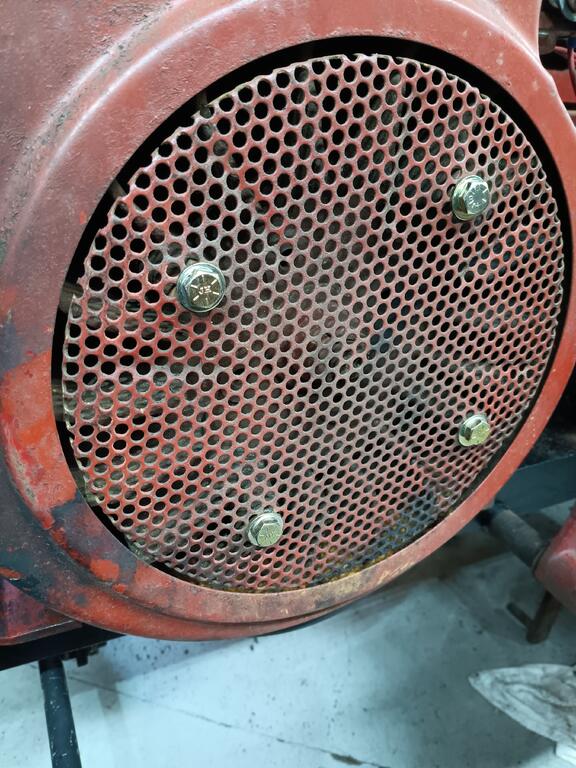

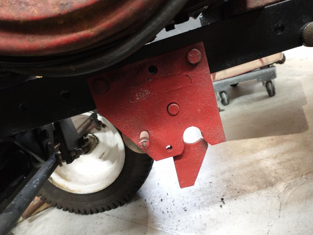

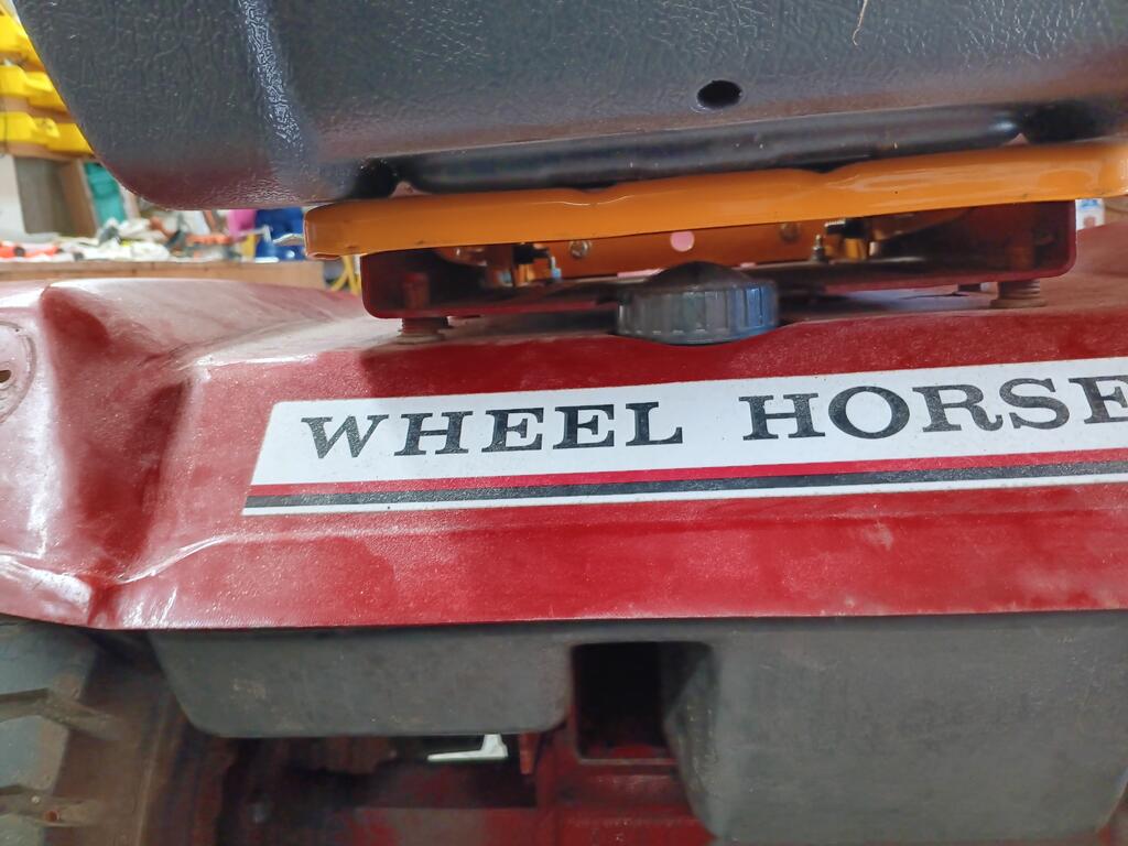

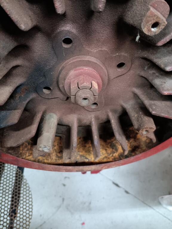

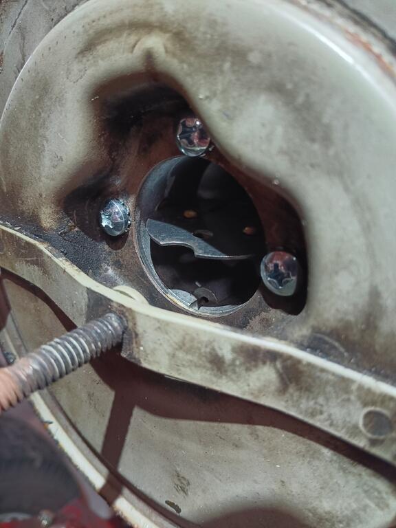

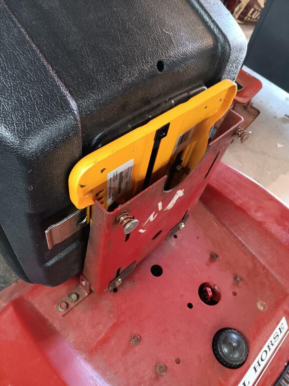

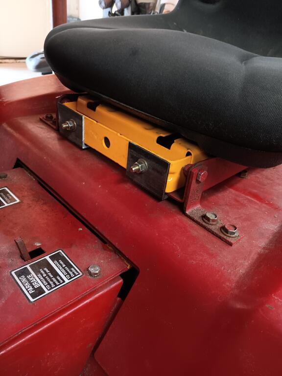

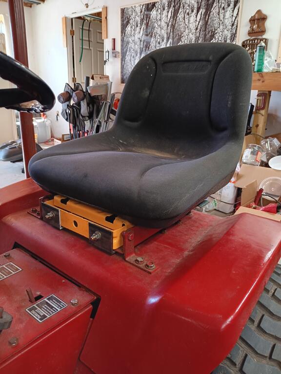

ebinmaine 80,713 #63 Posted March 31, 2024 Of course AFTER I installed the nice shiny new bolts in the flywheel screen I remembered that it needed to be vacuumed out. So I did that. That's back together. Again. Here's what I came up with for the standard issue broken/ cracked seat pan tabs. Those are 7/16 grade 8 bolts. Should give a good squeeze. 1 3 Share this post Link to post Share on other sites

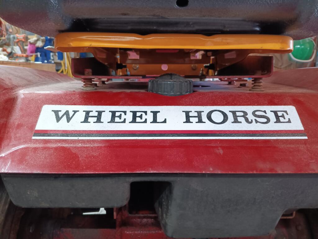

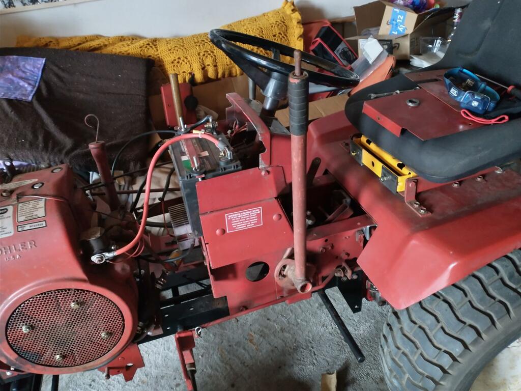

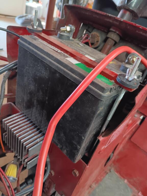

ebinmaine 80,713 #64 Posted March 31, 2024 Battery with custom hold down. We combined a parts bin Cub seat with its adjuster and the stock Wheelhorse seat brackets. Add an L in between and voila!! Rear springs compressed Springs resting 1 1 Share this post Link to post Share on other sites
SylvanLakeWH 32,521 #65 Posted March 31, 2024 Yellow... My eyes... can't see... Paint Department on strike? 2 Share this post Link to post Share on other sites

ebinmaine 80,713 #67 Posted March 31, 2024 1 hour ago, SylvanLakeWH said: Yellow... My eyes... can't see... Paint Department on strike? 1 hour ago, Tractorhead said: Second that Jim. Great progress at all so far Eric, but paint department have to do an gently „upgrade“job. 👍 No paint there for now folks. Maybe later.... Here's the almost finished result: 3 4 Share this post Link to post Share on other sites

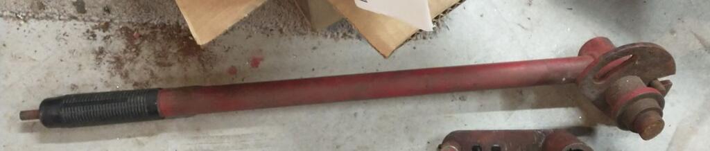

ebinmaine 80,713 #69 Posted April 7, 2024 Thanks again to @Ed Kennell for sending us a lift handle! Trina spent the time to remove obstructions and get it installed today. Last thing (known) to do is pop the mower deck on. 2 5 Share this post Link to post Share on other sites
