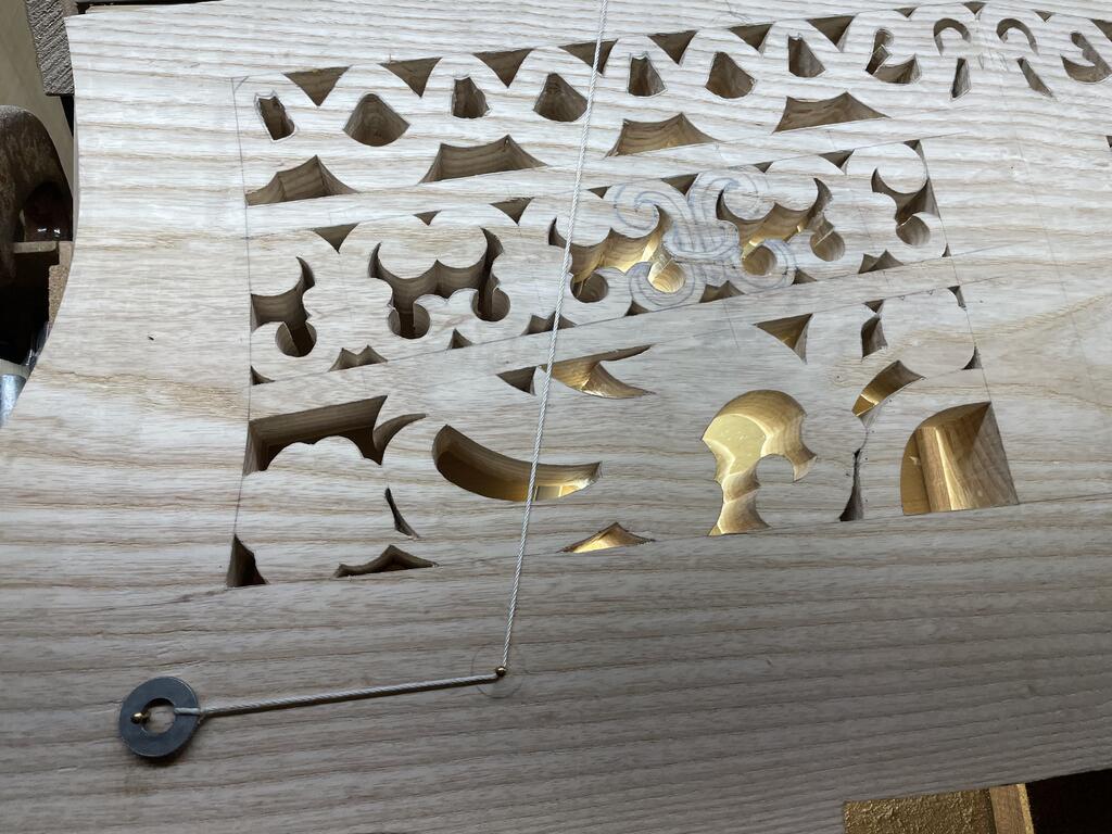

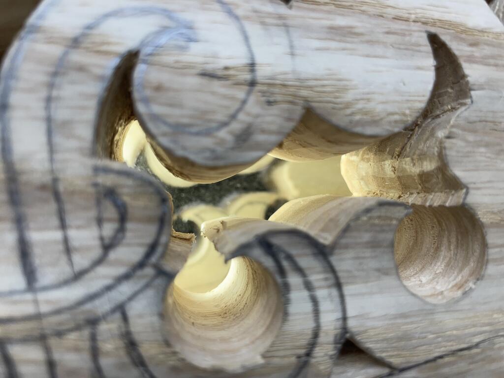

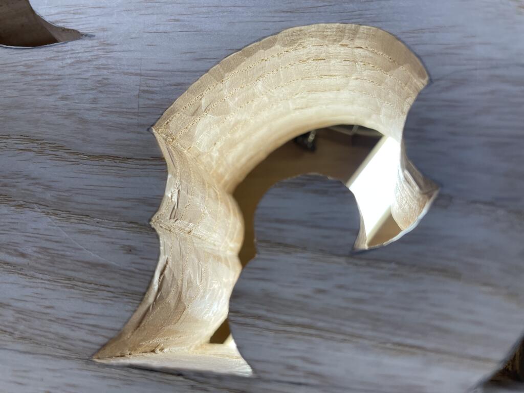

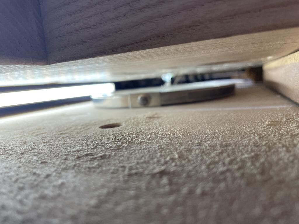

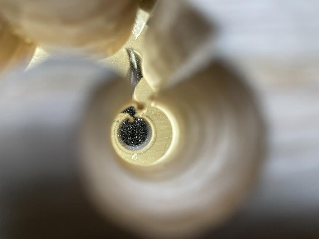

formariz 12,381 #1 Posted December 11, 2023 (edited) Literally the title of this thread but in a different manner and for a different purpose. No vehicles involved, just some very sharp tools. The carvings on these pierced yokes have to be worked from both front and back . Therefore during the piercing step specifically the cleanup, it is very important to stay true and accurate to the lines marked. That would involve tedious constant turning of yoke and looking at other side which would make it a nightmare of a job. Most times one doesn’t cut or pare all the way to the other side but is has to be watched closely specially if using the very small keyhole saw to make sure it is not going astray which would be catastrophic in this type of work. So to minimize or virtually eliminating all the turning of workpiece, I raise it on the carving table to allow a “ floating “ mirror and a light between it and the table. They can be moved as needed. Mirror is two sided one side magnifying subject. Another benefit of light is showing exactly the surface left by the carving tool by reflecting on its curved facets unlike the light emitted on the front of piece. That shows exactly the quality of the surface left allowing one to correct it if less than desirable. Light and mirror in between workpiece and table String allows mirror to be moved where needed Lines on opposite side clearly and easily seen Position of tool such as keyhole saw clearly seen on opposite side Tool marks and quality clearly seen due to backlighting. Areas needing correction are clearly visible Edited December 11, 2023 by formariz 8 6 3 Share this post Link to post Share on other sites
