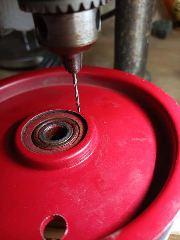

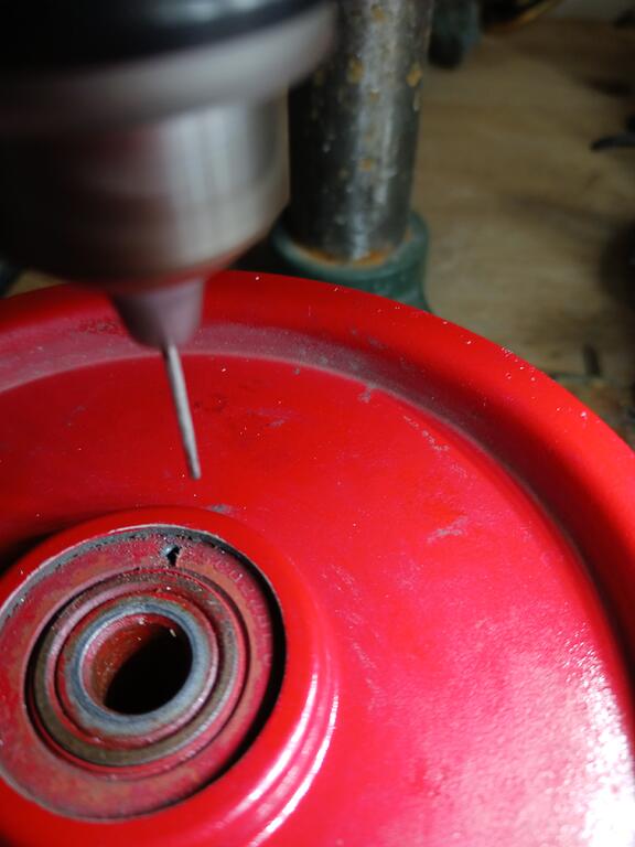

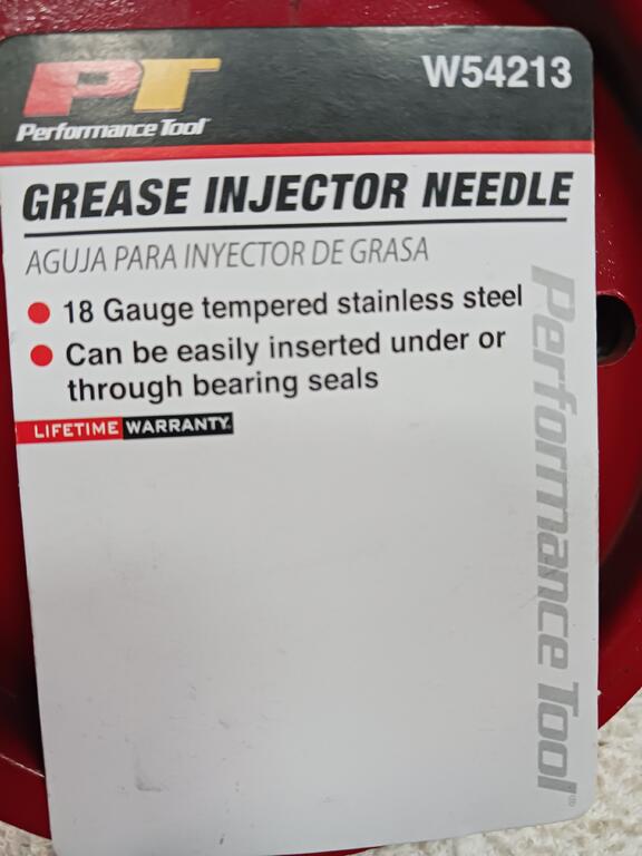

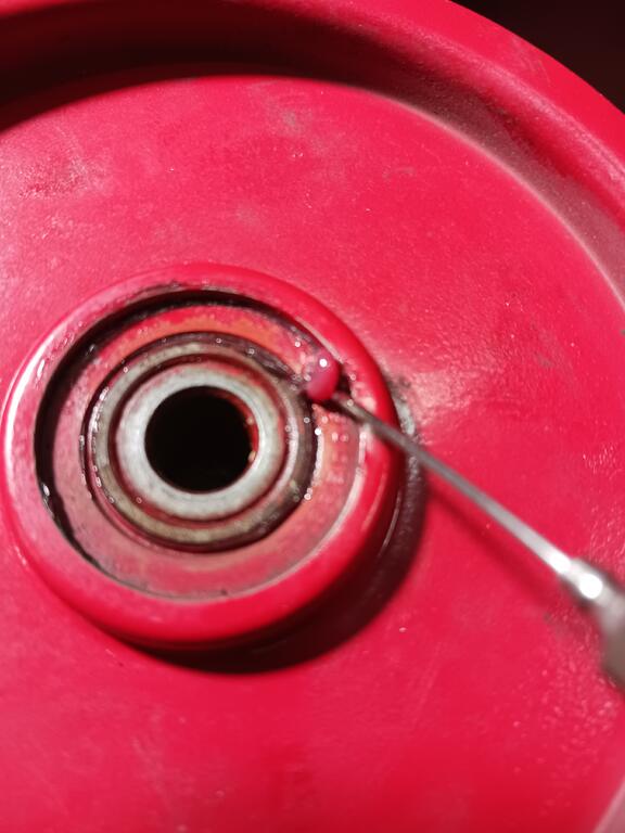

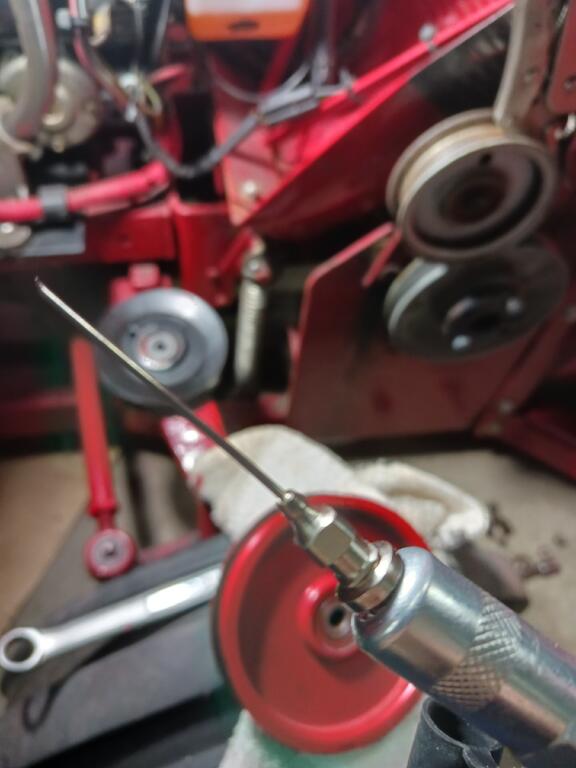

HorseFixer 2,015 #1 Posted December 9, 2023 (edited) After 10 years of use I decided to pull some major maintenance on the 520 Snow Chucker. This includes changing oil in the ONAN Engine in the HYDRO belts and Greasing and lubing all bearings an linkages. I ran into a situation with three Molded sealed bearings in the pulleys. Wheel Horse Nor TORO does not intend for these to be serviced just replaced. I looked at some YOUTUBE videos and a gent used a needle grease gun attachment to grease a rubber sealed bearing. This was found at AUTOZONE for $5.00 bucks. Well how about a metal sealed bearing? I decided to mic the needle then use a MICRO Drill & bit drill the bearing with a vacuum attachment set up to suck up any micro fine chips as not to get into the bearing. Once drilled I pumped the bearing full of grease. You can rotate the bearing and reinsert the needle adding more grease. I then used a Q TIP soaked in Lacquer thinner and cleaned the area with the drilled holes. I then mixed up some JB WELD and sealed the drilled hole back up. There are two of these pulleys on the SC Tall Shute 2 Stage Blower and one on the 520. This fix should last for another 20 years. As they say if there is a will there is a way. ~Duke Edited December 12, 2023 by HorseFixer 9 6 Share this post Link to post Share on other sites
ri702bill 12,802 #2 Posted December 9, 2023 Good info - let us know how it works after a couple of storms. I see the pattern of spot or resistance welds on the black pulley. Using a 1/8" bit those can be drilled out and the halves separated to allow access to the bearing for greasing or replacement. I use #5 button head screws and hexnuts for reassembly. Done this to four different 3" idler pulleys that were riveted. 7 Share this post Link to post Share on other sites

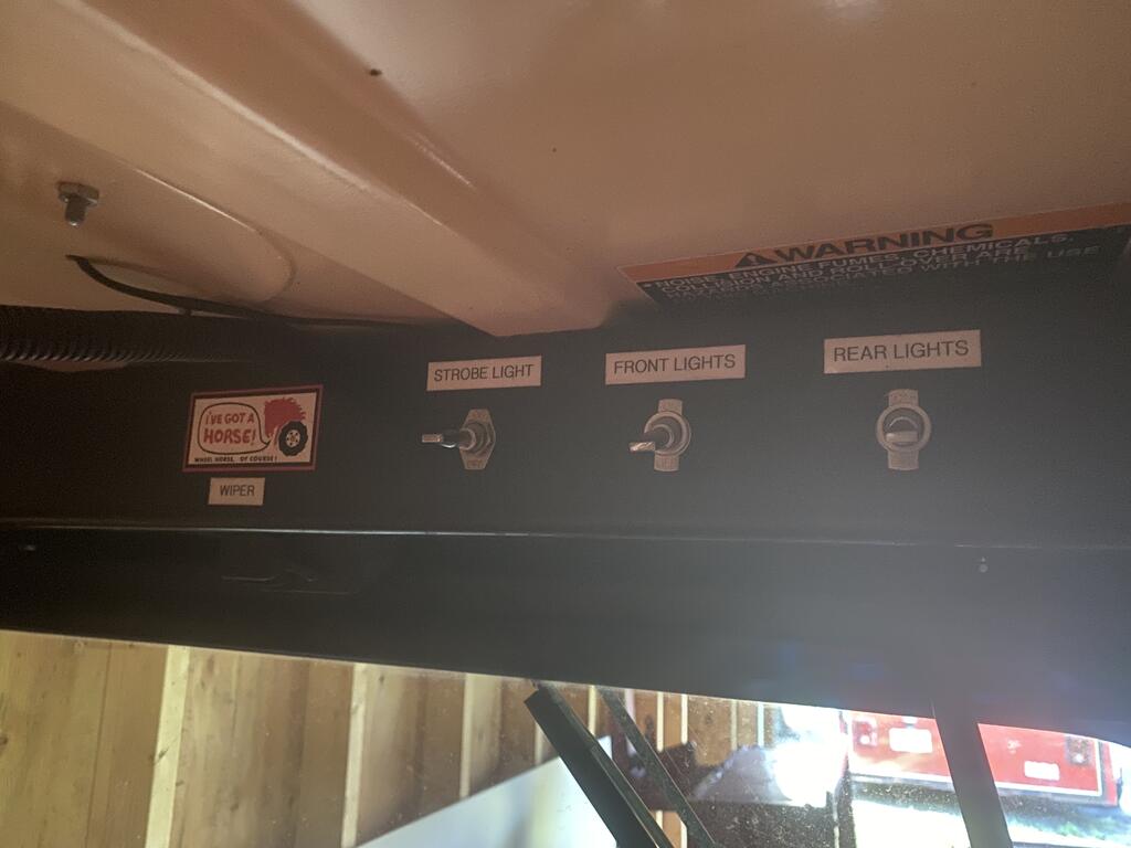

c-series don 12,361 #3 Posted December 9, 2023 (edited) @HorseFixer Good to hear from you again Duke ! I was wondering were you have been! I wanted to let you know that your snow chucker inspired me to get one of my own. A 417-A that I inherited, I found a two stage blower and then a cab. I absolutely love it! Added some extras like lights, heat and a wiper. Edited December 10, 2023 by c-series don 3 4 Share this post Link to post Share on other sites
peter lena 10,013 #4 Posted December 9, 2023 @HorseFixer on those pulleys , when ever needing one , always look around , for same type / size , but larger bearing , with wide pop off grease shields , then easy to insert a bushing to the larger bearing , for exact fit . also like the 550 flash point grease , virtually eliminates related rotational drag . as a base line to my PTO CLUTCH DRAG LEVEL , mule drive belt , moves with very little drag effort ,by hand , the less you have the better off you are , lever it in slower , immediate response , no screaming clutch , thats your goal , just my own set up , Pete Share this post Link to post Share on other sites
WHX?? 57,783 #5 Posted December 9, 2023 Good way to help preserve them but what if the bearing is already worn out or seized ? Bearings are designed to wear out. Maybe give this a shot. 1 1 Share this post Link to post Share on other sites
peter lena 10,013 #6 Posted December 9, 2023 @ WHX , replaced a number of original pulleys , key for me its same size with a larger bearing , and wide removable side shields , typically a same size pulley / type m has the tiny side shield , poor lubrication quality , cut a , size to size sleeve , from https://www.google.com/search?sca_esv=589398076&rlz=1C1CHBF_enUS866US866&sxsrf=AM9HkKlVwypfVWFwBF6lxvxzlVcr2lAZLg:1702136180102&q=3/8+x+1, typically a 5/8 ID bearing , press this into it , bolt on with a 3/8 bolt . if you paint it red , its hiding in plane site ! very easy fix , done a number of them , repack with Lucas green or marine grease , no noise , or roughness . regular stuff for me , pete 2 1 Share this post Link to post Share on other sites
peter lena 10,013 #7 Posted December 9, 2023 @ri702bill was just on line , looking up a similar repair site , guy roughed up seal , and also used a generic olive grease , missed opportunity ! think people don't see a smaller pulley as a big deal , throw anything at it , if at all . think that heat and lateral loading stress , just eats those bearings . since going overkill , on lube and detailing , no failures or noise . since most w/h pulleys are 3/8 ID , its easy to find a same size / type with a larger bearing , when installed it works , like a no effort function . bombproof , pete 1 Share this post Link to post Share on other sites

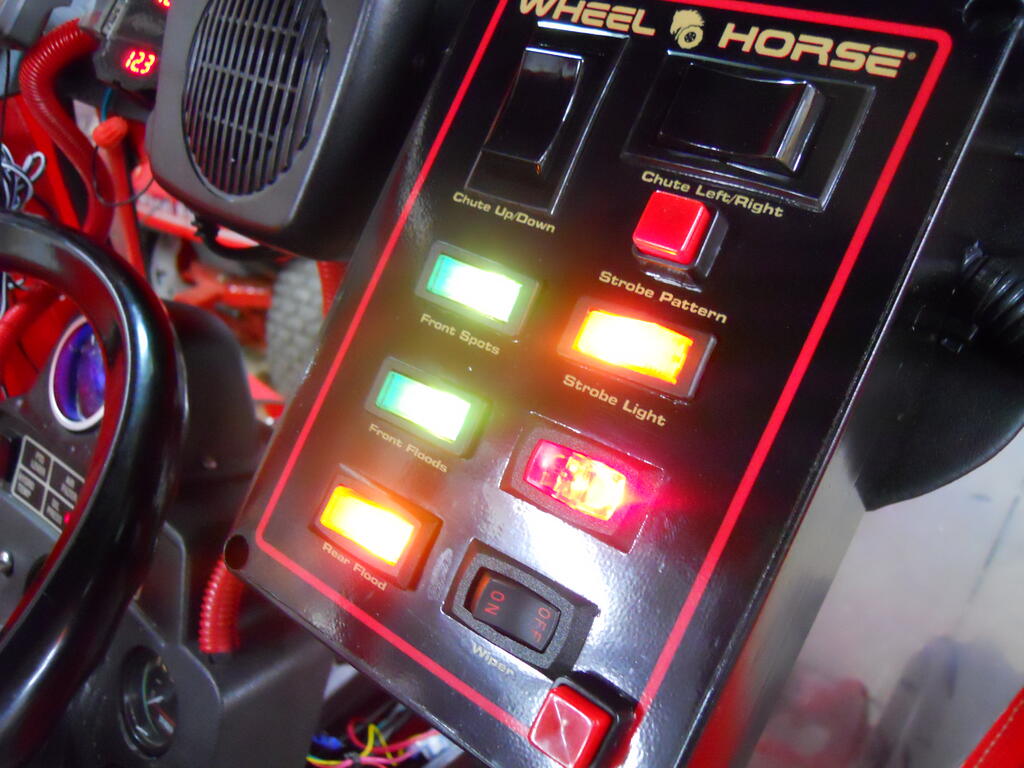

HorseFixer 2,015 #8 Posted December 10, 2023 (edited) On 12/9/2023 at 8:18 AM, c-series don said: @HorseFixer Good to hear from you again Duke ! I was wondering were you have been! I wanted to let you know that your snow chucker inspired me to get one of my own. A 417-A that I inherited, I found a two stage blower and then a cab. I absolutely love it! Added some extras like lights, heat and a wiper. Hi Don, nice tractor! But What no Motorized Chute? Stereo? Back Up Camera? Digital Oil Pressure Gauge? Defrost Heater? Windshield Washer? Lightbar and Strobes with multi pattern? Molded lead weights all rims and hubcaps? Edited December 12, 2023 by HorseFixer 2 1 Share this post Link to post Share on other sites
HorseFixer 2,015 #9 Posted December 10, 2023 11 hours ago, peter lena said: @HorseFixer on those pulleys , when ever needing one , always look around , for same type / size , but larger bearing , with wide pop off grease shields , then easy to insert a bushing to the larger bearing , for exact fit . also like the 550 flash point grease , virtually eliminates related rotational drag . as a base line to my PTO CLUTCH DRAG LEVEL , mule drive belt , moves with very little drag effort ,by hand , the less you have the better off you are , lever it in slower , immediate response , no screaming clutch , thats your goal , just my own set up , Pete Hey Pete you keep using that LUCAS Crap and you will buck up your engine! Remember we are talking SNOW CHUCKING Colder than COLD! 1 Share this post Link to post Share on other sites

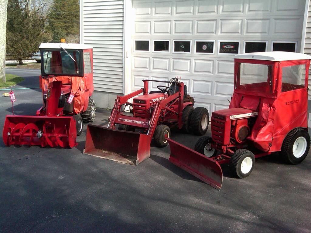

c-series don 12,361 #10 Posted December 10, 2023 (edited) @HorseFixer Jeez, looks like I’m really slackin! Here I thought I was doing something with switch set up I made! Guess I better step up my game! Funny thing is that I have an F-350 powerstroke diesel with an 8’ Fisher plow that I use for my snowplowing business but when I get home from plowing I use one of my Wheel Horses to take care of my driveway. Here’s a pictures from a few years ago. Edited December 10, 2023 by c-series don 1 1 Share this post Link to post Share on other sites
peter lena 10,013 #12 Posted December 10, 2023 @HorseFixer, thank you so much for the kind words , actually have a very good set up , use RISLONE ZINC ,https://www.amazon.com/Rislone-4405-Supplement-Concentrate-Treatment/dp/B0075559UY/ref=asc_df_B0075559UY/? in all my oils . have not had a bearing fail , or get noisy / rough since going over to , lucas crap . all my attachments , move with ease from the drive belt start . like a 5-30 Castrol , in cold weather , quick start , oil weight change over is minimal , that zinc is in all my engines , been plowing snow / blowing snow 40 + years . get right after any issue , usually eliminate it , anything I suggest , has a lot of run time on it . have a very happy day , stay oily / greasy , pete 2 Share this post Link to post Share on other sites

HorseFixer 2,015 #18 Posted December 15, 2023 I have been thinking about the way some have drilled the spotwelds and added bolts to fasten the pulley half's back together once the bearing is replaced. The spot welds just heat the metal in the pulleys together to join them . The spot welds are most likely have no exact spacing nor do they need to be where the welds are placed, therefor when drilled to be split apart if not done exactly could cause the pulley to be out of balance/ when adding the bolts to join the pulley half's back together are all the bolts and nuts the exact same weight? are they being checked on a gram scale? the pulley is part of the mechanial drive and all parts need to be balanced for optimum operation. Share this post Link to post Share on other sites
Lee1977 7,750 #19 Posted December 16, 2023 (edited) I have been running bolted together Idlers for years and haven't had a problem. I don't think there is enough difference between those bolts and nut to make any difference. Those idlers are stamped not machined I would think they are not that well balanced new. Edited December 16, 2023 by Lee1977 Share this post Link to post Share on other sites
HorseFixer 2,015 #20 Posted December 16, 2023 3 hours ago, Lee1977 said: I have been running bolted together Idlers for years and haven't had a problem. I don't think there is enough difference between those bolts and nut to make any difference. Those idlers are stamped not machined I would think they are not that well balanced new. I asked Chandler who was a Wheel Horse Dealer Right next door to the Wheel Horse Garage in the 40's he showed me pulleys that had holes drilled in them for balancing? I wouldn't think it would matter either but one never knows! Share this post Link to post Share on other sites
