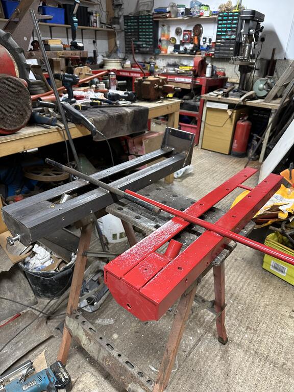

meadowfield 3,210 #1 Posted December 7, 2023 (edited) Hi all, I know hoods change, front axles goes cast and trans goes to 2 piece... (probably more things) a few questions if someone can help? Does the frame stay the same from RJ-58 to Suburban 400 - whats the wheelbase? Frame changes on 551 to accommodate the 2 piece trans, does wheelbase stay the same? planning another project that I may or may not finish reminder of things I have finished: http://wheel-horse.co.uk/images/C4/c4_a.jpg http://www.wheel-horse.co.uk/images/Bendy/bendy1.jpg no promises though! Edited December 7, 2023 by meadowfield 3 1 Share this post Link to post Share on other sites

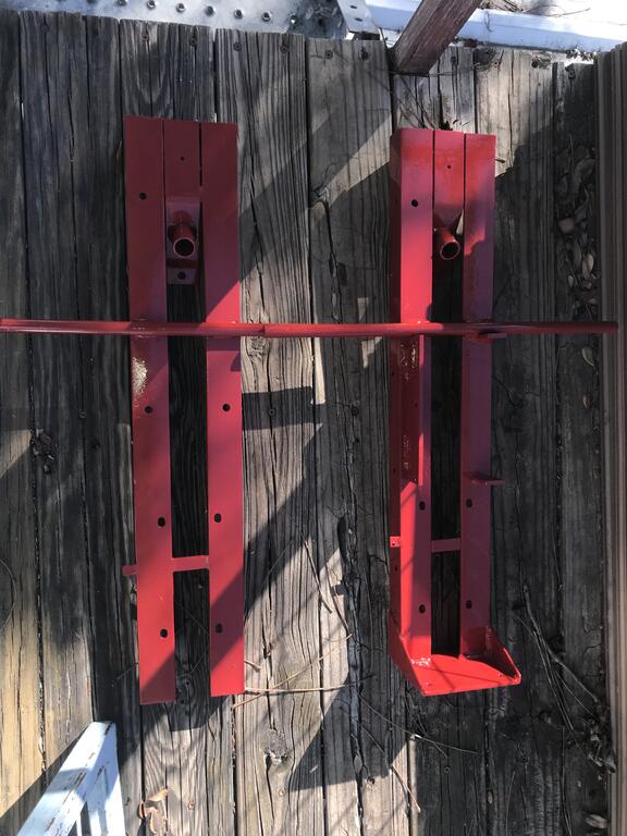

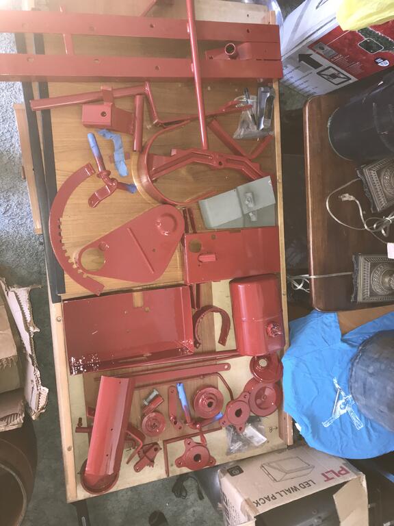

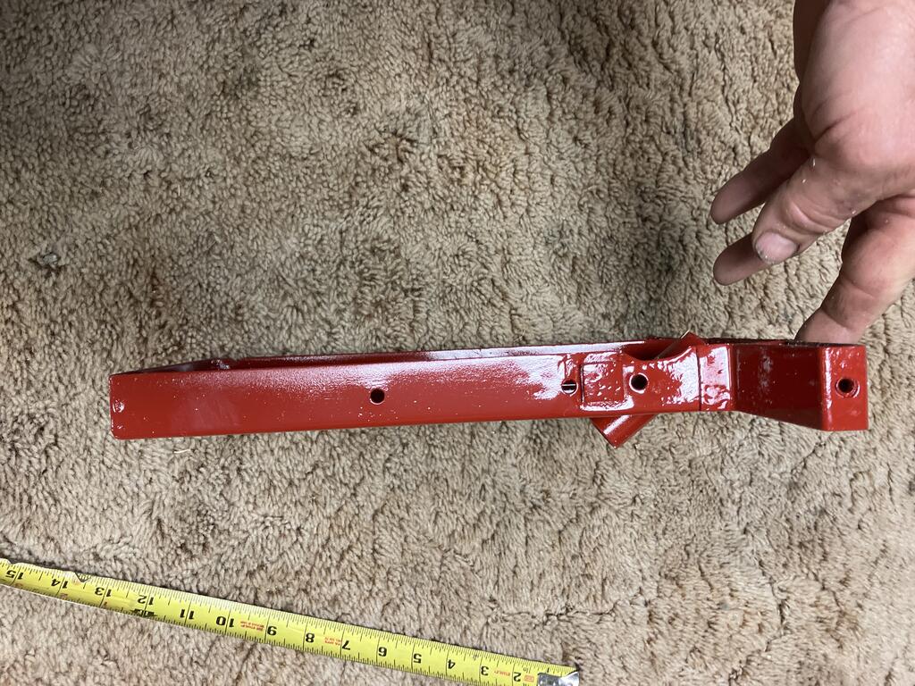

oliver2-44 11,847 #6 Posted January 11, 2024 (edited) Here’s a picture of a Suburban 400 and 551 frame side by side. They both measure 32-1/2”. I can get you any more details if needed Here’s all the parts to assemble a 400 except the hood and transaxle Edited January 11, 2024 by oliver2-44 3 Share this post Link to post Share on other sites
meadowfield 3,210 #7 Posted January 12, 2024 21 hours ago, oliver2-44 said: Here’s a picture of a Suburban 400 and 551 frame side by side. They both measure 32-1/2”. I can get you any more details if needed Here’s all the parts to assemble a 400 except the hood and transaxle super helpful, have you any more pictures of the 551 frame? in particular the gearbox mount and a side view and the hood mounting. thanks 1 Share this post Link to post Share on other sites

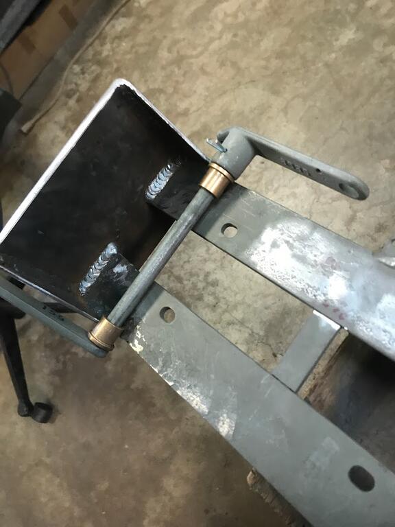

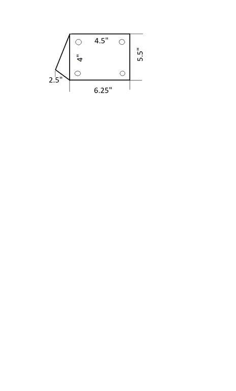

oliver2-44 11,847 #8 Posted January 13, 2024 I made a new transmission attachment plate fro my 551 frame based on this drawing I found on Red Square. I made one change which was to make the 2.5" bottom angle dimension 2.75" and the top of that angle have a .250 flat section. If I had to do over I would make it 3" with a .500 flat at the top The original design did not have bushing on the clutch rod, but I'm adding them to compensate for wear on the clutch rod at the narrow angle side area. With the original dimension of 2.5" the (unshown) hole for the clutch idler rod is very close to the edge. I will get a dimension on the clutch rod hole in the next day or so. The back plate is 1/4" and the sides are 1/8" The original frame design did not have these bushing on the clutch rod. I'm adding them to compensate for a worn area on the clutch rod where it went through the thin frame side angle 7 Share this post Link to post Share on other sites
sjoemie himself 3,283 #9 Posted January 13, 2024 15 hours ago, oliver2-44 said: That is some proper reinforcement and very clean welds. Excellent work! 2 Share this post Link to post Share on other sites
oliver2-44 11,847 #10 Posted January 14, 2024 22 hours ago, sjoemie himself said: That is some proper reinforcement and very clean welds. Excellent work! My welder nephew gets the credit, mine dont look like that. 2 1 2 Share this post Link to post Share on other sites

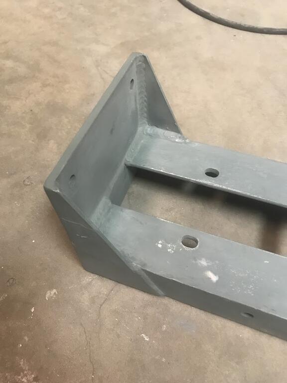

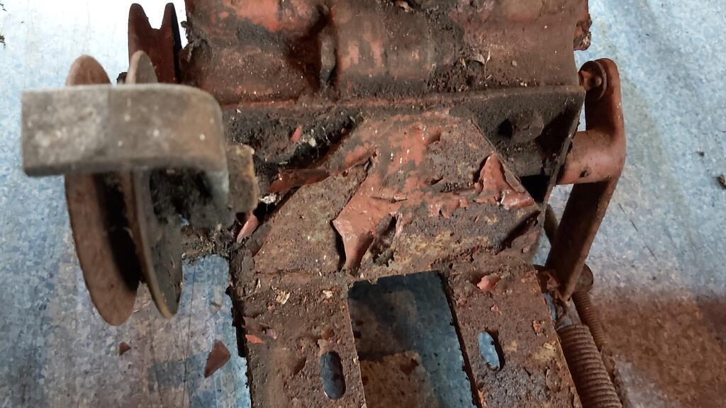

meadowfield 3,210 #11 Posted January 22, 2024 On 1/13/2024 at 7:47 PM, sjoemie himself said: That is some proper reinforcement and very clean welds. Excellent work! I've got the steel cut - have you any pictures of the original chassis with mounting for the gearbox and clutch? thanks Share this post Link to post Share on other sites

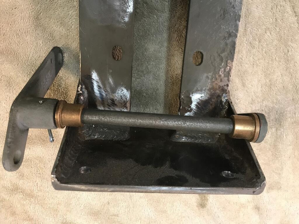

wallfish 20,744 #12 Posted January 22, 2024 1 hour ago, meadowfield said: I've got the steel cut - have you any pictures of the original chassis with mounting for the gearbox and clutch? thanks Does this help? Share this post Link to post Share on other sites
meadowfield 3,210 #13 Posted January 23, 2024 17 hours ago, wallfish said: Does this help? perfect! I didn't know there was a plate too! thanks Share this post Link to post Share on other sites

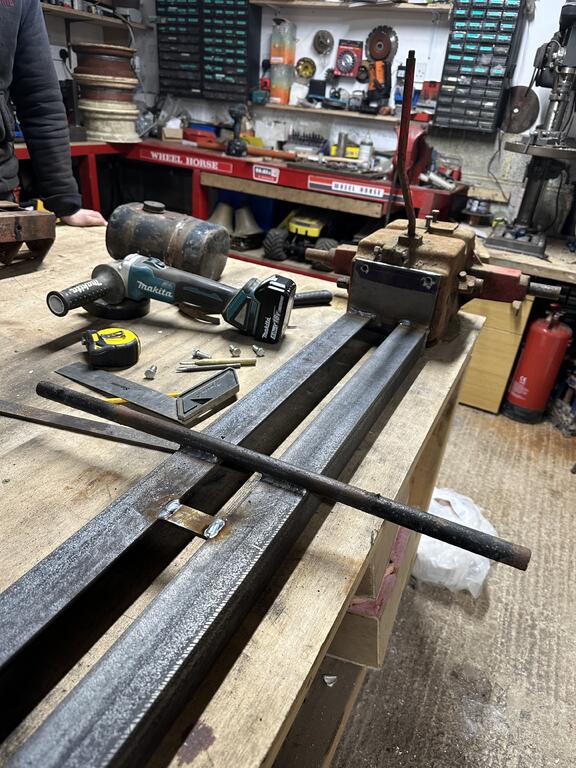

meadowfield 3,210 #14 Posted January 23, 2024 (edited) have you any side on pictures of each side? - sorry to keep asking.... this is where I’m at Edited January 23, 2024 by meadowfield 3 1 Share this post Link to post Share on other sites
wallfish 20,744 #15 Posted January 23, 2024 2 hours ago, meadowfield said: perfect! I didn't know there was a plate too! There were 2 different styles of frames they made. You don't need to add that plate in the front if you add the sides like oliver posted in his pics. I was just trying to show you the clutch bar as it's the same place for both syles. 2 Share this post Link to post Share on other sites

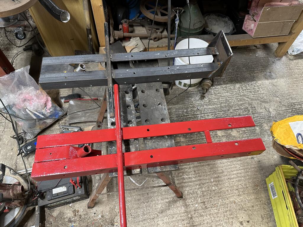

meadowfield 3,210 #16 Posted February 9, 2024 Thanks for the help so far, I now have a frame that will take a 2 piece transmission. here’s a 400 beside for comparison. 3 4 Share this post Link to post Share on other sites

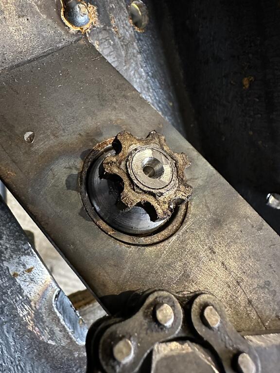

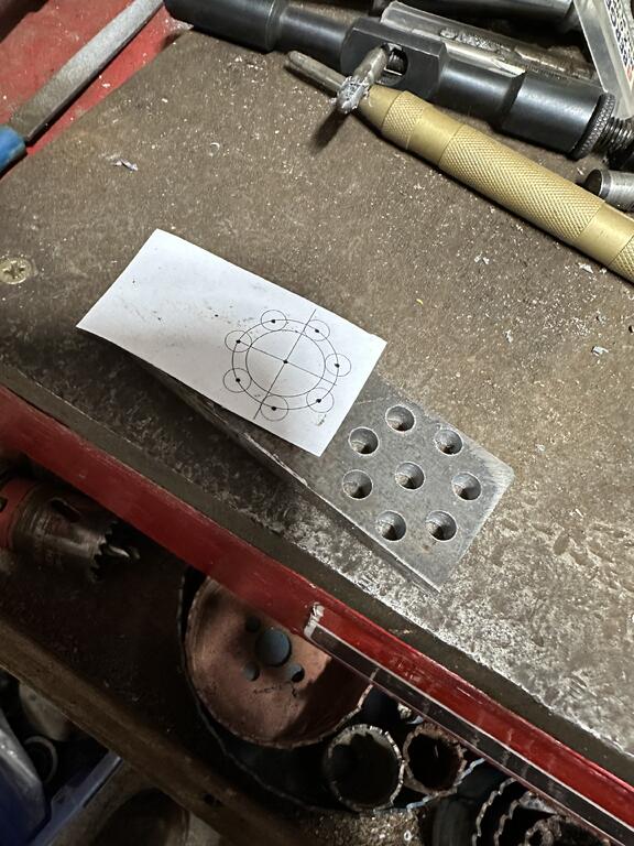

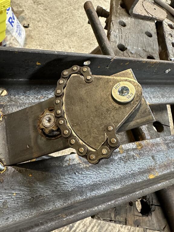

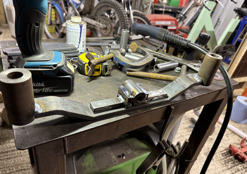

meadowfield 3,210 #17 Posted February 19, 2024 (edited) Making the steering quadrant…. I think it will work! Edited February 19, 2024 by meadowfield 4 2 Share this post Link to post Share on other sites

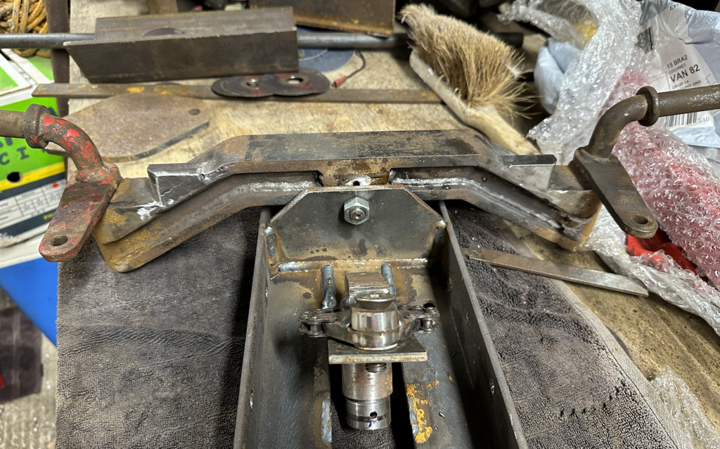

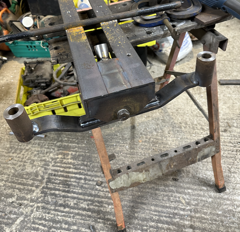

meadowfield 3,210 #18 Posted December 6, 2024 the speed of this project is off the scale A few more pics.... A bit of work with some thick bar and a press and I made an axle - paint will hide the grind marks and joints.... Tie rods to make this weekend, and then it will roll. I've an engine coming soon too! 2 5 Share this post Link to post Share on other sites

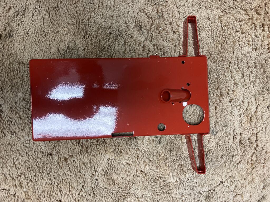

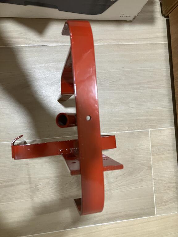

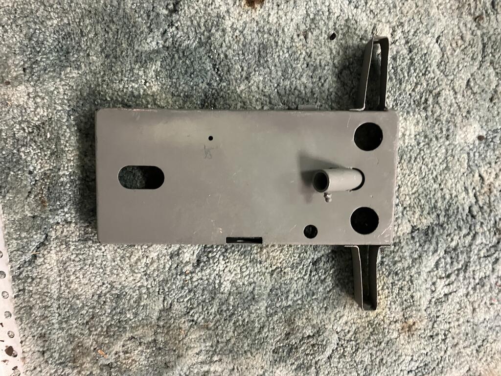

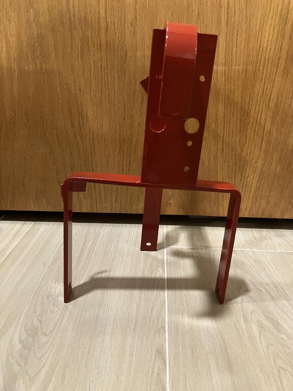

oliver2-44 11,847 #21 Posted December 11, 2024 (edited) On 12/8/2024 at 11:01 AM, meadowfield said: Hi, been making good progress - I thought the hoodstand frame was the same as a 600 - folded steel, but now looking it is different. Do you have any pictures and measurements? I just saw your request. It’s late here so here are some pictures of a 400 and 550 Hoodstand. I will make a sketch with measurements in the next day or 2. Edit, we’re you wanting the Hoodstand for a 551? I can get pictures of that if it is what you need. I also have this hood stand which is the same size, but has additional holes. I’m guessing it is for a 550. The lower hole is probable for the Tecumseh electric starter cable and the upper holes for starter bush button wires and maybe choke or throttle rod. Edited December 11, 2024 by oliver2-44 1 Share this post Link to post Share on other sites

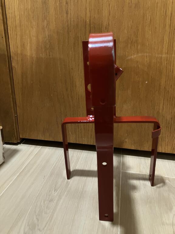

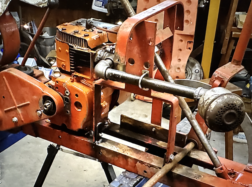

meadowfield 3,210 #22 Posted December 11, 2024 Hi, thanks - I've got a 400 hoodstand and that is as you have pictured, but the 551 is made from 1-1/2' flat bar and bolts to the frame differently. In the picture of the two chassis, you can just see the mounting tabs. from a poor youtube video, here is the part in question. On 1/11/2024 at 4:39 PM, oliver2-44 said: Here’s a picture of a Suburban 400 and 551 frame side by side. They both measure 32-1/2”. I can get you any more details if needed Here’s all the parts to assemble a 400 except the hood and transaxle Hi, been making good progress - I thought the hoodstand frame was the same as a 600 - folded steel, but now looking it is different. Do you have any pictures and measurements? thanks 1 Share this post Link to post Share on other sites

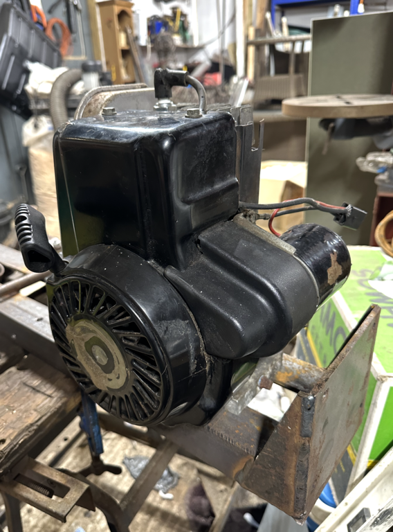

meadowfield 3,210 #23 Posted December 16, 2024 saved my self the pain or finding an original engine.... Over here, there are cylinder mowers with the modern equivalent engine. Same bolt pattern to the frame, electric start too! 3 Share this post Link to post Share on other sites

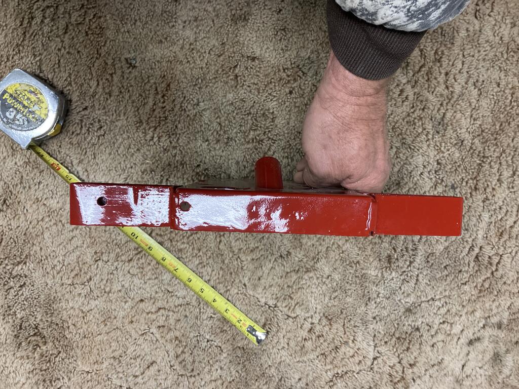

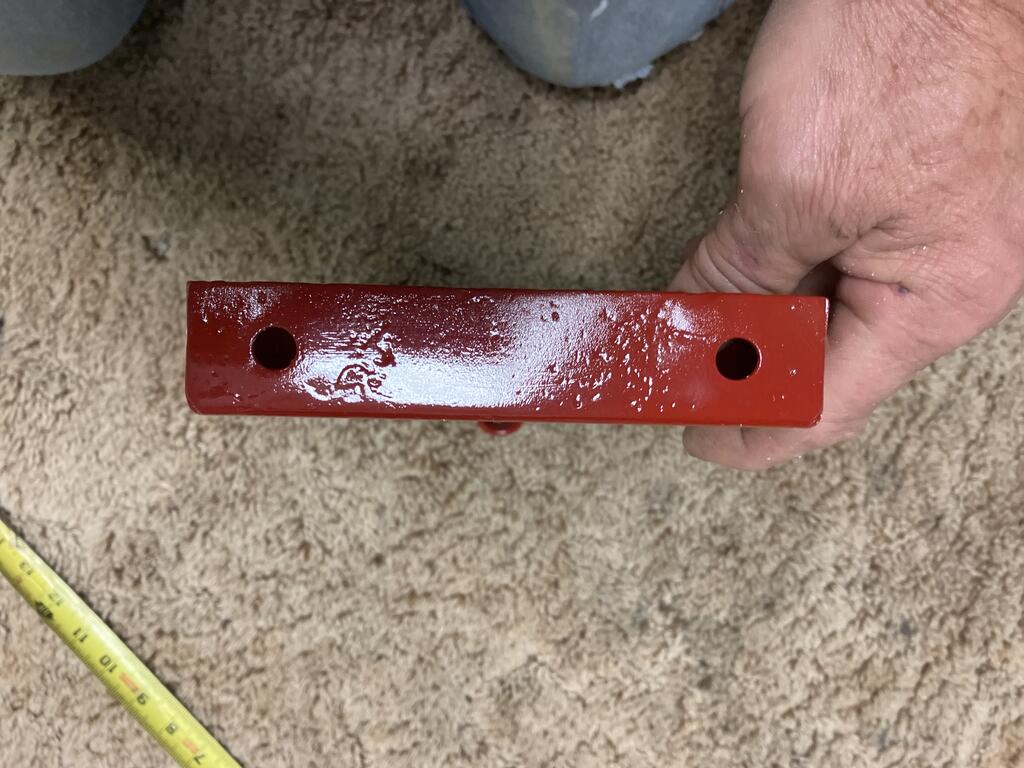

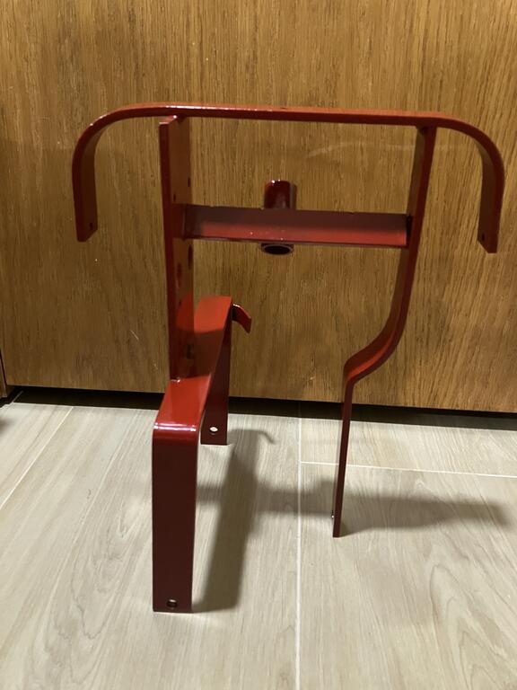

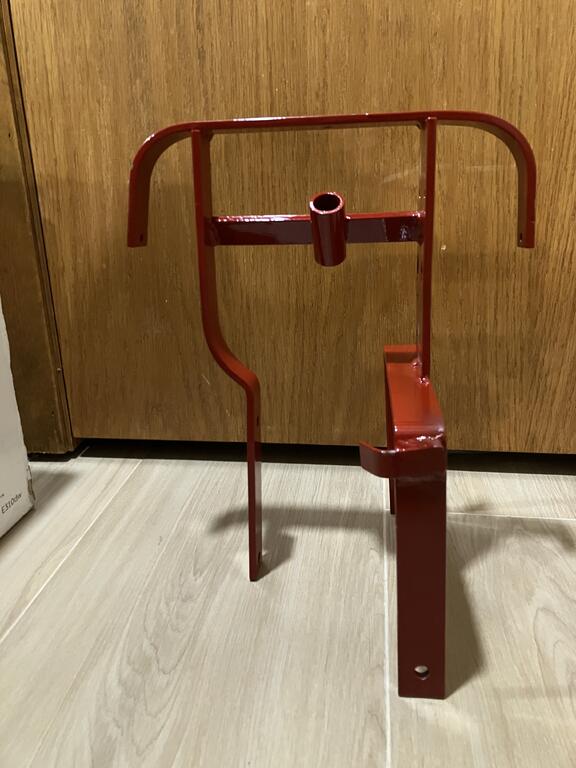

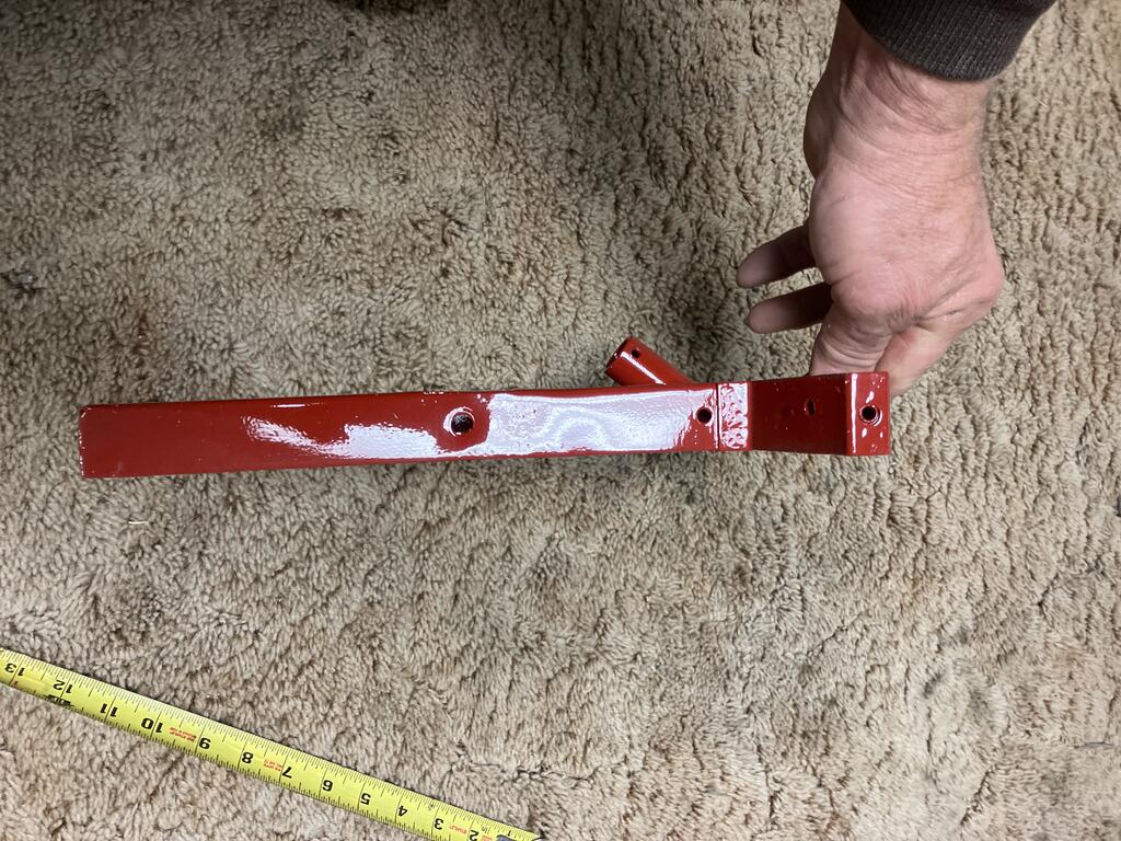

oliver2-44 11,847 #24 Posted December 17, 2024 @meadowfield Sorry I have gotten to start on this until this evening. here's some pictures and a materials list. I have a 1st draft drawing made and need to go verify some dimensions on the frame and a hood.. It is 7 simple parts welded into a somewhat of a complicated assembly It may be a few more days until I get back to finishing the drawing. Looking Forward Looking Backward Right Side Left Side Looking Down Material List 1/4" x 1-1/4 x 25 Right Side 1/4 x 3-1/8 x 7-1/2 Upper Right Side 1/4" x 1-1/4" 17-1/2' est Left Side 1/4"x 1-1/4" x 17-1/2" Upper piece 1/4 x 1" x 6-1/8" Steering Support 3/4" I.D. Schedule 40 Pipe Steering Shaft Guide 1/8" x 3/4" x 2-5/5" strap 1 2 Share this post Link to post Share on other sites
meadowfield 3,210 #25 Posted December 17, 2024 7 hours ago, oliver2-44 said: @meadowfield Sorry I have gotten to start on this until this evening. here's some pictures and a materials list. I have a 1st draft drawing made and need to go verify some dimensions on the frame and a hood.. It is 7 simple parts welded into a somewhat of a complicated assembly It may be a few more days until I get back to finishing the drawing. thanks - appreciate the help, doesn't need to be perfect, but does need to mount in the right place - hold the steering in the right place and fit the hood! 1 Share this post Link to post Share on other sites
