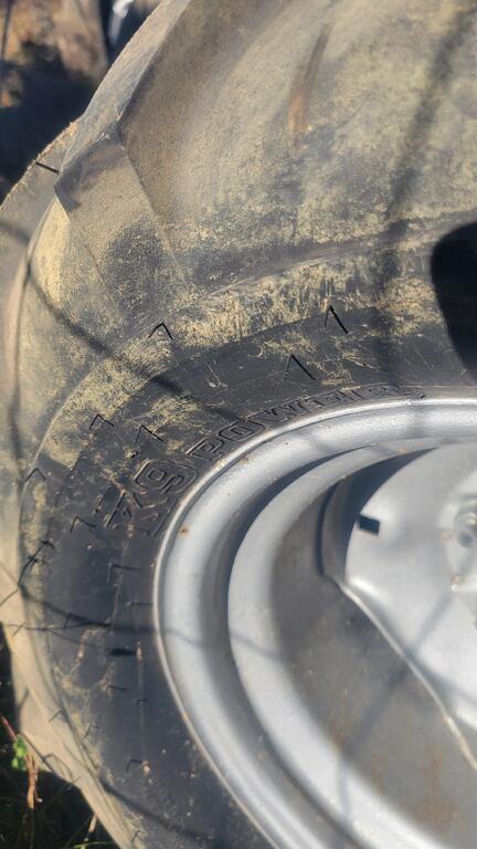

RED-Z06 2,718 #54 Posted February 6, 2024 11 minutes ago, The Freightliner Guy said: oh my goodness. whats the lug height/depth Ive never measured, but this is the specs. I got them off ebay a couple years ago 1 Share this post Link to post Share on other sites

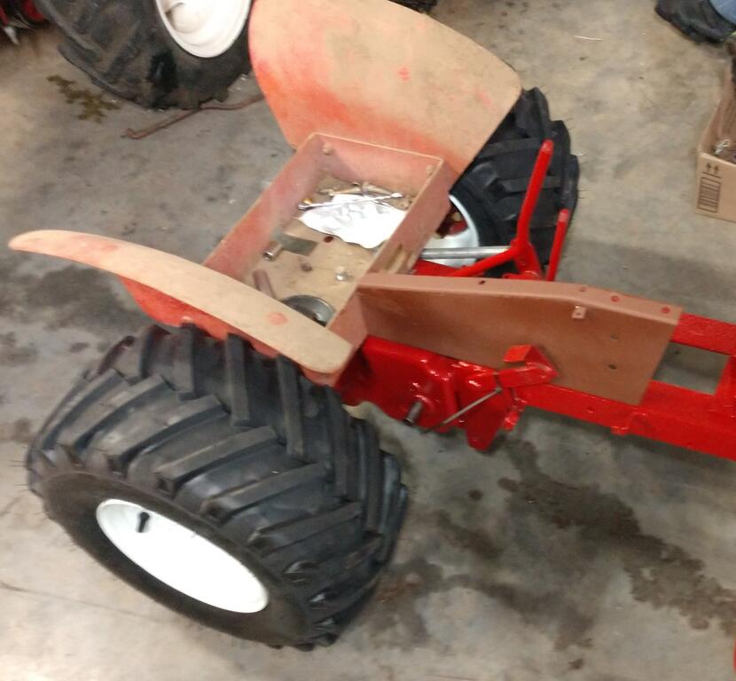

kpinnc 18,771 #55 Posted February 8, 2024 I said my next post would have more to it, but that isn't the case. The only fabrication I needed to do on this machine was to change this L-157 center console over to one that matches up to a R/E 32, 33, or 34 type so as to match the fender and toolbox. So I had to convert what I had. Here's the first side: And for the record, I hate welding sheetmetal! 6 1 Share this post Link to post Share on other sites

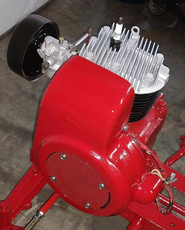

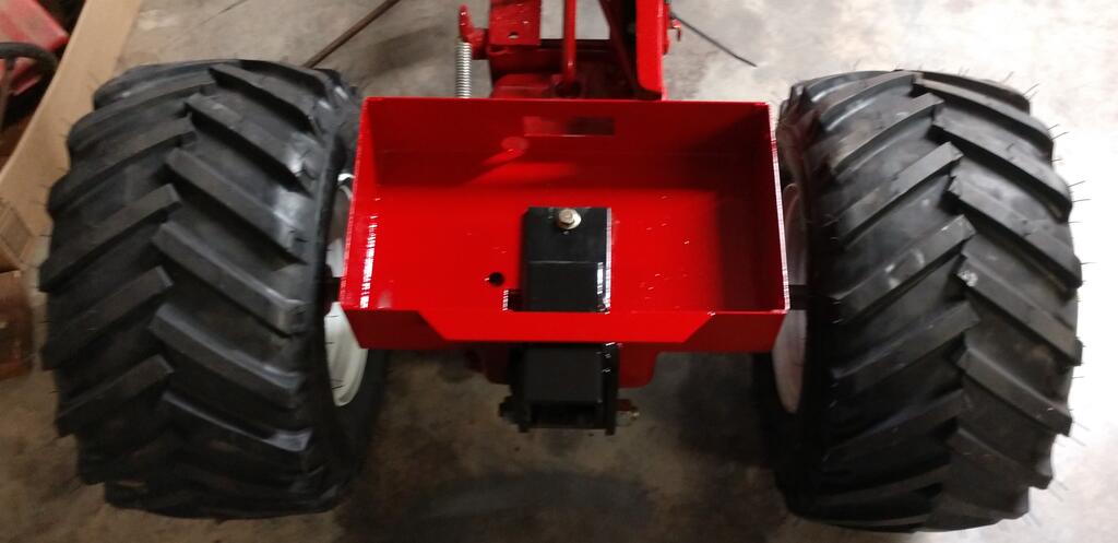

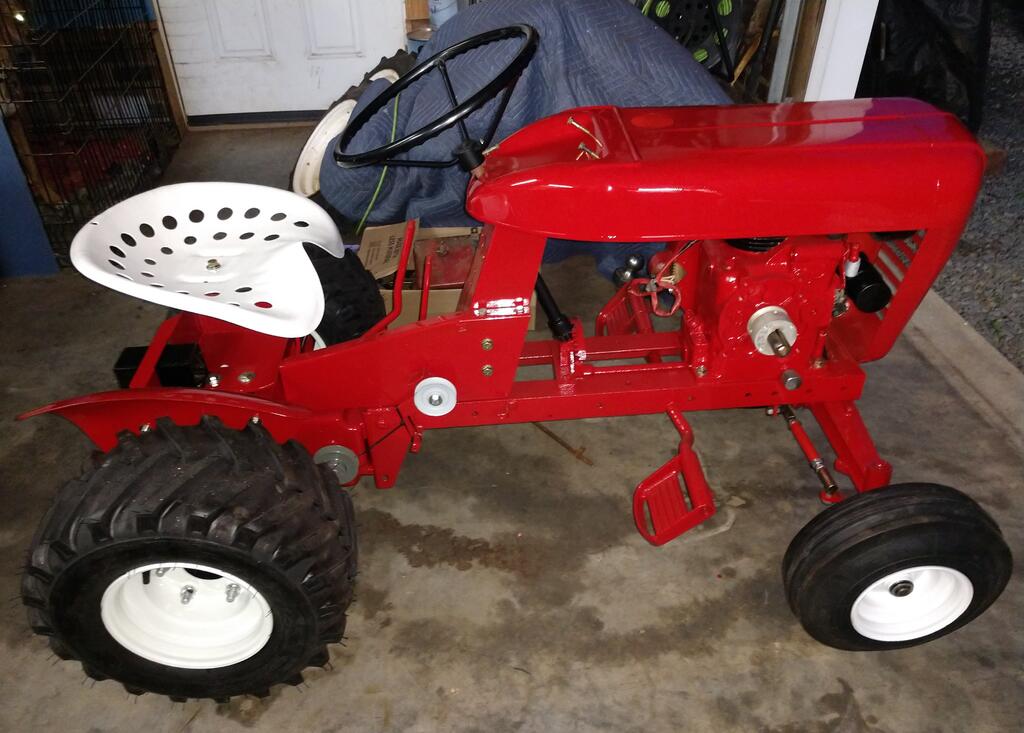

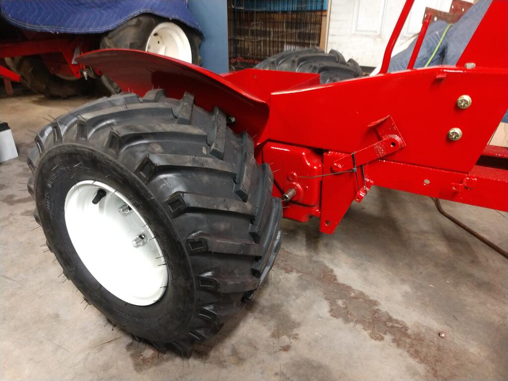

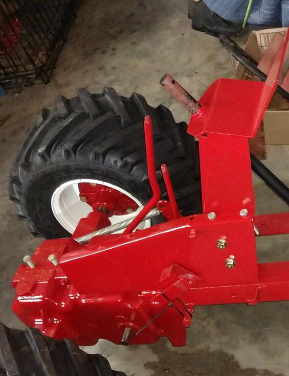

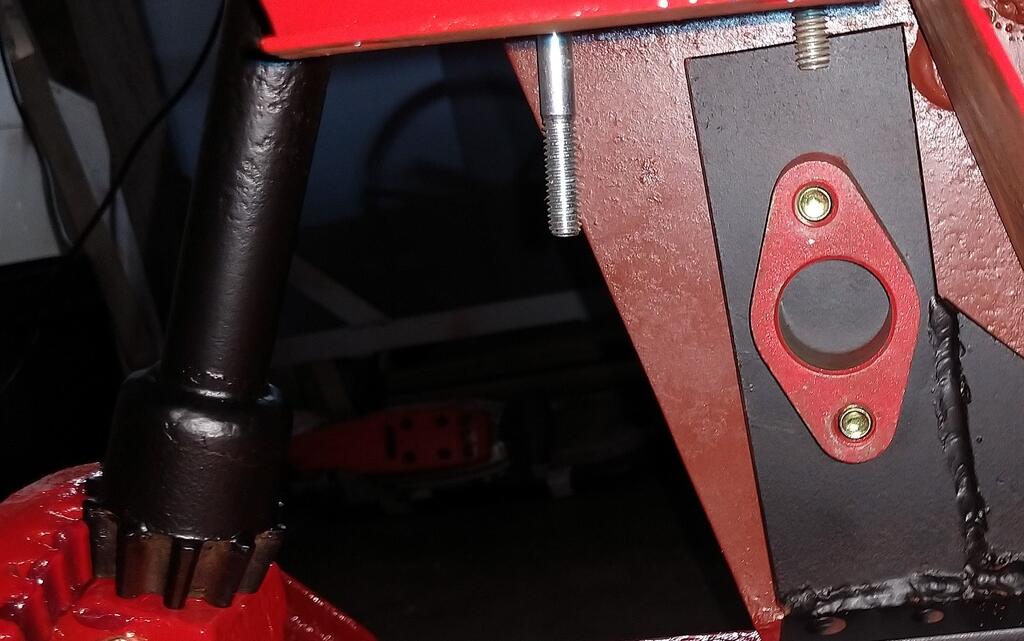

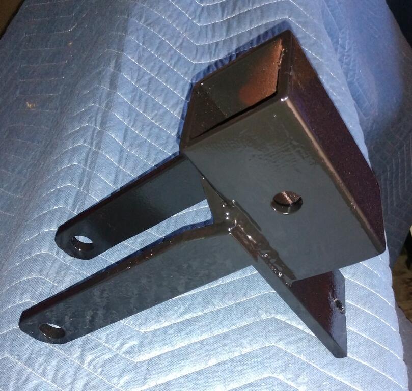

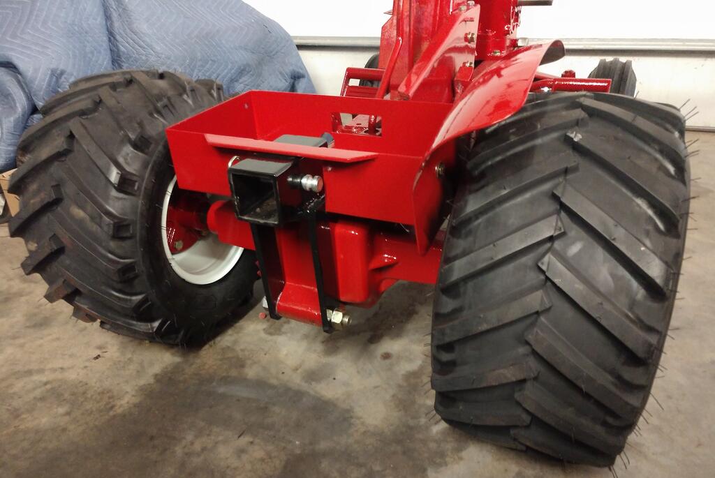

kpinnc 18,771 #56 Posted February 15, 2024 (edited) I said previously that this build had very little fabrication, but I guess I just can never leave well enough alone... I fabbed a heavier hitch for this little guy, and modded the toolbox so it would pass through the back. With the hitch on top, I didn't want it to stick out any further than needed. It's not as heavy as one that mounts on the axle, but at least it's more than 6 inches off the ground. The seat spring sits on top of the hitch. I also got the right side tunnel cover painted, and one fender. The other side is still in progress. Since these fenders came from a Suburban, they were too high for these wheels. So I lowered them so the sit closer to the tires. I had previously built added supports to use hydraulic lift on this, but abandoned that idea. It would work, but I didn't like the setup. Regardless, the supports are 1/4 plate and use pivots from a D series. They bolt in the same holes as the tunnel sides. The bellcrank is 1 inch, and has a removable tab to connect to a cylinder. I'll make a manual arm to fit it later. Or I'll figure something else out. Also started putting the engine back together... Edited February 15, 2024 by kpinnc 1 11 Share this post Link to post Share on other sites

Handy Don 17,037 #58 Posted February 15, 2024 13 hours ago, kpinnc said: That is a clever approach to a hitch mount and it leaves it pretty close to “road trailer” tongue height. 3 Share this post Link to post Share on other sites
kpinnc 18,771 #59 Posted February 15, 2024 2 hours ago, Handy Don said: That is a clever approach to a hitch mount and it leaves it pretty close to “road trailer” tongue height. Thank you sir. That is what I was shooting for. I won't use it for very heavy loads, but at least it's at a better height with these small wheels. 2 Share this post Link to post Share on other sites

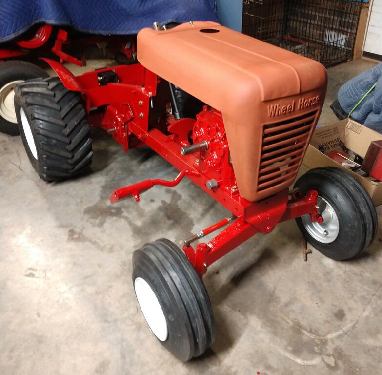

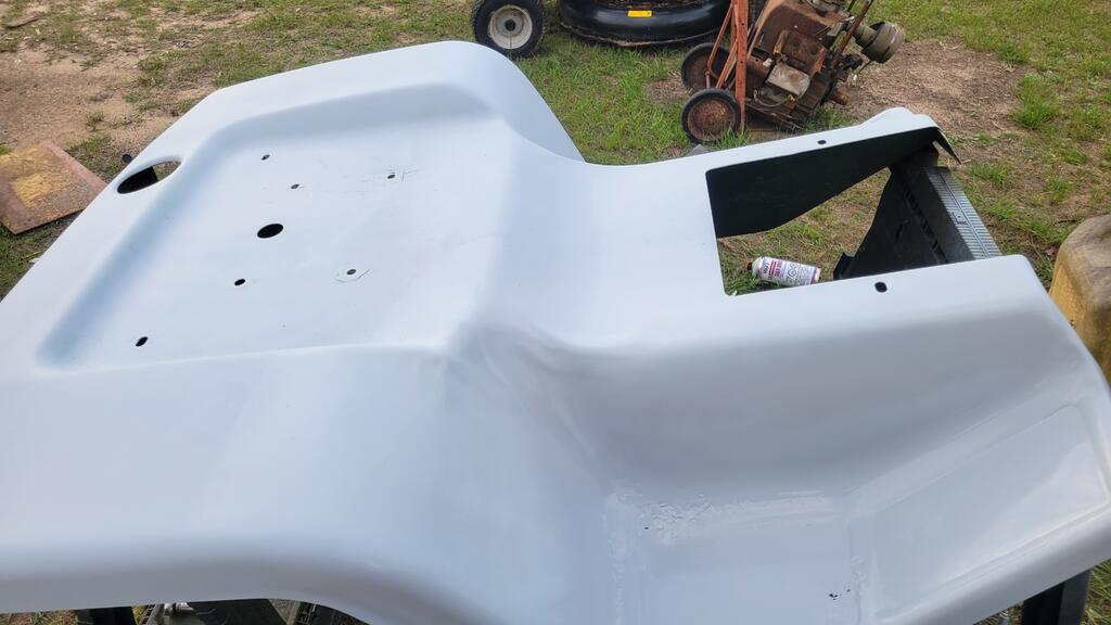

kpinnc 18,771 #61 Posted February 17, 2024 (edited) So I have fought this confounded hood for about 3 days now. Still got some dimples in the "brow" up front to fix, but at least it's primed now. All the big dents are banged out. The PO had put something like polyurethane on it with a brush. Problem was he left it in the rain for a while, and it had thousands of little rust filled blisters all over it. I've used paint stripper 4 times and scraped it off each time. Burned out my grinder and wire brush on it, because the stuff just balled up when sanded or brushed. After today's "strip and scrub" session, I got down to factory paint. Easy from there... So I gave her a test fit. Paint tomorrow.... Edited February 19, 2024 by kpinnc 3 8 Share this post Link to post Share on other sites

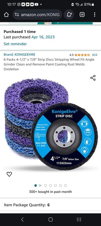

RED-Z06 2,718 #62 Posted February 17, 2024 1 hour ago, kpinnc said: So I have fought this confounded hood for about 3 days now. Still got some dimples in the "brow" up front to fix, but at least it's primed now. All the big dents are banged out. The PO had put something like polyurethane on it with a brush. Problem was he left it in the rain for a while, and it had thousands of little rust filled blisters all over it. I've used paint stripper 4 times and scaped it off each time. Burned out my grinder and wire brush on it, because the stuff just balled up when sanded or brushed. After today's "strip and scrub" session, I got down to factory paint. Easy from there... So I gave her a test fit. Paint tomorrow.... 4.5" angle grinder and these bad boys, they self clean pretty well, if im doing something pretty gummy i keep a brick or block next to me so I can just touch it off to clear the wheel. This fender had 3 or 4 coats, and rust, took about 45 minutes to do the whole thing and about 3 wheels, the finish was good enough to wipe down with spirits and prime. 1 5 Share this post Link to post Share on other sites
Handy Don 17,037 #63 Posted February 17, 2024 13 hours ago, RED-Z06 said: I'm a convert to these as well. There are different grits but the most aggressive (purple in the brand I use) is quite gnarly while the “smoothest” blacks leave a very nice surface. When I was using flux core welding wire, these were my go-to cleanup--not only the slag, but they took off minor imperfections in the metal. 3 1 Share this post Link to post Share on other sites
kpinnc 18,771 #64 Posted February 17, 2024 15 hours ago, RED-Z06 said: 4.5" angle grinder and these bad boys, they self clean pretty well, Thanks. I ordered a set. Just bought a new grinder, might as well check them out. 3 Share this post Link to post Share on other sites
RED-Z06 2,718 #65 Posted February 17, 2024 2 hours ago, kpinnc said: Thanks. I ordered a set. Just bought a new grinder, might as well check them out. You'll love em, they dont gouge either which is nice. They will hook an edge so always keep the away side in mind when doing edges. 2 1 Share this post Link to post Share on other sites

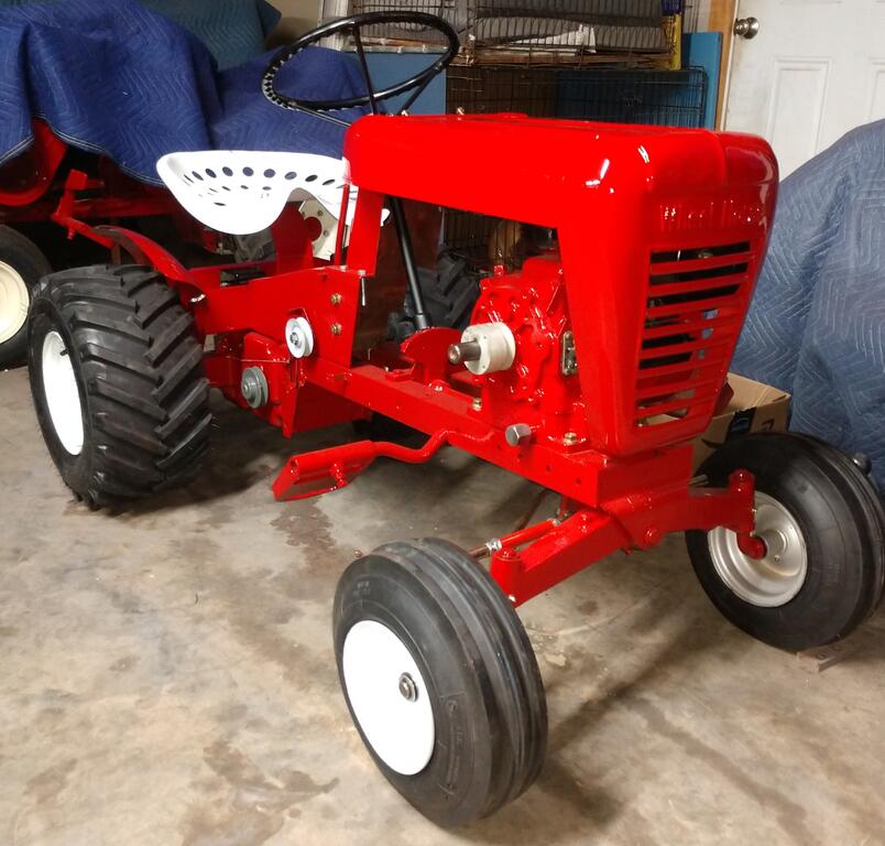

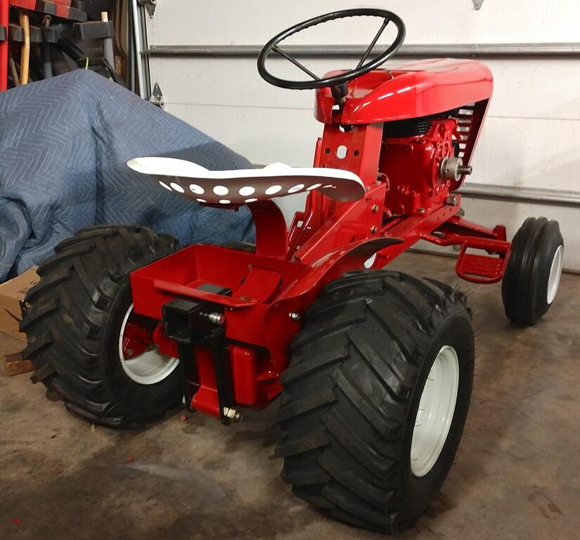

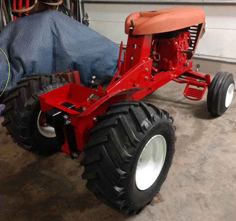

kpinnc 18,771 #66 Posted February 18, 2024 Little more progress today. Time to call Terry and order some steekers! I know the white is wrong, but the rear wheels are that color and I'm just trying to match what's already there. The seat was so rough that it'll probably get a cover anyway... 1 11 2 Share this post Link to post Share on other sites
Cody 285 #67 Posted February 19, 2024 Wow that looks great! I've really been enjoying the build and seeing the progress. All the effort in the hood was well worth it, Came out awesome 👍 2 Share this post Link to post Share on other sites
kpinnc 18,771 #68 Posted February 19, 2024 (edited) 5 minutes ago, Cody said: Wow that looks great! I've really been enjoying the build and seeing the progress. All the effort in the hood was well worth it, Came out awesome 👍 Thank you! Still got a small dimple on the brow, but my son will likely make it worse over the next few years. Probably gonna fab a bumper for the nose anyway! Edited February 19, 2024 by kpinnc 2 2 1 Share this post Link to post Share on other sites
SylvanLakeWH 31,827 #69 Posted February 19, 2024 Looks great!!! 2 1 Share this post Link to post Share on other sites

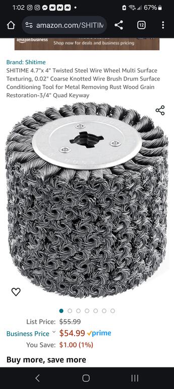

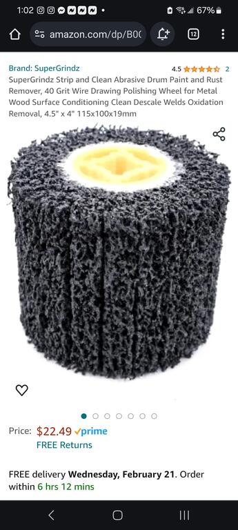

RED-Z06 2,718 #75 Posted February 19, 2024 This is really handy, bit bulky, but i find myself laying it on the bench upside down and using it to clean parts when i cant clamp them in a vice..it leaves a really smooth finish. 4 1 Share this post Link to post Share on other sites
