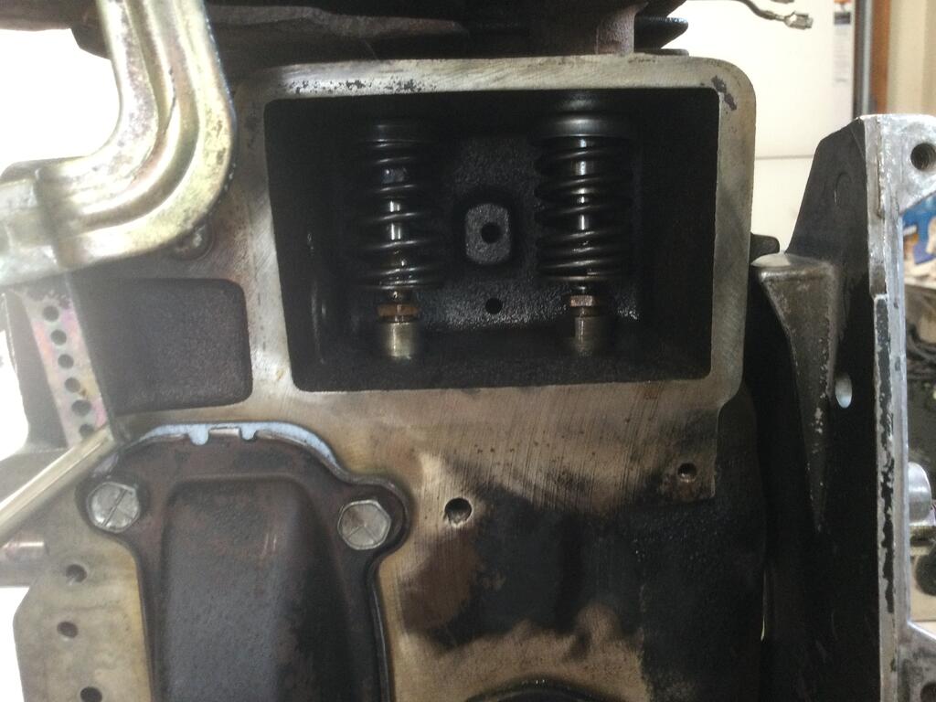

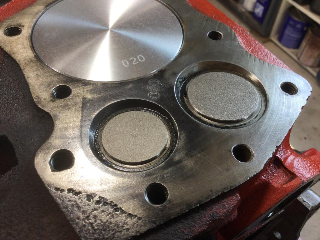

richmondred01 2,383 #10 Posted December 8, 2023 Remove, clean, face (if required), lap and adjust valves. This is an overlooked procedure and is a fairly easy process. 1 Share this post Link to post Share on other sites
