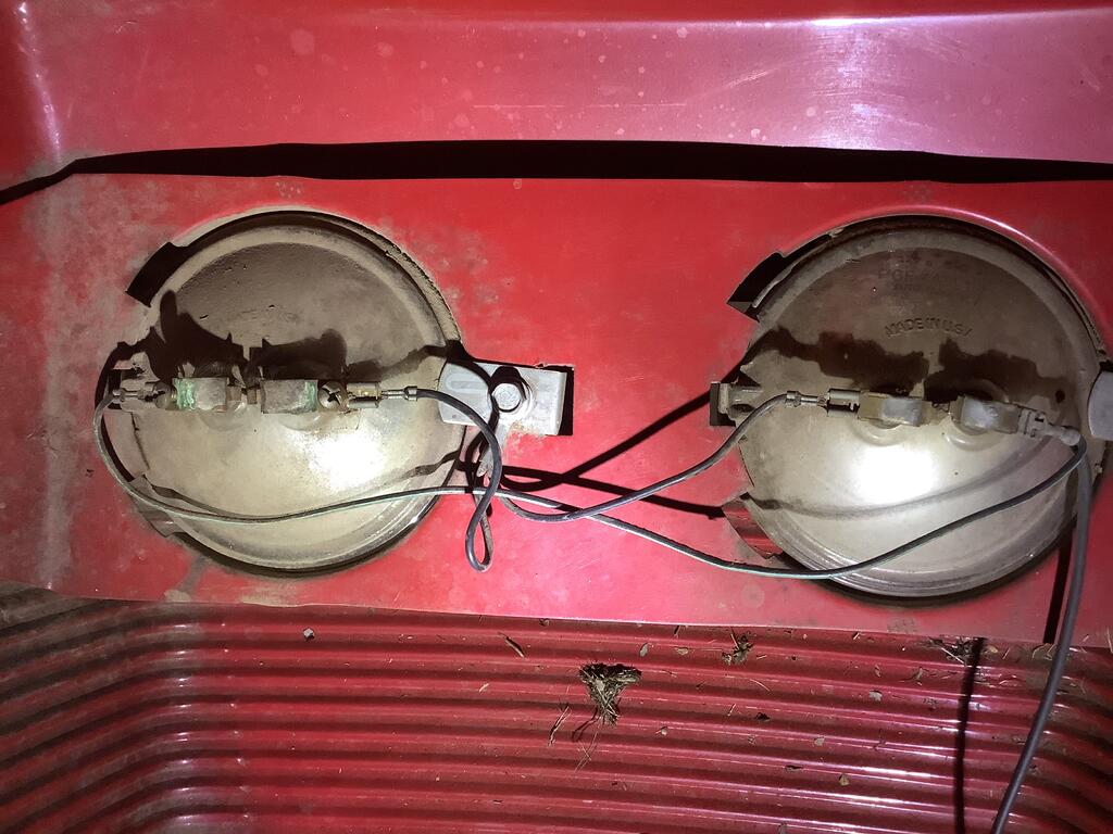

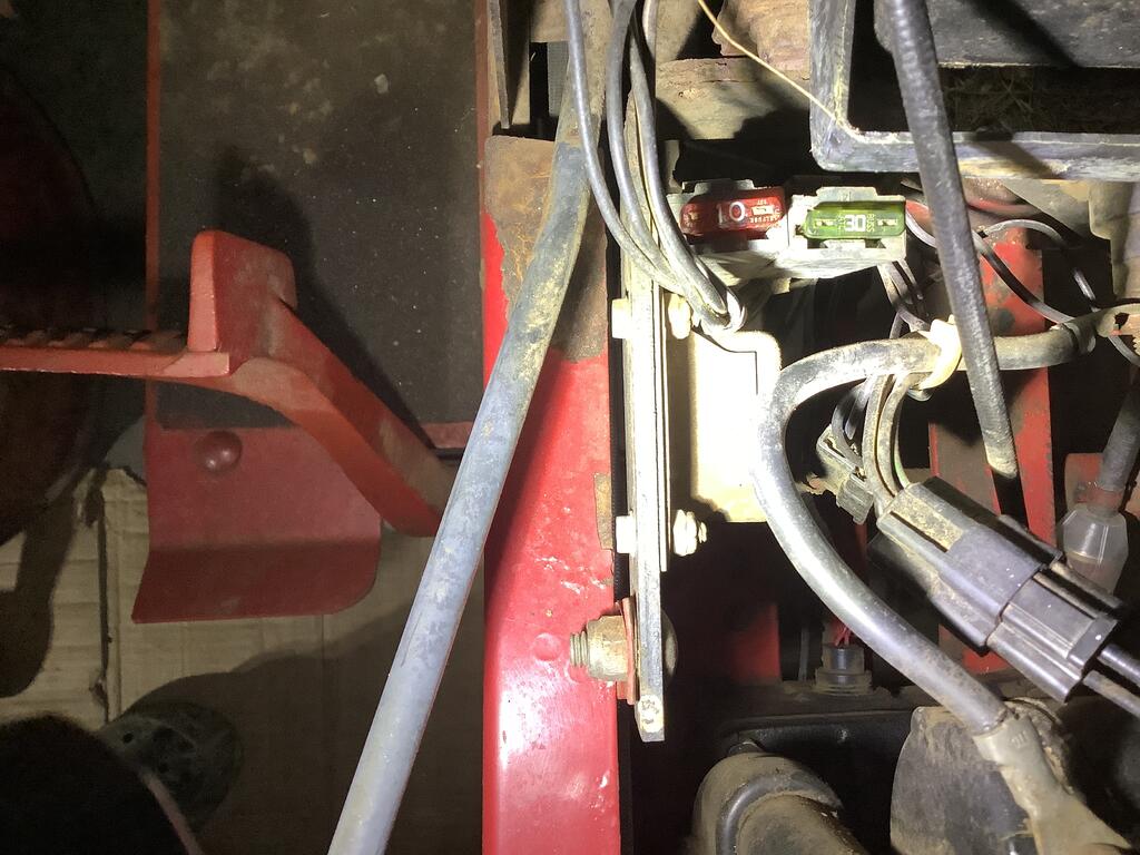

TonyToro Jr. 2,392 #1 Posted December 5, 2023 So on my 310-8 the headlights only go on for about 5 seconds then shut off that cannot be turned back on again. I checked fuses and grounds all seem to be tight but still can’t find the issue of why they go on then turn back off. The power wire hookup to the headlight bulb are a little corroded but I didn’t think that would be the issue. Could I maybe be the bulb? Grounded out wire? Switch? It’s just weird that they go on fine then shut off and never go back on. Share this post Link to post Share on other sites

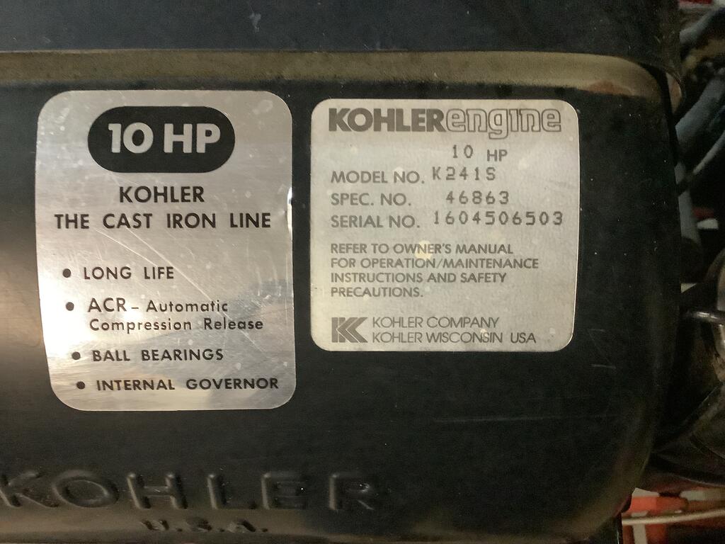

WHX?? 55,702 #4 Posted December 5, 2023 What has to happen to get them on again? Anyway you can post the engine name plate? 1 Share this post Link to post Share on other sites

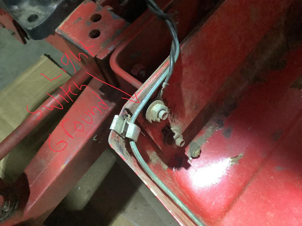

squonk 45,805 #5 Posted December 5, 2023 (edited) I would say stator or switch. Unhook the 2 wires at the switch and connect them together. Start the tractor. If the lights stay on (and I bet they do, you need a switch. Also make sure the hood is grounded well. Add a jumper to ground. Edited December 5, 2023 by squonk 1 1 Share this post Link to post Share on other sites
SylvanLakeWH 30,774 #6 Posted December 5, 2023 I'd take the ground wire off, clean, dielectric grease, then retighten. Check all connections and wires for wear. 1 1 Share this post Link to post Share on other sites
TonyToro Jr. 2,392 #7 Posted December 6, 2023 38 minutes ago, WHX?? said: What has to happen to get them on again? Anyway you can post the engine name plate? To get them on again, shut it off and turn back on then they go back on for about 5sec then shut off. Share this post Link to post Share on other sites

gwest_ca-(File Mod) 12,066 #11 Posted December 6, 2023 Your tractor is a 1986 model 21-10K802 or model 21-10K803 Engine must be running for lights to work. 1 1 Share this post Link to post Share on other sites
squonk 45,805 #12 Posted December 6, 2023 11 hours ago, TonyToro Jr. said: So I just took off both wires from the switch and still nothing. Did you connect them together and start the engine? How about grounding the hood? I have seen those hoods lose the ground when they are open. 1 1 Share this post Link to post Share on other sites
TonyToro Jr. 2,392 #13 Posted December 6, 2023 14 minutes ago, squonk said: Did you connect them together and start the engine? How about grounding the hood? I have seen those hoods lose the ground when they are open. Yes I connected the 2 wires going to switch together with a jumper wire. But I did have the hood open. Should I try again with the hood closed? I’m also going to check that ground too my dad said to take it off clean, dielectric grease and put back together? 1 Share this post Link to post Share on other sites
SylvanLakeWH 30,774 #14 Posted December 6, 2023 See post 6. Agree with @squonk about hood tilt. I had that problem. Fixed with solid ground. 1 1 Share this post Link to post Share on other sites
peter lena 9,797 #15 Posted December 6, 2023 @ TONY TORO JR , https://www.supplyhouse.com/Blackburn-ADR2-ALCUL-Single-Conductor-One-Hole-Mount-Slotted-Screw-14-AWG-2-Str? often refer to this type of electrical ground point , have them on every related poor connection point , especially engine / frame area , very good on engine COOLING TIN , rectifier mount point , eliminates issue , also dielectric lube bolt down / screw point , have years on the change , no problem , Pete 1 Share this post Link to post Share on other sites
squonk 45,805 #16 Posted December 6, 2023 The hood itself will loose ground contact with the tractor. Just cleaning the ground wire at the headlights may not be enough. Make sure the hood itself is grounded. I add a ground wire just for the hood. 2 1 Share this post Link to post Share on other sites
TonyToro Jr. 2,392 #17 Posted December 6, 2023 5 hours ago, squonk said: I add a ground wire just for the hood. What do you mean by that? Pictures? Share this post Link to post Share on other sites
TonyToro Jr. 2,392 #18 Posted December 6, 2023 I’ve figured out the issue it’s somewhere in the wires bulbs are good fuses are good and switch is good. I’ll do what @squonk said. Add a ground where and clean and check all connections and inspect wires. 1 Share this post Link to post Share on other sites
WHX?? 55,702 #19 Posted December 7, 2023 What Squonky meant is the ground to the headlights are done through the hood hinges which can become greasy and unreliable. More so with led lights. Re-ground the hood with a separate ground wire from the hood or lights directly back to the frame. If your not blowing fuses must be a ground issue and not a short. Let us know what you find might help me find the gremlin on a 520. 2 1 Share this post Link to post Share on other sites

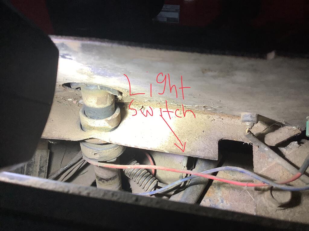

Lee1977 7,627 #21 Posted December 17, 2023 Looks to me like the power wire is grounding out on the steering column. 1 Share this post Link to post Share on other sites
