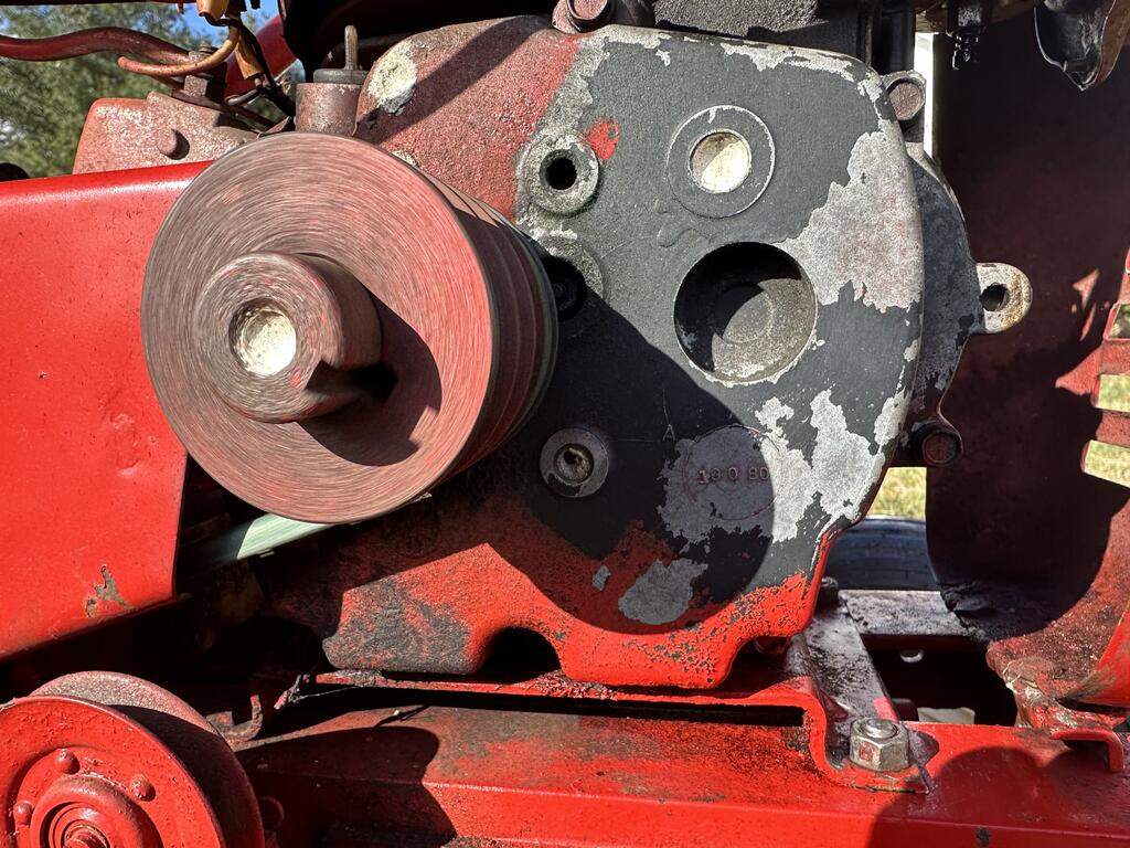

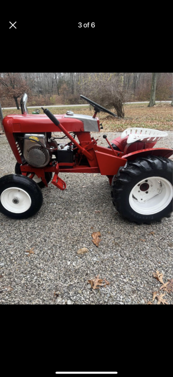

Handy Don 17,465 #2 Posted December 5, 2023 Welcome to the forum. You are definitely in the right place. You have a ’60 or ’61 tractor. The model depends on the engine--they were Kohler or Tecumseh--from 5 to 7 horsepower. Yours might have had the engine replaced. Getting a close image of the data plate on the engine will help a lot. Also a picture from the right side that shows the belt guard. 1 Share this post Link to post Share on other sites

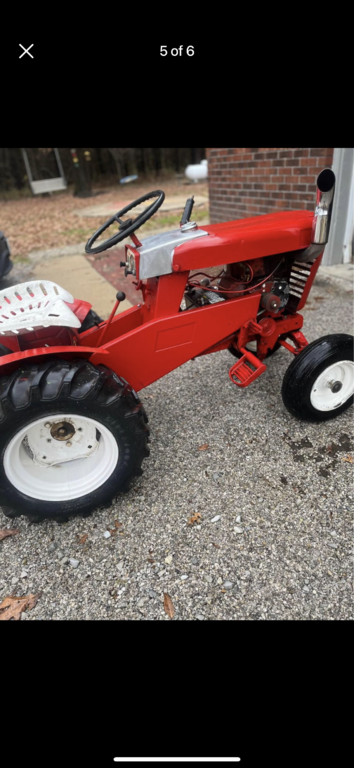

Jeremiah elliott 29 #3 Posted December 5, 2023 I believe the motor has been replaced unfortunately. I would of loved to have it all original but that’s a lot to ask for. This is a pic of the belt guard and I have some more. Also the gas cap looks like a modified one that doesn’t fit. If I could find an original or an after market one that is like the original that would be awesome. 2 Share this post Link to post Share on other sites
Handy Don 17,465 #4 Posted December 5, 2023 60 year old machine has probably seen a few different owners but at least it’s been kept running! Advice on running will depend on what engine is on there now. Picture isn’t real clear but I’m guessing a newer Tecumseh, maybe 6 or 7 hp. Flame shooting could be an issue with the exhaust valve not closing or not having a reliable spark. How are your mechanical skills? Share this post Link to post Share on other sites

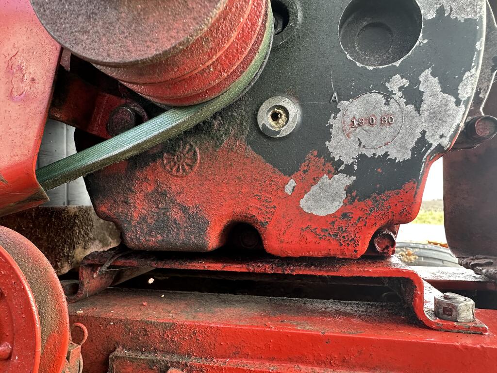

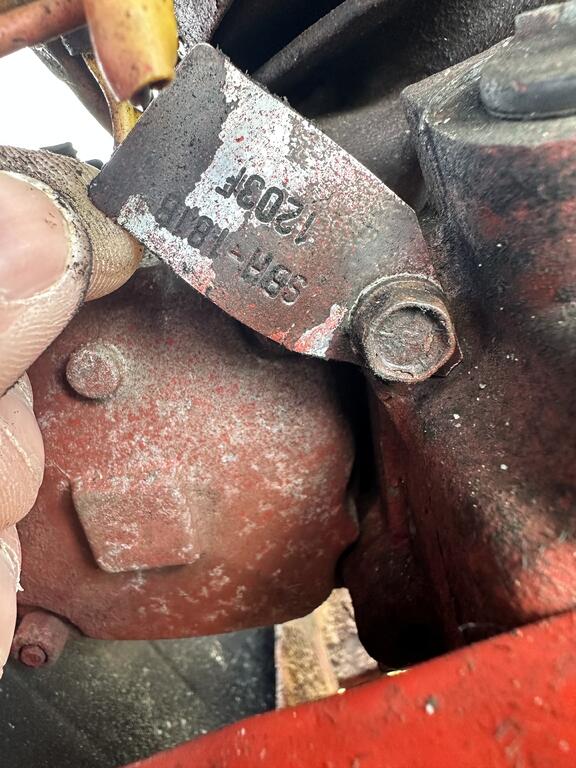

Jeremiah elliott 29 #18 Posted December 5, 2023 16 hours ago, Handy Don said: Welcome to the forum. You are definitely in the right place. You have a ’60 or ’61 tractor. The model depends on the engine--they were Kohler or Tecumseh--from 5 to 7 horsepower. Yours might have had the engine replaced. Getting a close image of the data plate on the engine will help a lot. Also a picture from the right side that shows the belt guard. This are some pics of the motor but I have no clue what any of the numbers mean. Share this post Link to post Share on other sites
Handy Don 17,465 #19 Posted December 5, 2023 (edited) I’m assuming you haven’t found the numbers stamped into the cooling shroud of the engine? They might be paint-obscured. The S5H on the engine tag might indicate a 5hp, electric start, horizontal shaft engine. That is completely consistent with a 552 model (5 hp, electric start, 1962). The other number is possibly the date of manufacture--1 for 1971 (or 1961?) and 203 being the 203rd day of the year--July 22nd. The 19 0 80 on the block is a casting number but I don’t know how to decode those. If it wasn’t for all the grey paint and that bolt-on tag, I’d suspect it IS the original engine. Much more likely, though, you have a newer, “like for like” replacement--possibly even dealer-installed, given the attempt to paint it and using the proper mounting plate. It is equipped with the 3-sheave pulley. One for the drive belt to the transaxle, one for the mower deck or show blower, and one for the optional hydraulic lift unit. Curiously, the two out sheaves are rust pitted and, with the paint, show no signs of recent use. A belt would have kept them smoother and paint-free. The 5hp Tecumseh was an “economy” engine of its day--priced and designed for moderate duty applications. Very suitable for a small tractor. Basic repair parts like carb kits are readily available. They were commonly found on tillers and snowblowers that saw only intermittent, seasonal use. Edited December 5, 2023 by Handy Don 1 Share this post Link to post Share on other sites
Jeremiah elliott 29 #20 Posted December 5, 2023 2 minutes ago, Handy Don said: I’m assuming you haven’t found a data plate or decal on the cooling shroud of the engine and the decal that’s visible isn’t helpful? The S5H on the engine tag might indicate a 5hp, electric start, horizontal shaft engine. That is completely consistent with a 552 model (5 hp, electric start, 1962). The other number is probably describing the “build” features or possibly the date of manufacture. The 19 0 80 on the block is a casting number but I don’t know how to decode those. If it wasn’t for all the grey paint and that bolt-on tag, I’d suspect it IS the original engine. Much more likely, though, you have a newer, “like for like” replacement--possibly even dealer-installed, given the attempt to paint it and using the proper mounting plate. It is equipped with the 3-sheave pulley. One for the drive belt to the transaxle, one for the mower deck or show blower, and one for the optional hydraulic lift unit. Curiously, the two out sheaves are rust pitted and, with the paint, show no signs of recent use. A belt would have kept them smoother and paint-free. The 5hp Tecumseh was an “economy” engine of its day--priced and designed for moderate duty applications. Very suitable for a small tractor. Basic repair parts like carb kits are readily available. They were commonly found on tillers and snowblowers that saw only intermittent, seasonal use. I haven’t been able to locate the tag on this thing anywhere. Those are the only things I could find. My overall goal is to keep it as original as possible with minimal upgrades. I found fuel leaking out of the carb today and figured it was running rich. I found a local toro dealer and they are going to take a look at it and see what it will take to fix what is there. I told them if anything needs to be replaced to let me know so I can find a rebuilt original or a manufacturer replica of the original. Once all is said and done it will be getting a fresh paint job. Are the gas tanks normally chrome or were they painted red also? Share this post Link to post Share on other sites
Handy Don 17,465 #21 Posted December 5, 2023 Fuel flowing out of the carb likely means that the float valve isn’t working properly. There may not be a tag. It might well be the numbers are stamped into the shroud around the flywheel. They’d be near the bottom toward the front of the tractor. Look for H50-xxxxx and a bunch of other numbers/lettters. The tanks are aluminum and normally painted red with the tractor. Many POs have painted them with chrome paint. Be VERY careful with the screws that hold the hood to the tank. An over-long screw will push in too far and either break out the threads or, at worst, puncture the tank. There are sources for original-looking thumbscrews and other parts starting with placing a classified “want” here on the forum. Also look at the classified “Vendors”. Wheel Horse Parts and More has many OEM-equivalent replacements, KP Parts has lots of NOS (new old stock) and refurbished stuff, and A-to-Z Tractor sells new and used parts. A carb overhaul is pretty easy (and there are lots of YouTubes to show you how!) Using a dealer for repairing an old engine can be pricey. Qualify them for their experience before committing. 1 Share this post Link to post Share on other sites
