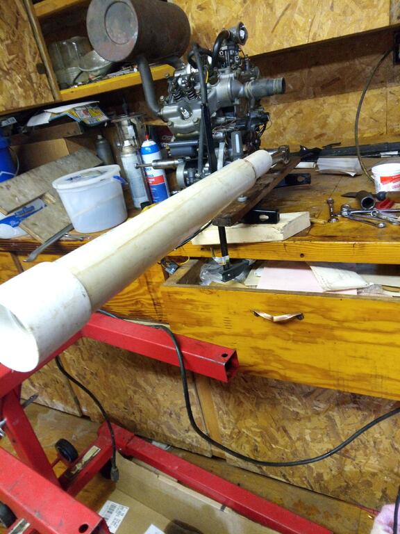

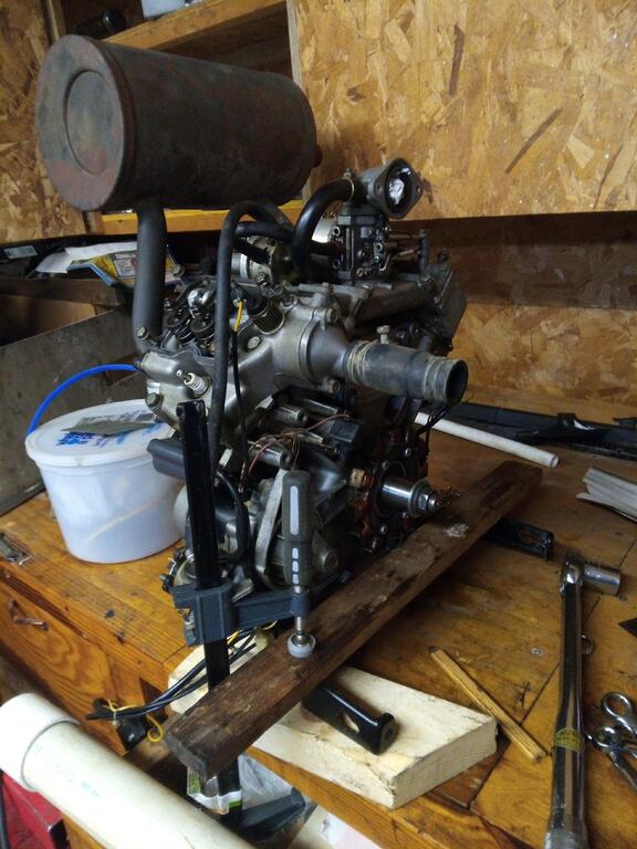

ohiofarmer 3,543 #7 Posted December 9, 2023 So here it is in the OR. I put 150 ugga duggas on the torque wrench and nothing's happening. I used the approved back saver 2000 handle extension. The camshaft is out and perfect. The crank is probably OK, but that has to wait for the owner. I am thinking to not push things because one of the connecting rods is at a pretty steep angle. I might be better to remove the heads and tap the pistons straight down into the bore. Possibly the thing has a water leak at the head gasket and the piston bores got rough and then seized. If the bottom end is OK then a possible rebore or refresh may be enough to make a good plow tractor. The water left in the overflow bottle was very pale, do that is a concern Share this post Link to post Share on other sites

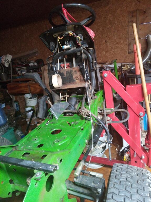

ohiofarmer 3,543 #8 Posted December 9, 2023 So here is the actual tractor frame. Power steering and beefy steering components which compare to the 520 Wheel Horse. . The rear frame is right inches tall and the front frame st the engine drop is over three Thickness is about .18 inch Share this post Link to post Share on other sites

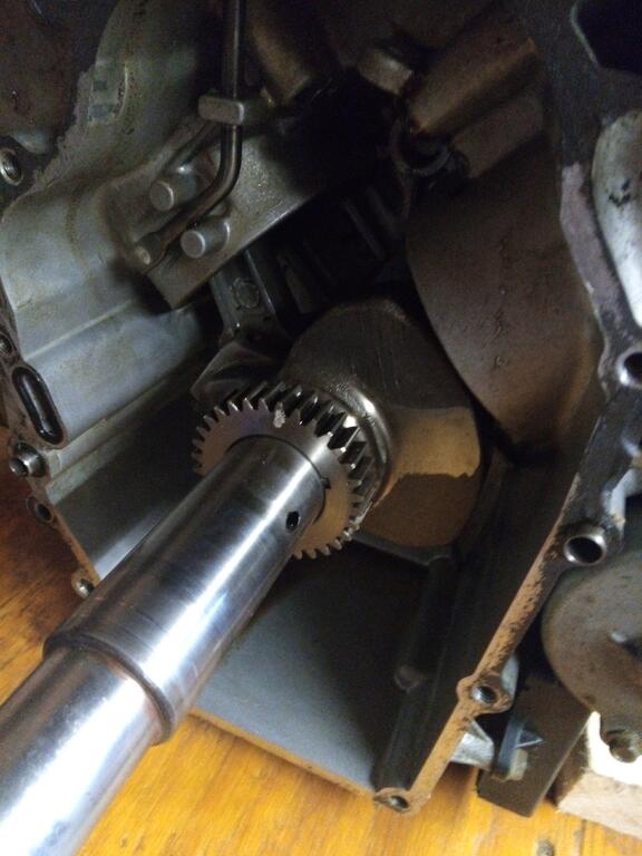

ohiofarmer 3,543 #9 Posted December 14, 2023 I have it taken down as far as it will go One of the pistons is at the near bottom of the stroke, The other one is closer to the top. There is nothing wrong with the crank===no scratches or wear at all.Rod ends are fine, Piston walls are glazed but very nice. Still stuck however.All I know to do is give it some more time with the ATF brew. I guess aftIter that I might try using an air hammer on the tops of the pistons padded with plywood rounds to protect them and see if they will break loose., This thing is frustrating. The aluminum block has no corrosion in the water passages , but yet the pistons are seized with no scoring in the cylinders Share this post Link to post Share on other sites
