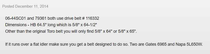

It Is My Understanding that Toro made the drive belt #11633264 a 1/2" off size most likely to have you to purchase their belt. My question is has anyone used a 64" or a 65" belt with any success?

Buy a 64 and 65 keep what fits the best and return the one that don't. And keep the grease out of the belt !:)

Gates replaces the 116332 with a 5/8" x 65" belt.
