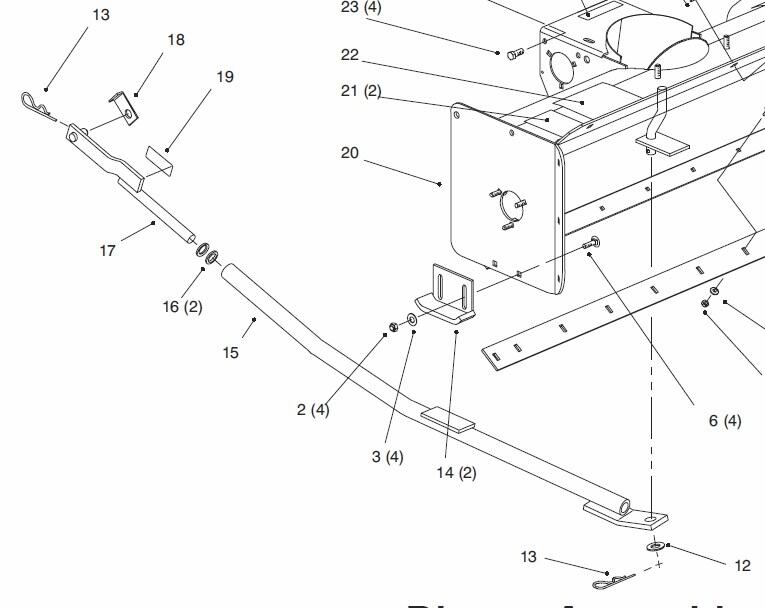

gwest_ca-(File Mod) 12,258 #4 Posted December 3, 2023 You could add more item 16 flat washers to the lift tube. Sorry don't know the diameter but SAE type would be best. 2 Share this post Link to post Share on other sites
