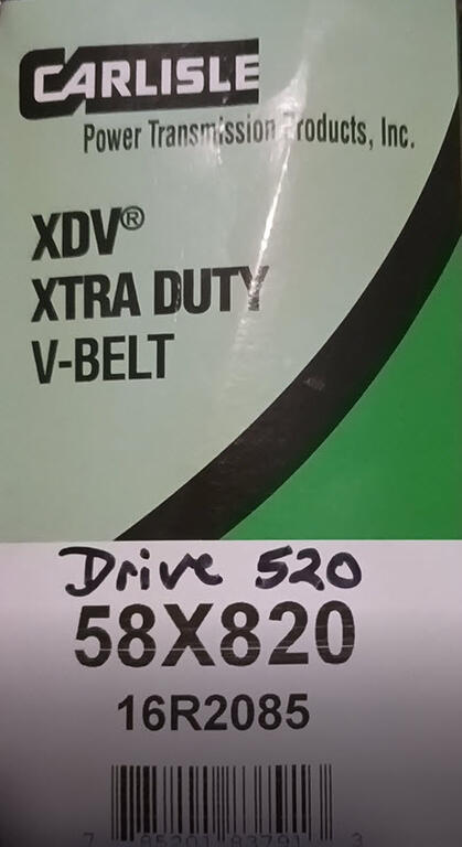

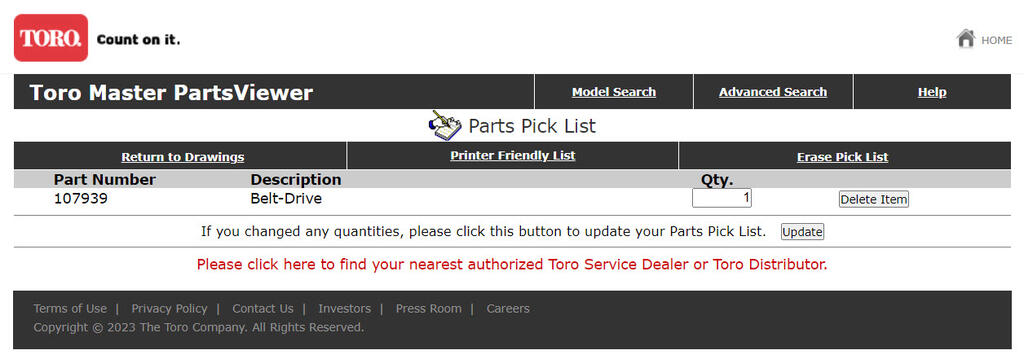

HorseFixer 2,015 #1 Posted December 1, 2023 I Was wanting to replace the drive belt on the Snow Chucker this year Toro list it as a Part #107939 I have a belt in stock a Carlisle shown in the picture but have not tried it for fitment. I tried GOOGLING the belt data but have not been able to find it. It is a green belt and has lasted since winter of 2012 I thought I would be proactive and replace before failure. What has everyone been using Id like to stay with the green belt but I have no Idea where Igot this one from but would like to keep a spare on hand. Does anyone know who sells this Carlisle Belt. Thanks ~Duke Share this post Link to post Share on other sites

squonk 47,419 #3 Posted December 1, 2023 (edited) 107939 83" long X 21/32" width Closest TSC belt is 5L830. Green belt is a Napa 5L830W. Your belt is an inch short. Edited December 1, 2023 by squonk 1 Share this post Link to post Share on other sites
HorseFixer 2,015 #4 Posted December 2, 2023 14 hours ago, squonk said: 107939 83" long X 21/32" width Closest TSC belt is 5L830. Green belt is a Napa 5L830W. Your belt is an inch short. Mike will the 82" belt work? I think the one I have shown is the same size I have had on the tractor when I rebuilt it 13 years ago. I guess when I take the one that is on there off I will stretch it out and compare it with the one in package you see shown in the Pic and if they are the same belt? I see Achto is using an 82" belt also, at least that is what is shown in his link. ~Thanks Duke Share this post Link to post Share on other sites
squonk 47,419 #5 Posted December 2, 2023 It may work with a hydro, but the original is 83". Your 82" belt is 1/32" thinner than original so it will sit a tad deeper in the pulleys so in effect it will be a tad longer. Share this post Link to post Share on other sites
HorseFixer 2,015 #6 Posted December 2, 2023 5 hours ago, squonk said: It may work with a hydro, but the original is 83". Your 82" belt is 1/32" thinner than original so it will sit a tad deeper in the pulleys so in effect it will be a tad longer. Thanks Share this post Link to post Share on other sites
