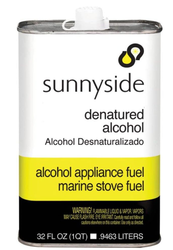

JoeM 10,292 #3 Posted November 28, 2023 2 hours ago, bo dawg said: How do some of you guys go about prepping tractor parts/pieces for painting during the cold months? After sanding I use 50/50 alcohol and water as a wipe down prior to paint. Drys in minutes. As far as painting the shop is kept warm and I set up saw horses with a make-shift area with a plastic drop cloth and a space heater inside to warm the metal parts a bit. I really avoid painting critical parts on very cold days that need a first class job. I get those ready and then cover with plastic and wait for that warm spell. I use very little spray bombs and I warm up the cans in front of the heater prior to paint. 2 Share this post Link to post Share on other sites
