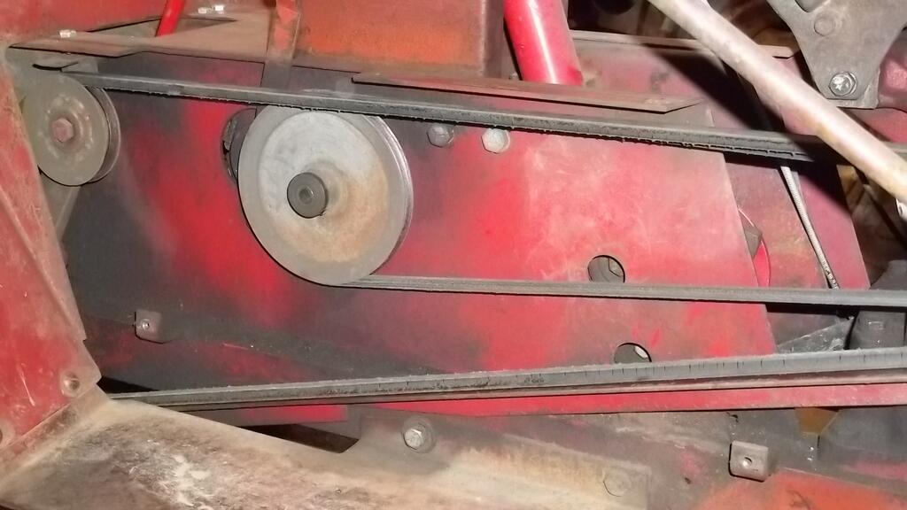

peter lena 9,557 #6 Posted November 28, 2023 @DCwom there is a idler pulley in that set up , frayed belt suggests , bearing failure , bearing starts to bind up , causing incremental stop / start , bounce , another thing is any / all related dry rusty movement areas . penetrating spray , makes the rust run out , personally if I were , draining a trans axel / storage , like a high mileage atf fluid , for a recovery base point , move it around for initial soaking effect , also love KROIL additive for recovery . pete Share this post Link to post Share on other sites
DCwom 78 #7 Posted November 29, 2023 10 hours ago, peter lena said: @DCwom there is a idler pulley in that set up , frayed belt suggests , bearing failure , bearing starts to bind up , causing incremental stop / start , bounce , another thing is any / all related dry rusty movement areas . penetrating spray , makes the rust run out , personally if I were , draining a trans axel / storage , like a high mileage atf fluid , for a recovery base point , move it around for initial soaking effect , also love KROIL additive for recovery . pete My 1st thought was gear oil as @Pullstart suggested, but I do have a couple quarts of unused ATF fluid heading for the county hazardous waste collection site that I could flush with. Since it doesn't move I don't know if there is any value in pouring that through between the initial oil drain and new gear oil. Maybe I could throw a rope on it and pull it around the yard with the Raider to splash it around? Something moves in the transmission even in neutral, right? 1 1 Share this post Link to post Share on other sites
