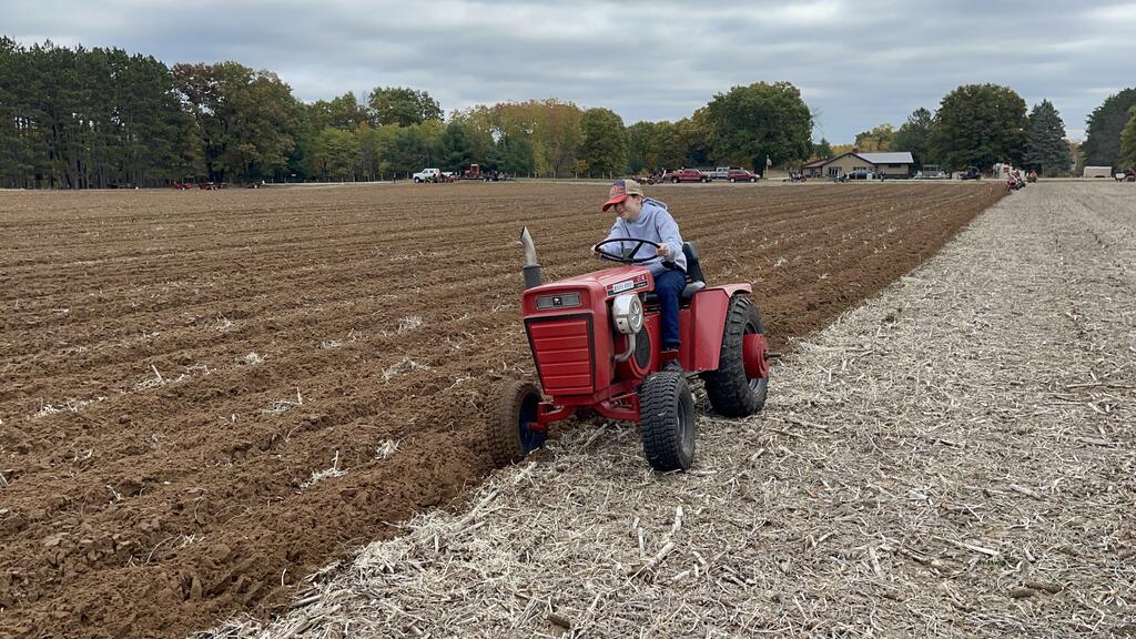

PeacemakerJack 10,873 #3 Posted December 2, 2023 Rick-I’m not sure why the whine but Zach’s is working good so far. He pulled a furrow plow around Jim’s plow day for about 3 hours without any incident. In our case, we are just going to continue to use it until it starts lacking the lugging power that it currently possesses… 2 Share this post Link to post Share on other sites
