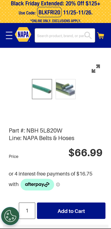

Jon Paulsen 291 #26 Posted November 27, 2023 Quote NAPA belts may very well be usable but the pricing here is FAR MORE EXPENSIVE than getting a Toro Wheelhorse belt online. They do offer deferred payments, Eric 1 Share this post Link to post Share on other sites

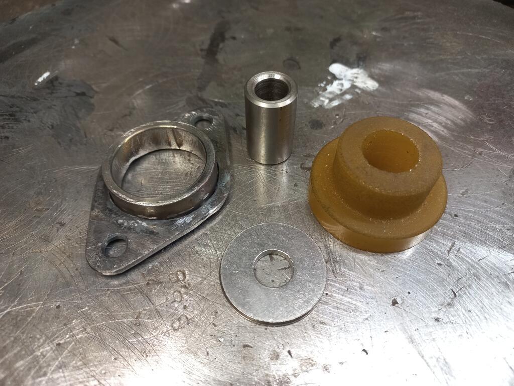

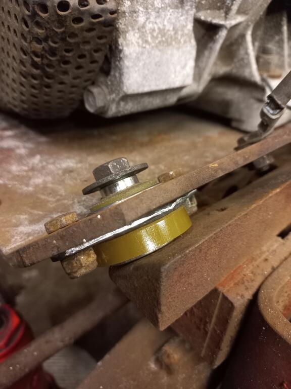

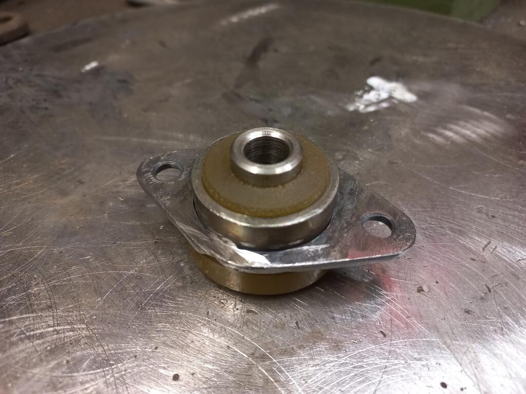

sjoemie himself 3,158 #27 Posted November 28, 2023 (edited) Here's what I made. Some scrap and polyurethane material. These have some give to them. About the belts.. in the Netherlands we have a website called 'Kramp' where you can buy a whole range of (garden)tractor parts. That where I got my belts. Edited November 28, 2023 by sjoemie himself 6 Share this post Link to post Share on other sites

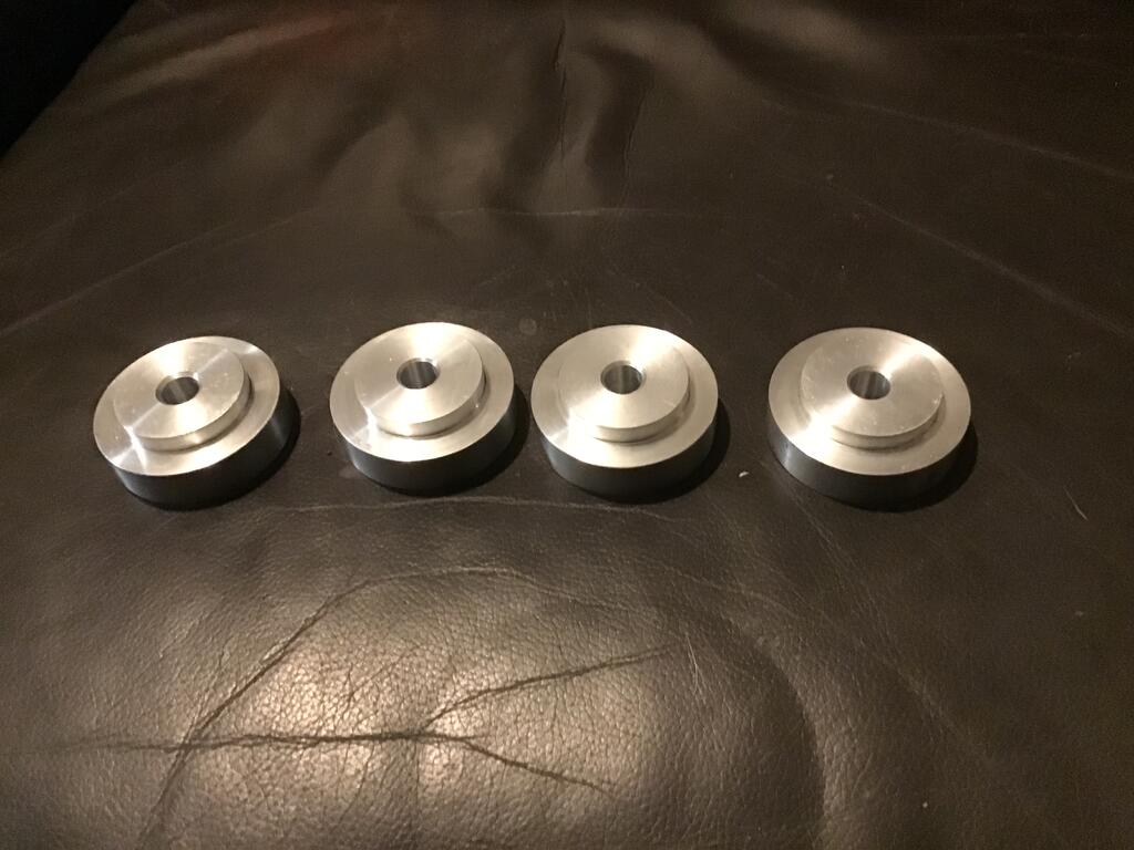

Geoff Cornwall 75 #34 Posted December 12, 2023 The Aluminium bar stock i ordered finally arrived so i made these spacers today , the idea and dimensions i found here on the forum , but i cant find it again to thank whoever origionally posted them . Im now hoping for some dry weather and daylight to get out and start fittiing ! 6 Share this post Link to post Share on other sites
23 Reo 238 #35 Posted December 13, 2023 Excellent, nice work! 2 Share this post Link to post Share on other sites
Geoff Cornwall 75 #36 Posted December 18, 2023 Have fitted the solid mounts , new belt and spring , what a difference ! Thanks for all the advice , does the new belt take a while to bed in? 1 Share this post Link to post Share on other sites
