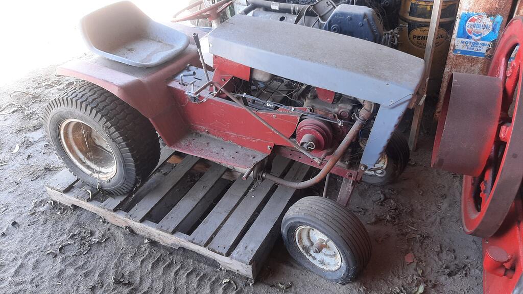

Joe leonardo 164 #1 Posted November 24, 2023 It says Kohler on the side so I'm guessing it is 12ph? Share this post Link to post Share on other sites
Pullstart 71,098 #2 Posted November 24, 2023 Kohler made 4-16 HP single cylinders. There are spec numbers on the engine telling it’s details, and there should be a tag on the tractor telling it’s model. 1 Share this post Link to post Share on other sites
squonk 47,887 #3 Posted November 24, 2023 That's a big block. So if it's a original unmolested then it's a 10 or 12HP 2 Share this post Link to post Share on other sites

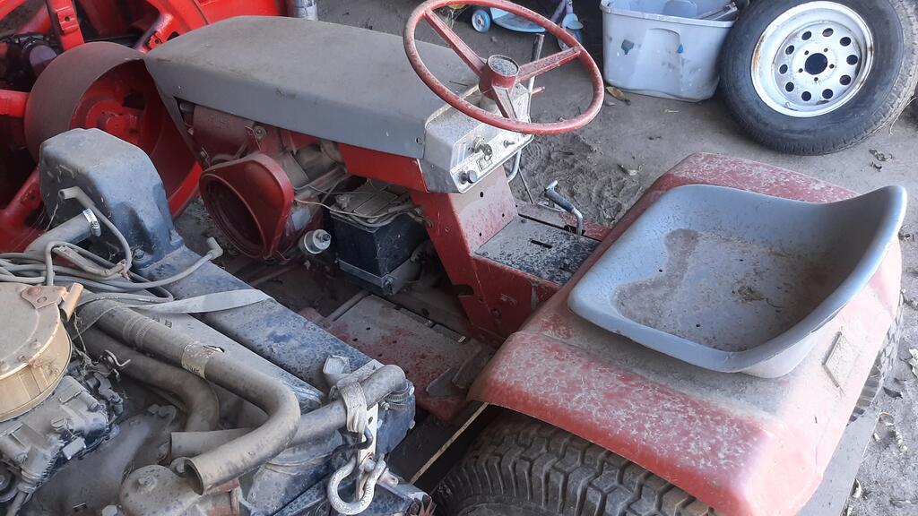

rmaynard 17,527 #4 Posted November 24, 2023 I'd like to see the other side. Couple of clues I see: hydro, starter/generator (missing), floor boards, location of parking brake handle, makes me think it's a 1969 Electro 12. The hood looks wrong, and what's curious is the ignition switch on the left. Share this post Link to post Share on other sites
953 nut 68,508 #5 Posted November 24, 2023 46 minutes ago, rmaynard said: 1969 Electro 12. Electro had an electric PTO clutch, Charger had the manual PTO clutch so it is likely to be a charger. Share this post Link to post Share on other sites
rmaynard 17,527 #6 Posted November 24, 2023 3 minutes ago, 953 nut said: Electro had an electric PTO clutch, Charger had the manual PTO clutch so it is likely to be a charger. Toggle switch on the dash is for the electric clutch. Charger had a Tecumseh. 1971 Charger had a Kohler with new type starter. 1 1 Share this post Link to post Share on other sites
953 nut 68,508 #7 Posted November 24, 2023 1969 Charger 12 I had a few years back had a switch for the headlights, manual PTO clutch and Kohler 12 HP engine with the newer type starter. 2 Share this post Link to post Share on other sites
Joe leonardo 164 #8 Posted November 24, 2023 9 hours ago, rmaynard said: I'd like to see the other side. Couple of clues I see: hydro, starter/generator (missing), floor boards, location of parking brake handle, makes me think it's a 1969 Electro 12. The hood looks wrong, and what's curious is the ignition switch on the left. Share this post Link to post Share on other sites
squonk 47,887 #9 Posted November 25, 2023 Looks like a 1277 with foot boards instead of stirrups. Share this post Link to post Share on other sites
