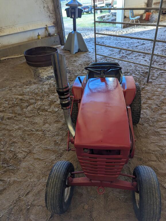

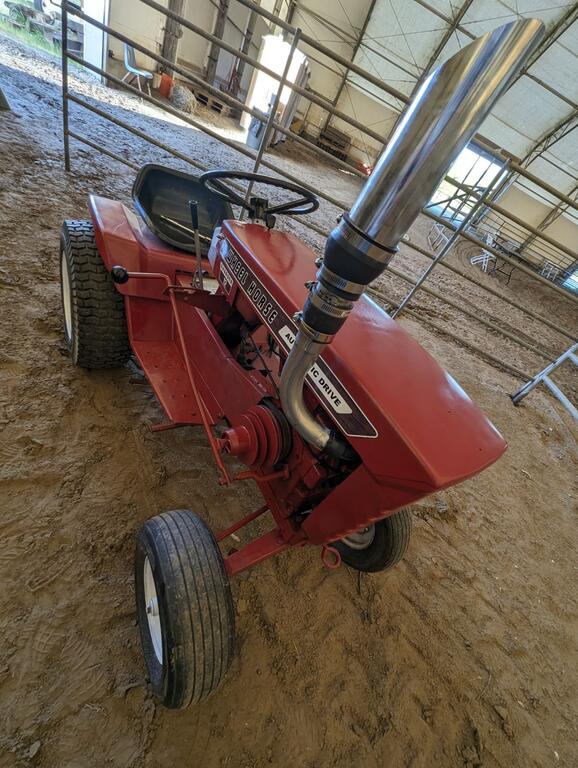

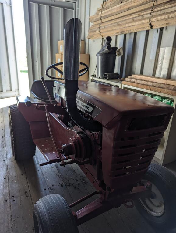

Joe leonardo 164 #178 Posted April 12, 2024 Long time no see but I finally got the tractor restored, I'm a big chrome stack snob and have always liked the look so I put one on and wrapped it with exhaust wrap. I got the new stickers on it and all painted up, completely rewired it. the thing had been sitting in the back of the school shop sense January and I finally got around to getting it back together I don't really know what I'm gonna do when I graduate next month but maybe it will be my family heirloom or I can tote around a little trailer 2 7 Share this post Link to post Share on other sites
