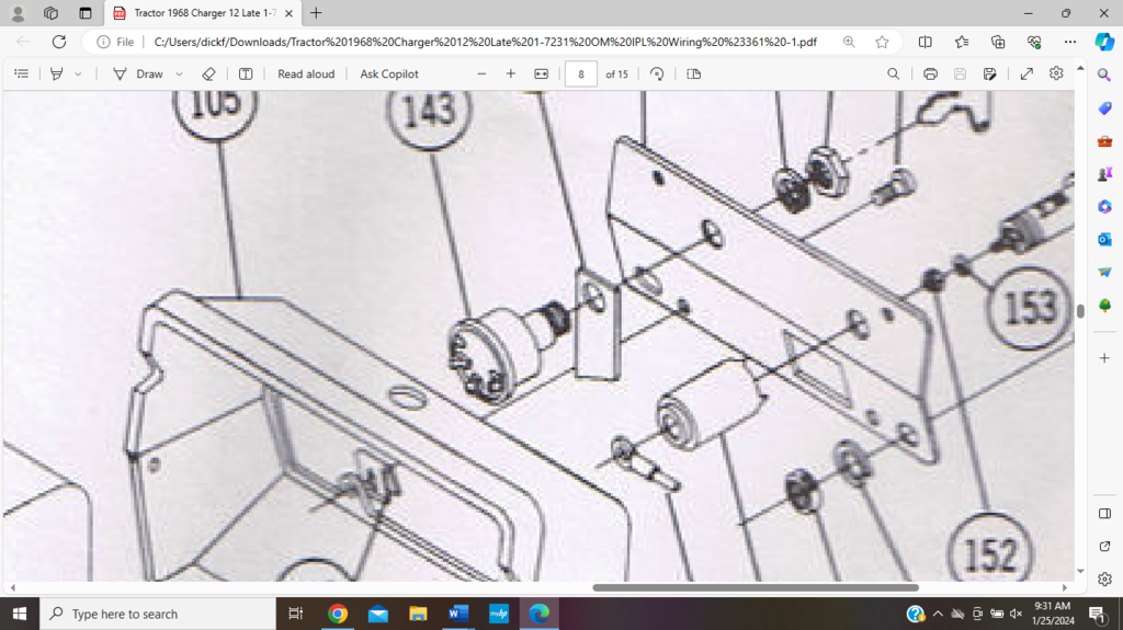

Handy Don 16,917 #151 Posted January 25, 2024 18 minutes ago, Joe leonardo said: I have been but I can't find a photo of how the dash is set up Yeah, I realize that many of those early OMs didn’t show the dash. Share this post Link to post Share on other sites
953 nut 67,253 #152 Posted January 25, 2024 15 hours ago, Joe leonardo said: Anybody have a photo of what a 1968 charger/raider dash looks like? This shot from the 1968 Charger Owner Manual Illustrated Parts List (IPL) shows it from the back side, appears to be identical to the one I posted of Jim's dash. Share this post Link to post Share on other sites
Joe leonardo 164 #153 Posted January 25, 2024 2 hours ago, 953 nut said: This shot from the 1968 Charger Owner Manual Illustrated Parts List (IPL) shows it from the back side, appears to be identical to the one I posted of Jim's dash. Does the gen light go where the lighter is? Share this post Link to post Share on other sites
953 nut 67,253 #154 Posted January 25, 2024 11 minutes ago, Joe leonardo said: Does the gen light go where the lighter is? Use this picture for the generator light location. 1 Share this post Link to post Share on other sites

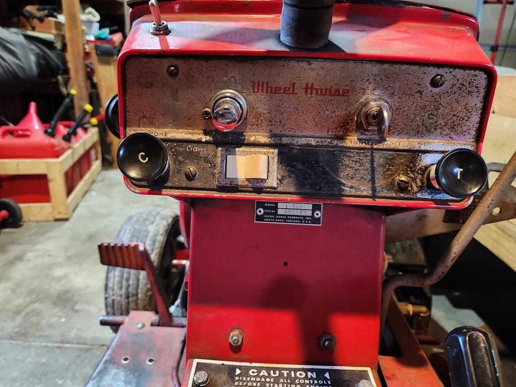

Roger R 473 #156 Posted January 25, 2024 Here is the dash on my 1968 Charger 12. No Starter / Generator, It has an alternator. No charge light. 1 Share this post Link to post Share on other sites
Joe leonardo 164 #157 Posted January 25, 2024 10 minutes ago, Roger R said: Here is the dash on my 1968 Charger 12. No Starter / Generator, It has an alternator. No charge light. Well mine unfortunately is special so I'll just replace the lighter with the gen light I don't smoke cancer sticks anyways 1 Share this post Link to post Share on other sites

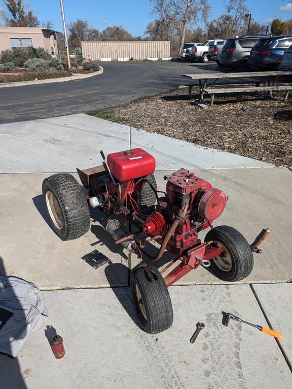

Joe leonardo 164 #162 Posted January 26, 2024 So that stupid foot warmer really bothers me but I don't know how to get it off I'm mucho afraido that it with crack the head which would be no Bueno Share this post Link to post Share on other sites
Joe leonardo 164 #163 Posted January 26, 2024 Also what muffler should I get for it? Share this post Link to post Share on other sites
ebinmaine 79,535 #164 Posted January 26, 2024 2 hours ago, Joe leonardo said: So that stupid foot warmer really bothers me but I don't know how to get it off I'm mucho afraido that it with crack the head which would be no Bueno With a metal saw like a Sawzall, jigsaw, or even a good hand hacksaw blade you can remove the undesirable exhaust without damaging your engine. Cut most of it off leaving a short stub maybe an inch or two. Then using the saw cut a slot inside the pipe. When the pipe is sliced you can use a pipe wrench to crush twist crunch remove the rest of the stub. Then clean up the threads and install a good piece of iron pipe. You'll need an adapter to create the right angle for pointing out from under the hood. 5 minutes ago, Joe leonardo said: Also what muffler should I get for it? That's a personal choice. A Cub style muffler can be used. Also a Gravely type. Either one could be turned down or pointed up for a mini stack. I've done both. Share this post Link to post Share on other sites

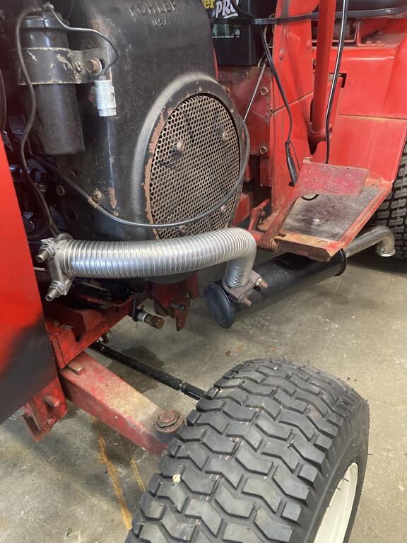

SylvanLakeWH 31,669 #165 Posted January 26, 2024 Or you can use some bendy pipe... worked great for my foot warmer... 1 Share this post Link to post Share on other sites
