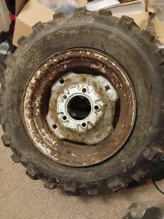

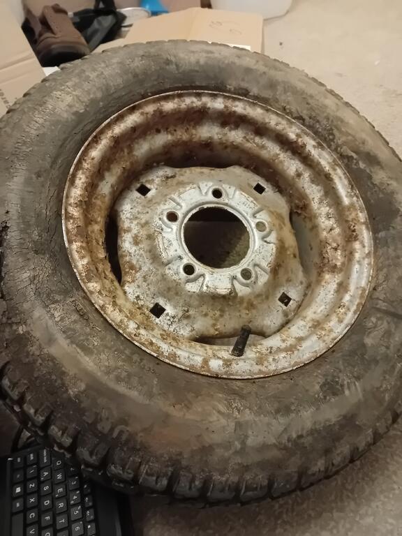

goldeagle 31 #1 Posted November 22, 2023 I have purchased a couple of rear wheels as I want a spare set that I can put Ag tires on, so I have the option to swap between turf and ag tires if I want to. The wheels have seen better days and fairly rusty and beaten up. What is the best approach for doing a fairly quick renovation on these that doesn't involve sending off to be sand-blasted and spray-painted? I was thinking about wire-brushing off any flaky surface and then spraying with white hammerite which can be sprayed directly on a rusty surface. Would that be an ok approach? And should I paint the inside of the wheels too? The edges on one of the wheels are a bit out of shape; if I use tube inners I guess that will remove any issues of the wheel sealing against the rim? Any advice or suggestions appreciated! 2 Share this post Link to post Share on other sites

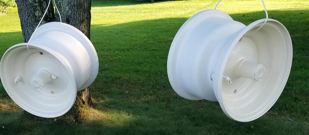

Skwerl58 783 #8 Posted November 22, 2023 This summer I painted a set of wheels for my 1054. I stripped the front with citrus stripper and sanded them to prep. I then used a good primer and sprayed them with Rustoleum Semi gloss Ivory Bisque paint and they turned out great. The rear wheels I cleaned and then wet sanded and sprayed with the same and they turned out looking good too. Time and labor was involved with each but my tractor is a worker and grand kid puller. I thought about a sand blaster but I had time to do it myself so I did. The electrolysis is an intersting way to clear the rust and lots will have a lot of the stuff to do it. Save the wheels if they are salvageable and you will be glad you did! 2 Share this post Link to post Share on other sites

Brockport Bill 2,199 #10 Posted November 22, 2023 i have used scaler, various grinders, some hand sanding, etc but very best decision for any wheel with more than minor rust is definately sand blast -- looking at your photos of rusty rims i would certainly send them to blaster --- i use professional blaster -- it costs some cash but considering the long term use and benefit the sand blasting is best decison for labor time, the mess, return on $$ investment, etc 3 Share this post Link to post Share on other sites

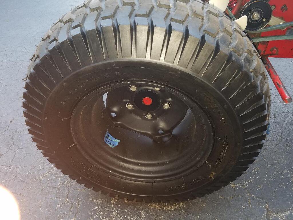

peter lena 9,712 #18 Posted November 23, 2023 @Brockport Bill have a good turkey day ! notice in your wheel picture , the idler pulley appears to have a wide rubber side shield on the bearing? if you have not done it already , chance to do a RE GREASE on that . idler pulleys consistently fail due to undersize bearings , and wrong lubricant , Lucas 550 drop point , green grease , makes them bombproof , turkey stuffing , Pete 1 Share this post Link to post Share on other sites
