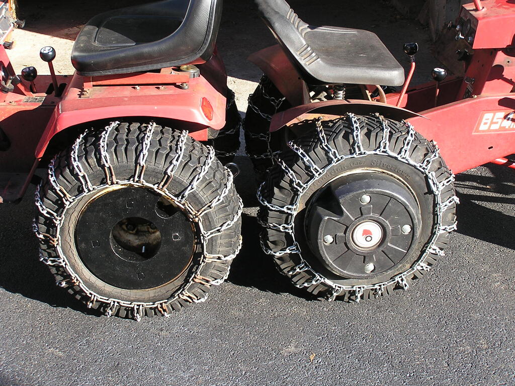

ri702bill 12,475 #8 Posted November 22, 2023 (edited) 9 hours ago, Rob J. said: I recommend tire fill and steel wheel weights. Keep your weight around the axle instead of behind the axle. Cheesy? I’ll take a WH over any of them. Like Eric said get an axle mounted hitch and you’ll pull anything you need to just make sure you can stop. 😉 I agree with both of Rob's comments - i"ll eleborate a bit..... The BEST place to add weight in the rear is in and on the wheels, not hanging it on the frame or Unidrive. Why?// - because I'm the guy that gets to prematurely open the Unidrive up to change worn out axles, bearings, and seals. My C81 has fluid filled tires (30 lbs each), 2 link chains (20 lbs each) ans two castiron weights (a 75 pounder and a 20 - 95 pounds each.) I have added close to 300 pounds for traction - NONE of it in the "wrong" place. You need to be SURE you can stop with the added weight and the weight of a plow or snowblower. Inspect the brake drum, lining, and seal An oily brake is just asking for trouble. Edited November 22, 2023 by ri702bill 6 Share this post Link to post Share on other sites
