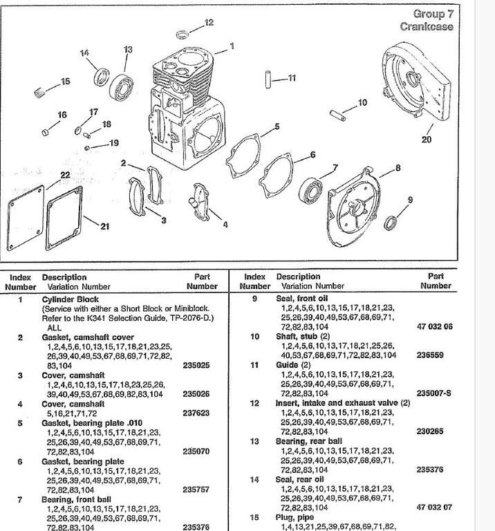

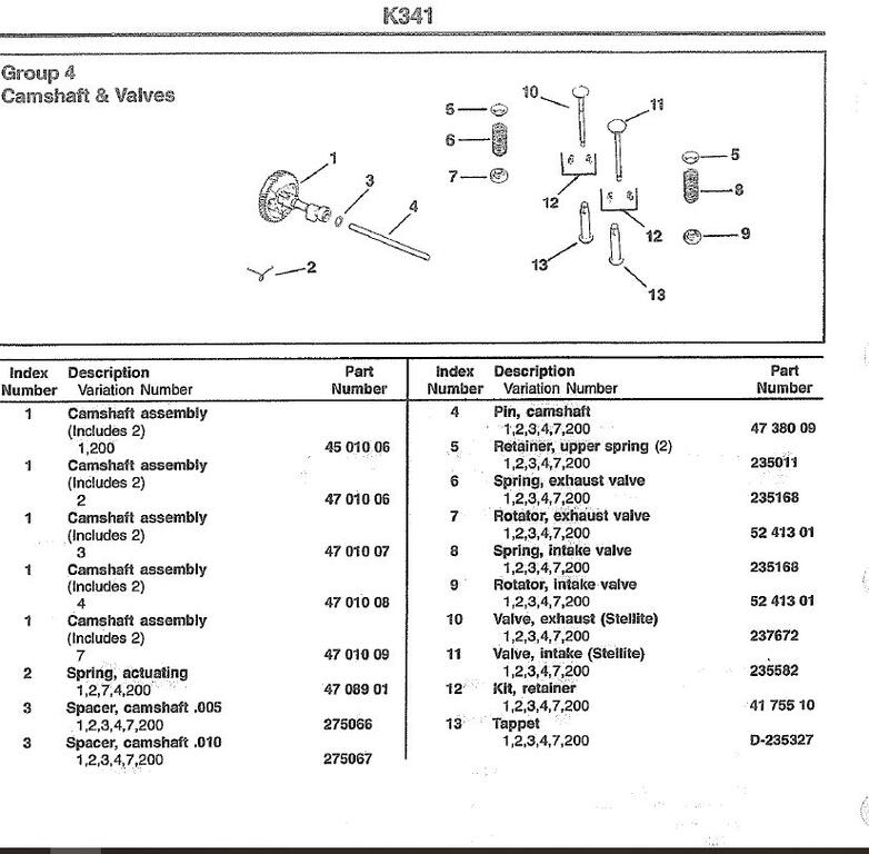

goldeagle 31 #26 Posted December 16, 2023 By the way, can anyone point me in the direction of finding a part number for the exhaust valve for a K341? I can't see any parts list in the manual Share this post Link to post Share on other sites
pfrederi 21,215 #27 Posted December 16, 2023 2 hours ago, goldeagle said: By the way, can anyone point me in the direction of finding a part number for the exhaust valve for a K341? I can't see any parts list in the manual 2 Share this post Link to post Share on other sites

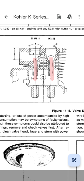

953 nut 69,726 #28 Posted December 17, 2023 You may want to give the valve guide a close inspection also, the bent valve could have damaged it. 4 Share this post Link to post Share on other sites
goldeagle 31 #29 Posted December 19, 2023 On 12/17/2023 at 1:30 PM, 953 nut said: You may want to give the valve guide a close inspection also, the bent valve could have damaged it. Which part is the valve guide? I can't see a valve guide listed in the exploded diagram that pfrederi posted Share this post Link to post Share on other sites

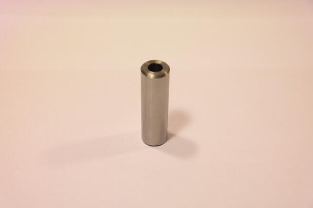

RED-Z06 2,720 #30 Posted December 19, 2023 4 minutes ago, goldeagle said: Which part is the valve guide? I can't see a valve guide listed in the exploded diagram that pfrederi posted Its the tube pressed into the block that the valves ride in. 1 Share this post Link to post Share on other sites
rmaynard 17,612 #31 Posted December 19, 2023 (edited) 14 minutes ago, goldeagle said: Which part is the valve guide? I You can search eBay for Kohler K-series valve guides. Don't need a part number. Edited December 19, 2023 by rmaynard 1 Share this post Link to post Share on other sites
pfrederi 21,215 #32 Posted December 19, 2023 The valve guides (#11) are part of the crankcase 2 Share this post Link to post Share on other sites
