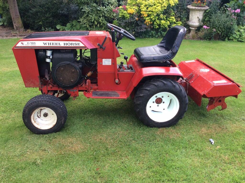

goldeagle 31 #1 Posted November 20, 2023 Hopefully 'blew up' is an exaggeration but it did go bang and stopped working. I've only had my C-165 for a few weeks. I have been out on my field with the tiller attachment, rotovating some ploughed soil. Have a feeling I was probably putting the engine under a lot of strain using the tiller in wet soil, getting caked in mud. It had been doing fine for several hours, and then after a rest I started again, and just as I lowered the tiller and went to set off, there was a loud BANG from the engine, it looked like something shot out of the engine/exhaust on the left side (maybe a spark/flame??) and the engine died. Now, when I turn the ignition the engine fan turns but it won't properly 'start' (sorry, don't know the technical terms). It's almost like gas isn't getting to the engine or something. Anyway, not knowing anything about these tractors I was hoping some of you could give me your opinion: 1. What am I likely to have done to the engine? 2. Is it likely to be repairable or have I destroyed it? 3. Any tips on what I should look at or test to confirm the issue? Thanks in advance 5 Share this post Link to post Share on other sites

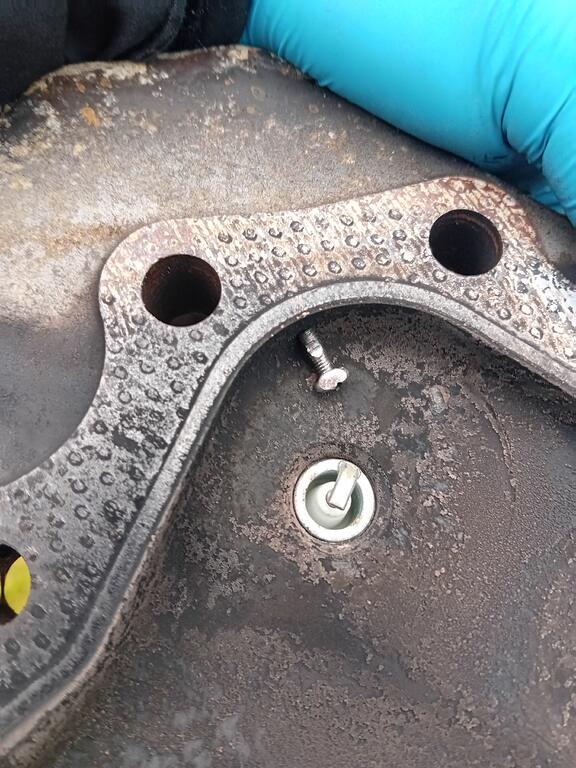

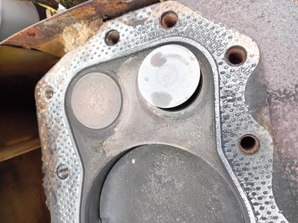

goldeagle 31 #17 Posted December 10, 2023 I thought I would report back and get some advice before I do anything else. I removed the head and found a small screw embedded in the underside. One of the valves (if that is the correct term) is bent. It looks like somehow a screw has ended up in the head, the valve has hit it embedding it in the head, and breaking/bending the valve. Has anyone seen this before? I turned the engine by hand and the large piston moves up and down. One of the valves also moves up and down but the bent one does nothing. What should be my next step to check? Do I have to remove the entire engine or can I work on it whilst still fitted to the tractor? 1 1 Share this post Link to post Share on other sites
RED-Z06 2,720 #18 Posted December 10, 2023 Does the exhaust valve tap back down at all? Share this post Link to post Share on other sites
goldeagle 31 #19 Posted December 10, 2023 30 minutes ago, RED-Z06 said: Does the exhaust valve tap back down at all? not really, that picture isn't very good - the shaft seems to be bent (or else something has happened at the far end), the valve top is actually only lifted up on one side, the other side is actually already touching the engine, so can't move down any further. When I turn the engine, at a certain point the exhaust valve does loosen enough that I can wiggle it a bit and it will rotate, but that is all Share this post Link to post Share on other sites
RED-Z06 2,720 #20 Posted December 10, 2023 (edited) 24 minutes ago, goldeagle said: not really, that picture isn't very good - the shaft seems to be bent (or else something has happened at the far end), the valve top is actually only lifted up on one side, the other side is actually already touching the engine, so can't move down any further. When I turn the engine, at a certain point the exhaust valve does loosen enough that I can wiggle it a bit and it will rotate, but that is all Oh okay then you just need a valve and lap it in to the old seat if its still in good shape. Check your carb, filter base for missing hardware Edited December 10, 2023 by RED-Z06 2 Share this post Link to post Share on other sites
oliver2-44 11,849 #21 Posted December 11, 2023 You should not need to pull the engine. To make it easy to work on I would remove the hood. Then pull the carburetor and the cover below it to get to the valve springs. You will need a small engine valve compressor to remove the valve. 2 Share this post Link to post Share on other sites
kpinnc 19,107 #22 Posted December 11, 2023 (edited) 15 hours ago, goldeagle said: Has anyone seen this before? Yes. This is the reason that both choke and throttle plates use brass screws. I had one get sucked into the engine, and brass screws just flatten out- though they definitely make some noise until you shut the engine off. Looks like you lost one of the screws from the air filter back plate. Sorry @RED-Z06 already mentioned it and I didn't see that. Congrats on minimal damage. Could've been really bad! Edited December 11, 2023 by kpinnc 2 Share this post Link to post Share on other sites
goldeagle 31 #23 Posted December 11, 2023 1 hour ago, kpinnc said: Yes. This is the reason that both choke and throttle plates use brass screws. I had one get sucked into the engine, and brass screws just flatten out- though they definitely make some noise until you shut the engine off. Looks like you lost one of the screws from the air filter back plate. Sorry @RED-Z06 already mentioned it and I didn't see that. Congrats on minimal damage. Could've been really bad! Thanks that's what I was wondering where the screw could have come from. I was surprised it looked so clean and shiny, no corrosion or oil on it. Is that the air filter on the carburetor or somewhere else (sorry still finding my way around the engine and part names). Hopefully it is just minimal damage as you say. I will check carb and also get access to valve springs and see how it is looking. Share this post Link to post Share on other sites

goldeagle 31 #25 Posted December 16, 2023 Managed to get access to the valve springs today, it looks ok from what I can tell. As expected, the exhaust valve is stuck and doesn't raise/lower properly. I will order an exhaust valve (as well as some new gaskets) so that I can swap it out. I just need to work out how to replace a valve now! Added a better photo of the bent valve top and also a link below to a video of the valves whilst I am hand-cranking the engine 2 Share this post Link to post Share on other sites
