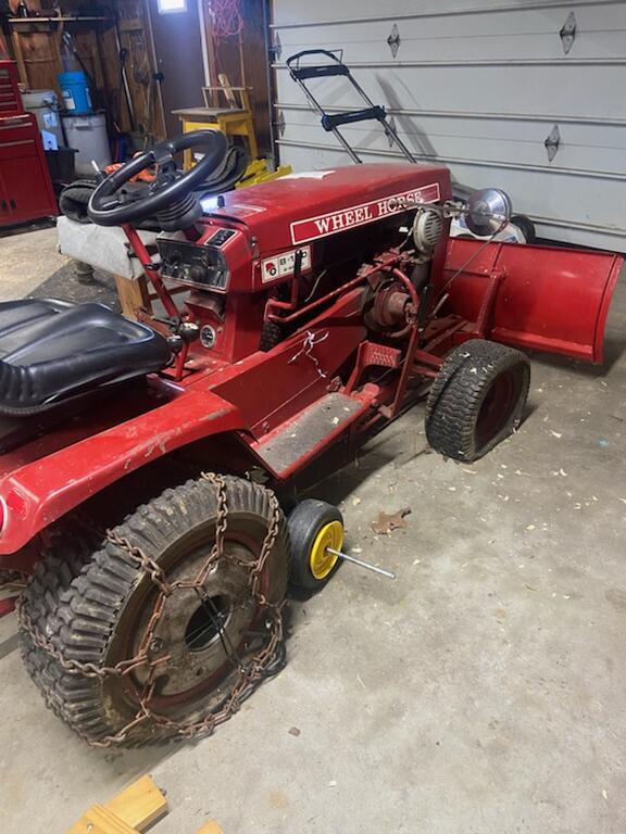

CJTractorKid 26 #1 Posted November 20, 2023 Hello, I am a 9 year old kid (with my mom's help and permission) looking for some information and advice. My neighbor gifted me a Wheel Horse B-100 tractor and plow to try to fix up or sell. I have loved tractors since I could remember. Unfortunately, my parents don't know much about them, and aren't overly good at fixing things. I am trying to decide if I should try to fix this one up or sell it whole or for parts? Eventually, I am hoping to have a lawncare/snow plowing business in a couple years when I'm old enough to not scare the neighbors. I am also hoping to buy a dirt bike some day. Can you give me an idea of how much my tractor is worth? Or how much it might take to fix it up? Thanks! 4 9 1 Share this post Link to post Share on other sites

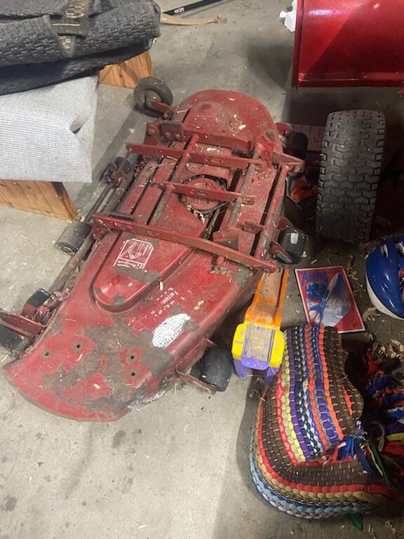

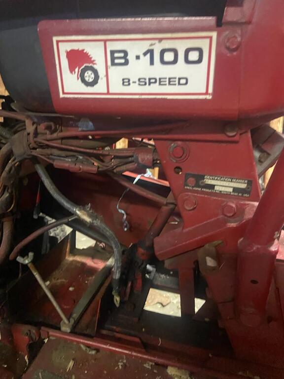

Ed Kennell 46,555 #2 Posted November 20, 2023 to the CJ and CJs Mom. So nice to see someone your age interested in these tractors. That is a very nice looking B-100. It appears to have been taken care of by the previous owner. The 42" side discharge deck looks good and the tractor has the sleeve hitch and cast iron wheel weights. All add value to the outfit. Not knowing the condition of the engine, it is very difficult to answer your question as to how much it will cost to get it running. These little tractors with the 10 HP engine and 8 speed transmissions are almost bullet proof and it normally only requires a new battery $50 and a good cleaning of the entire fuel delivery system to get them running. With more info and specific questions, there are many members on the forum that will be very pleased to help you with your project. 2 9 Share this post Link to post Share on other sites

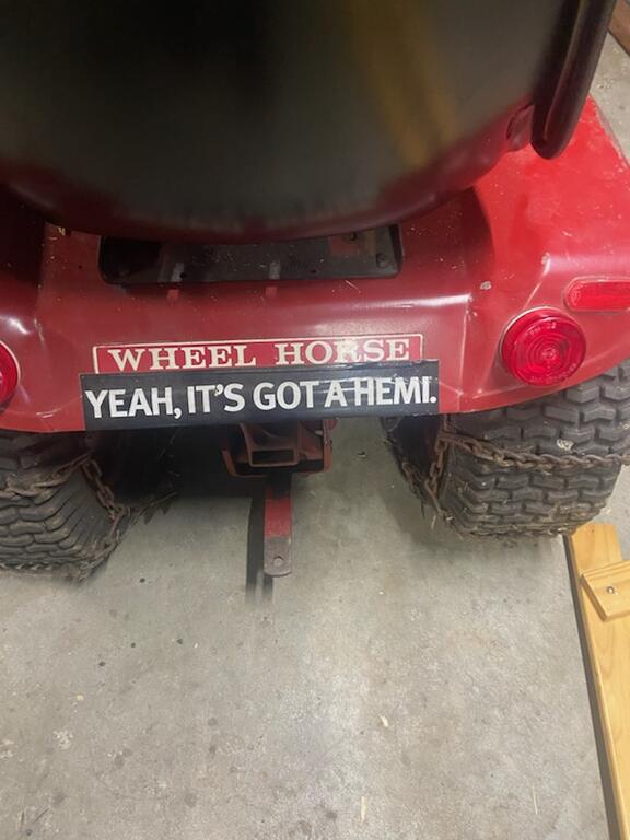

Pullstart 70,656 #5 Posted November 20, 2023 That’s quite the muffler you have there. It looks like a spark arrestor. Any info from the previous owner about it’s past life? 1 Share this post Link to post Share on other sites

rmaynard 17,418 #7 Posted November 20, 2023 Being the current owner of a 1977 B-100, and having owned a 1976 B-100 like yours, I can tell you that they are the best looking tractor of Wheel Horse's entire fleet (I am biased though). If after you put a battery in it, air up the tires, and see how it runs, I would value the B-100 alone at around $500.00. I sold one two years ago for $400.00 with a snow plow, a dead battery, and a lot of rust. Yours with a snow plow, mowing deck, cast iron wheel weights, and what looks like good paint is worth every bit of $950.00 to $1100.00 to the right buyer. BUT...and this is a big but, I would not sell it just to be able to buy a 4-wheeler. I have two grandsons who have gone through two mini bikes, two four-wheelers, and currently two go-carts. But their Wheel Horse tractor will still be around working long after the "toys" are gone. 8 Share this post Link to post Share on other sites

RED-Z06 2,718 #15 Posted November 21, 2023 5 hours ago, Pullstart said: That’s quite the muffler you have there. It looks like a spark arrestor. Any info from the previous owner about it’s past life? Might be a 12v horn? 2 Share this post Link to post Share on other sites
RED-Z06 2,718 #16 Posted November 21, 2023 These are simple enough to maintain and do most repairs with a fairly basic tool kit. My C100 sat 15+ years and was running with just fresh fuel and a fresh battery. Yours could need the points filed, or a carburetor cleaning..but its an excellent basis to operate a plowing business with. If you've got the arm to lift the blade 2 Share this post Link to post Share on other sites
