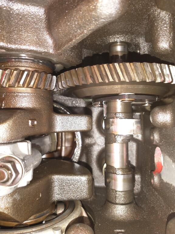

squonk 48,069 #9 Posted November 20, 2023 (edited) I got this K341 with 700 hrs. on it. Oil was blacker than black and the engine smoked like a fish. Nothing but Rotella 30W after I got it. Stopped smoking shortly after but would burn a qt. a month. At 1000 hrs. I started hearing a noise and tore it down. Found a broken piston skirt. (You can see the missing piece on the piston.) But the engine was spotless with using the Rotella Edited November 20, 2023 by squonk Share this post Link to post Share on other sites
