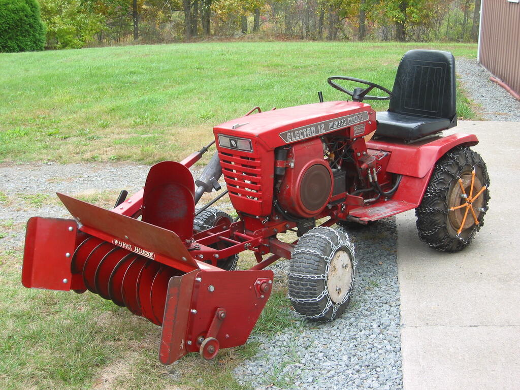

pfrederi 21,043 #2 Posted November 19, 2023 This is a single stage 1 1 Share this post Link to post Share on other sites
Jake the 312-8 72 #3 Posted November 19, 2023 How can u tell, thanks Share this post Link to post Share on other sites

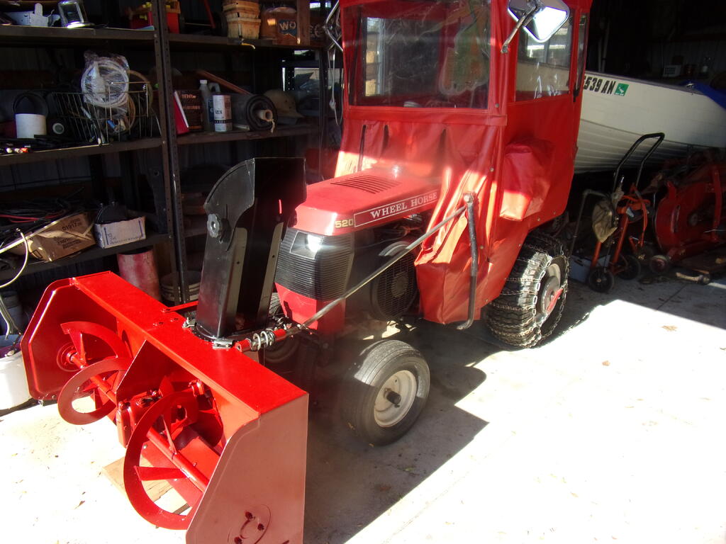

Ed Kennell 46,978 #4 Posted November 19, 2023 This is a two stage. 2 1 Share this post Link to post Share on other sites
Ed Kennell 46,978 #5 Posted November 19, 2023 1 hour ago, Jake the 312-8 said: How can u tell, thanks The two stage has an impeller located behind the auger. 2 Share this post Link to post Share on other sites
Achto 32,345 #6 Posted November 19, 2023 57 minutes ago, Ed Kennell said: The two stage has an impeller located behind the auger. 2 hours ago, Jake the 312-8 said: How can u tell On a single stage blower the auger spins fast and has paddles in the center that throw the snow out the shoot. On a 2 stage blower the auger spins slow and only moves the snow to the center. Behind the auger is a separate impeller that throws the snow out of the shoot. 4 1 Share this post Link to post Share on other sites
