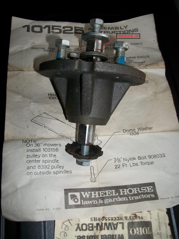

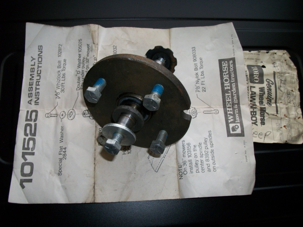

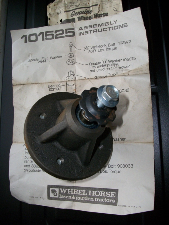

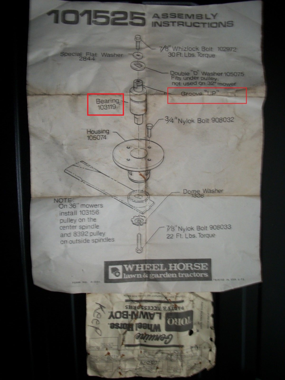

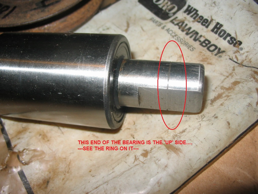

daveoman1966 3,839 #2 Posted November 18, 2023 Presuming you have the 'Double D' spindle assembly, the bearing (#103119) MUST be driven out from the blade side of the spindle. There is a right and wrong way to do this. DO NOT 'hammer in the new bearing---but PRESS it in with force on the outer rim of the 103119 bearing...NOT THE SHAFT!. 2 Share this post Link to post Share on other sites
elcamino/wheelhorse 9,362 #3 Posted November 21, 2023 @daveoman1966 Have you ever posted a copy of those assembly instruction on the forum ? If not could you post them it would be very helpful. Thanks Share this post Link to post Share on other sites
daveoman1966 3,839 #4 Posted November 21, 2023 Not sure where you would want me to post them in Red Square, but knock yoerself out... just copy/paste them. Share this post Link to post Share on other sites
