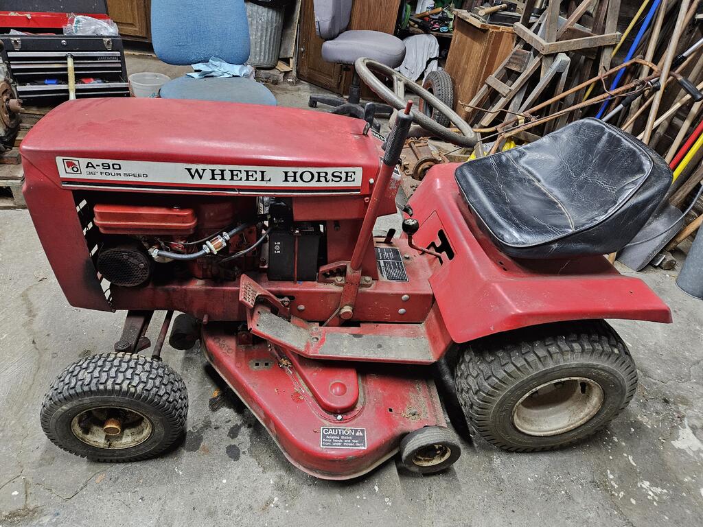

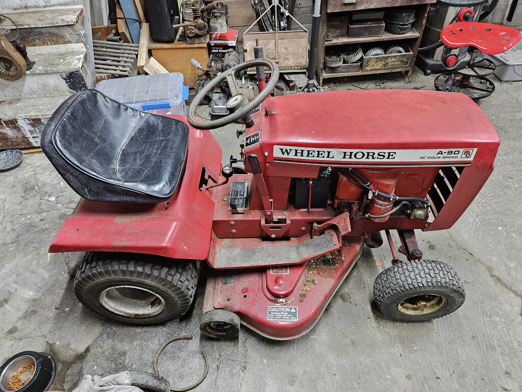

Mike'sHorseBarn 3,594 #1 Posted November 15, 2023 I know these have next to no value, but I got this when dad brought home his 18 auto because it was going to go to the scrapper otherwise. It sat since the late 90's in a shed and honestly I got it running without a lot of issues. It wasn't charging and had a burned out charge coil, so I put a new alternator under the flywheel, rebuilt the carb, new air filter, fuel lines and fluids. It honestly works pretty good for what its is. I was using it in my small yard in town to chop leaves and it didn't skip a beat! It needs new blades on the deck though. Anyone have a part number for those? It has a 36" deck. Since I have more money into it than it's probably worth, I guess I'll have to keep it 3 Share this post Link to post Share on other sites
gwest_ca-(File Mod) 12,343 #2 Posted November 15, 2023 Double-D center hole? 100776 14-1/8" center blade and 100777 12-1/8" left and right blades replaced by 101335 3-blade kit and no longer available from Toro (Hole 5/8in.x3/4in. Double-D) 2017 Oregon catalog part number 91-802 12-1/8" and Gator blade 96-632 12-1/8" still available. 101335 blade set available again from Toro June 4, 2019 2 1 Share this post Link to post Share on other sites

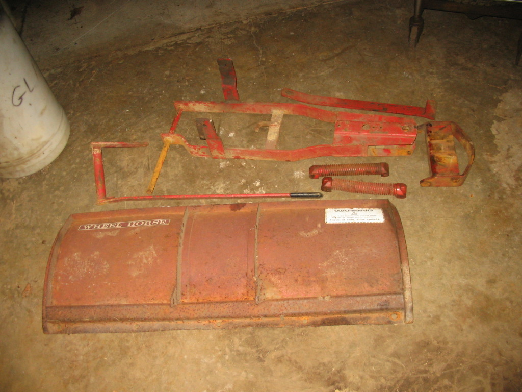

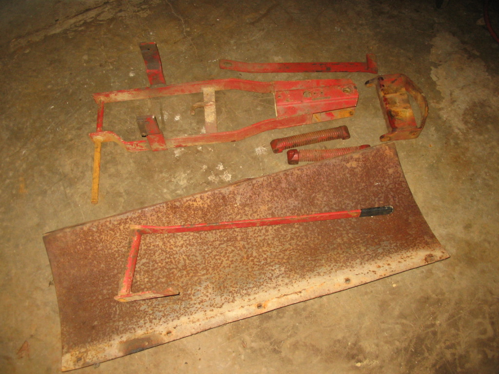

daveoman1966 3,884 #7 Posted November 16, 2023 I have a Snow / Dozer blade for the A-90...near Meadville PA. $70...come and get it. no shipping. The only things missing is the SPRINGS ....and control ROD. Will also fit the A-100. Share this post Link to post Share on other sites
