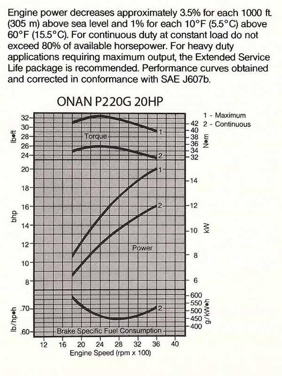

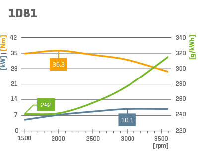

Achto 32,816 #5 Posted November 15, 2023 More info for you. The Onan P220G test out with a maximum torque of 32lbft at 2400RPMs and 20hp at 3600RPMs The Hatz 1D81 tests out at 36.3Nm (26.5lbft) max at 2000RPMs and 10.1kw (13.54hp) max at 3000RPMs 2 4 Share this post Link to post Share on other sites

TJ5208 1,841 #8 Posted November 15, 2023 43 minutes ago, Achto said: More info for you. The Onan P220G test out with a maximum torque of 32lbft at 2400RPMs and 20hp at 3600RPMs The Hatz 1D81 tests out at 36.3Nm (26.5lbft) max at 2000RPMs and 10.1kw (13.54hp) max at 3000RPMs So it's pretty much not worth it. Is there upgrades you can do to the diesel to get more hp and torque? 1 Share this post Link to post Share on other sites
