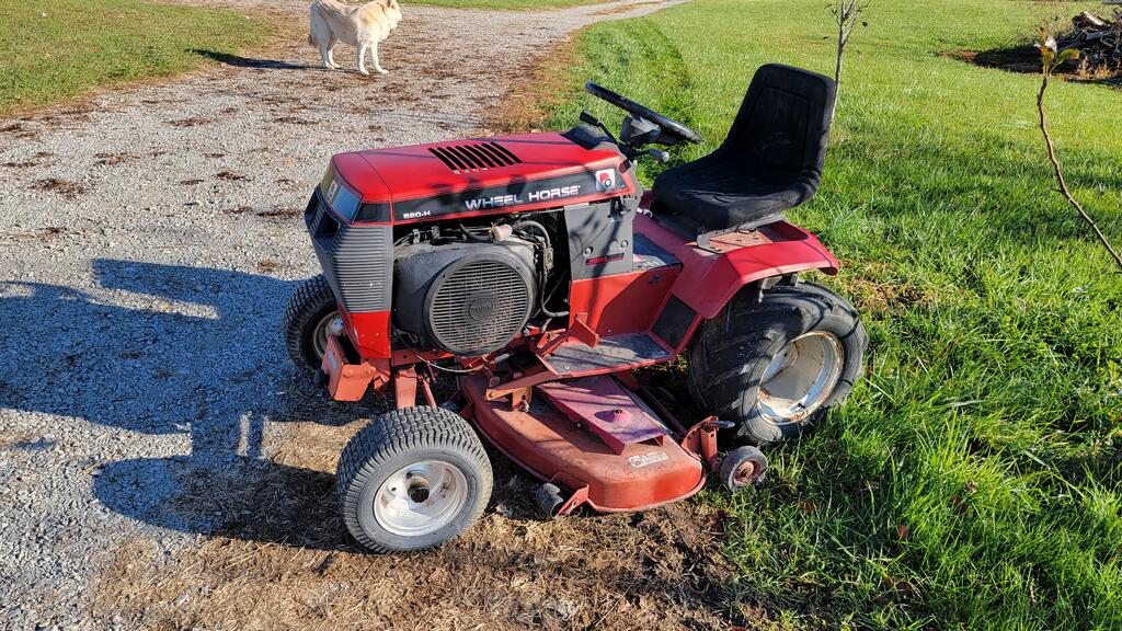

BairleaFarm 344 #1 Posted November 13, 2023 I used to have patience. Not any more. Nothing makes me want to scrap a tractor more than a non starting engine. Especially when it's got fuel, air, spark, and ign module pulses. 1 Share this post Link to post Share on other sites

BairleaFarm 344 #8 Posted November 13, 2023 4 minutes ago, WHX?? said: Me thinks he is just venting on us 'Fish. Go ahead and vent guy that's what we're here for! It is a partial vent but I hate this model of wheel horse so much I'd rather scrap it vrs deal with people trying to buy it. Also I can't stand non runners laying around. No can find a set of plugs. I may pic some up tomorrow on the way home. I do have a little history on this. It was run through the Wheel Horse Stables. Repaint and decals from what I can tell. The guys father bought it from the stables and said he got screwed. Spark issues as the guys son remembers. (He's selling his father's estate). They thought it was the motor and Swapped them from another 520 supposedly. Now who knows what any of this means. 1 Share this post Link to post Share on other sites
