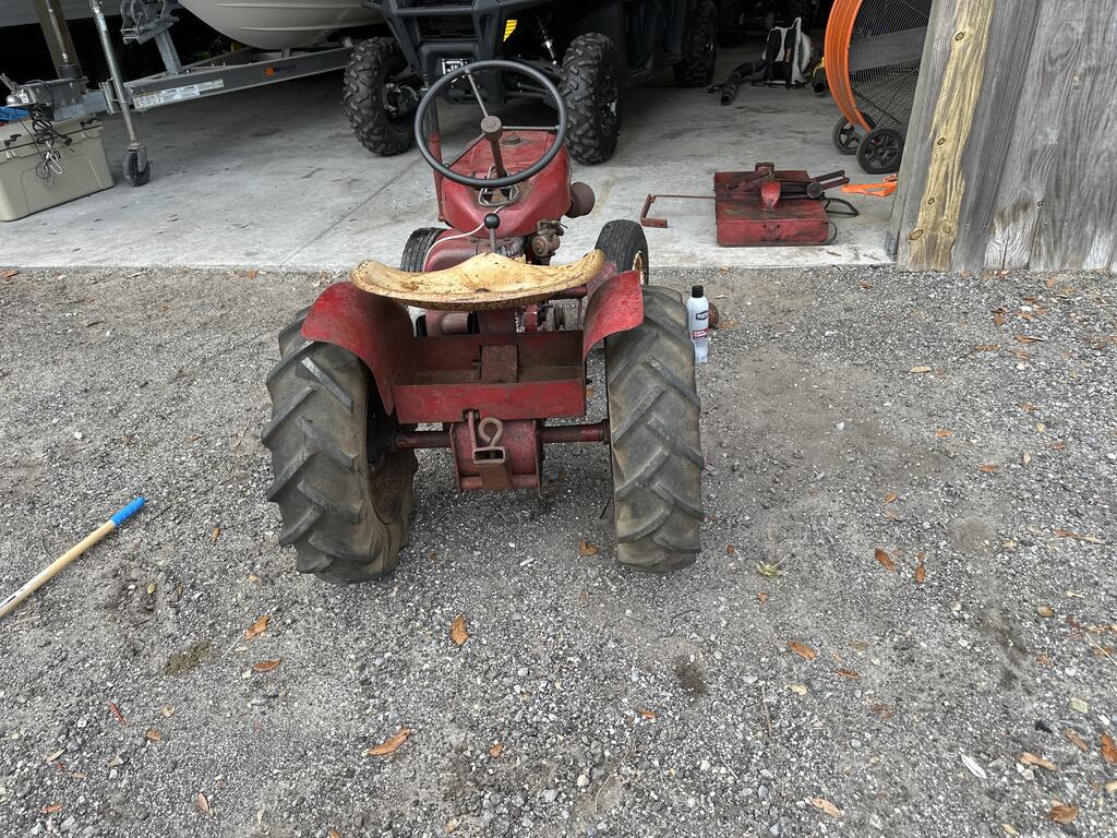

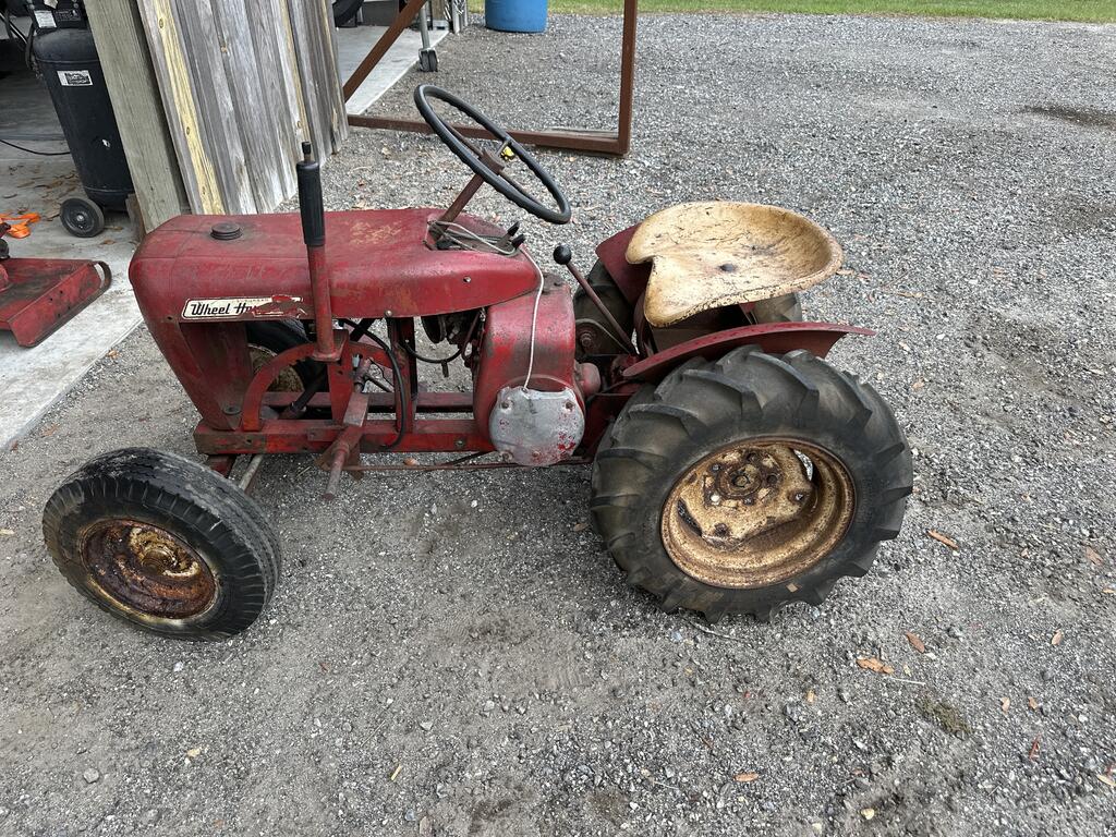

Cody wilkins 4 #1 Posted November 13, 2023 Hey guys I bought my first wheel horse over the weekend from the Florida flywheelers antique tractor show. I was hoping y’all could help me determine the model I bought and what engine it has. Does not run currently but I am going to pull carburetor and give it a good cleaning to see if it will start. Shifter fills a little funky kinda loose and gears seam hard to find. Any info will be appreciated. 2 2 Share this post Link to post Share on other sites

wallfish 18,626 #3 Posted November 13, 2023 (edited) You found a 1960 model 550. Nice Find !!!!! Engine is a H55 Lauson/ Tecumseh if it's original The throttle/choke controls and that belt guard are very nice to have with it as they are common to be missing The engine could be swapped with a Kohler K91 engine and it would be a model 400. The 400 and 550 were the same tractor except for the engines. 550 had the electric start option but it appears the starter is missing. That's the correct mower deck too. It connects into the rear lift as well for lifting it. In front of the shifter is a dog point screw that holds the shifter in place and the shifter also pivots on that point. Loosen to remove and inspect the shifter and screw, maybe post some pics if you notice anything funny with it. It could just be something as simple as tightening that screw. Edited November 13, 2023 by wallfish 2 2 Share this post Link to post Share on other sites
Achto 29,830 #4 Posted November 14, 2023 (edited) Nice looking 1960 Suburban 550. Edited November 14, 2023 by Achto Share this post Link to post Share on other sites

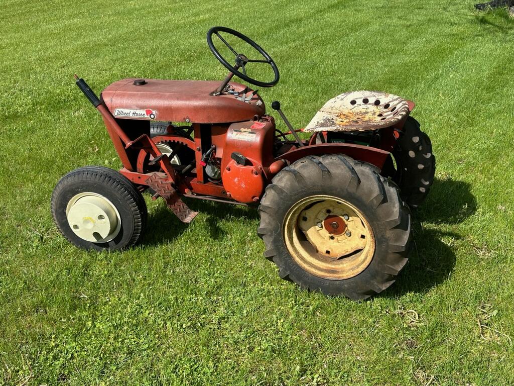

Streetrodchev 966 #5 Posted November 14, 2023 As the others have said, 1960 Suburban 550. I have one also 2 1 Share this post Link to post Share on other sites
Cody wilkins 4 #6 Posted November 14, 2023 Thank y’all for the help. Going to try to get it running. I have a mowing deck for it I would like to put back on it. Share this post Link to post Share on other sites
Cody wilkins 4 #7 Posted November 14, 2023 5 hours ago, wallfish said: You found a 1960 model 550. Nice Find !!!!! Engine is a H55 Lauson/ Tecumseh if it's original The throttle/choke controls and that belt guard are very nice to have with it as they are common to be missing The engine could be swapped with a Kohler K91 engine and it would be a model 400. The 400 and 550 were the same tractor except for the engines. 550 had the electric start option but it appears the starter is missing. That's the correct mower deck too. It connects into the rear lift as well for lifting it. In front of the shifter is a dog point screw that holds the shifter in place and the shifter also pivots on that point. Loosen to remove and inspect the shifter and screw, maybe post some pics if you notice anything funny with it. It could just be something as simple as tightening that screw. I will check it Out tomorrow. Thanks for all the info. The guy I bought it from gave me the original starter just needs to be put back on. Engine has compression and turns over fine so hopefully it will run after a good carb cleaning and a new plug. Share this post Link to post Share on other sites

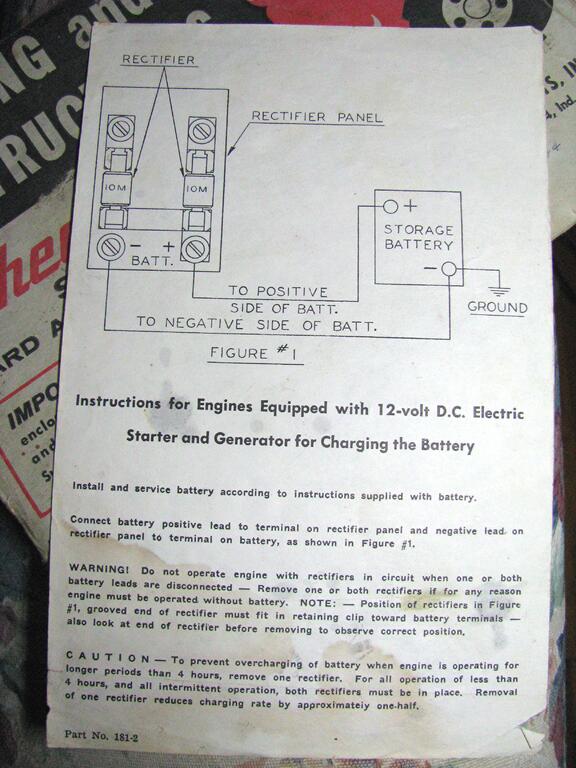

oliver2-44 10,976 #9 Posted November 14, 2023 (edited) Nice original Suburban. Just an FYI. There are some diodes and electrical parts that can be fried if your not careful. Best you read up on them before you put a battery in it. (Rope start is ok). Go to the Manuals Section” and search for Tecumseh H55 and it should bring up some literature about the engine. Edited November 14, 2023 by oliver2-44 Share this post Link to post Share on other sites

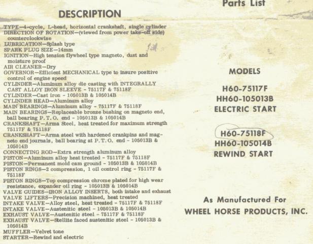

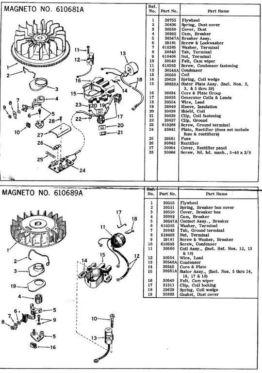

oliver2-44 10,976 #10 Posted November 14, 2023 Here's a link to the Manuals Section/Engines/Tecumseh Note the HH5 and 60 engine are almost identical except one has an oil pump and the other is splash lube. https://www.wheelhorseforum.com/search/?q=tecumseh &quick=1&type=downloads_file&nodes=15 Here's some of the literature on the Tecumseh Share this post Link to post Share on other sites
wallfish 18,626 #11 Posted November 14, 2023 An H55 engine can be verified by looking under the PTO side shaft. An H55 will have an indentation (like a sq hole thingy ) into the case, whereas the H60 will have just an entire flat case. It would be located near/under the belt guard but you may be able to see it without removing the guard. Or post a pic. Hopefully it has spark. If not, the points are under the flywheel and the contacts should be cleaned first. A real PITA working on those is the need to remove the flywheel each time for cleaning the points, condenser, changing the coil, wiring etc. etc. etc. Share this post Link to post Share on other sites
