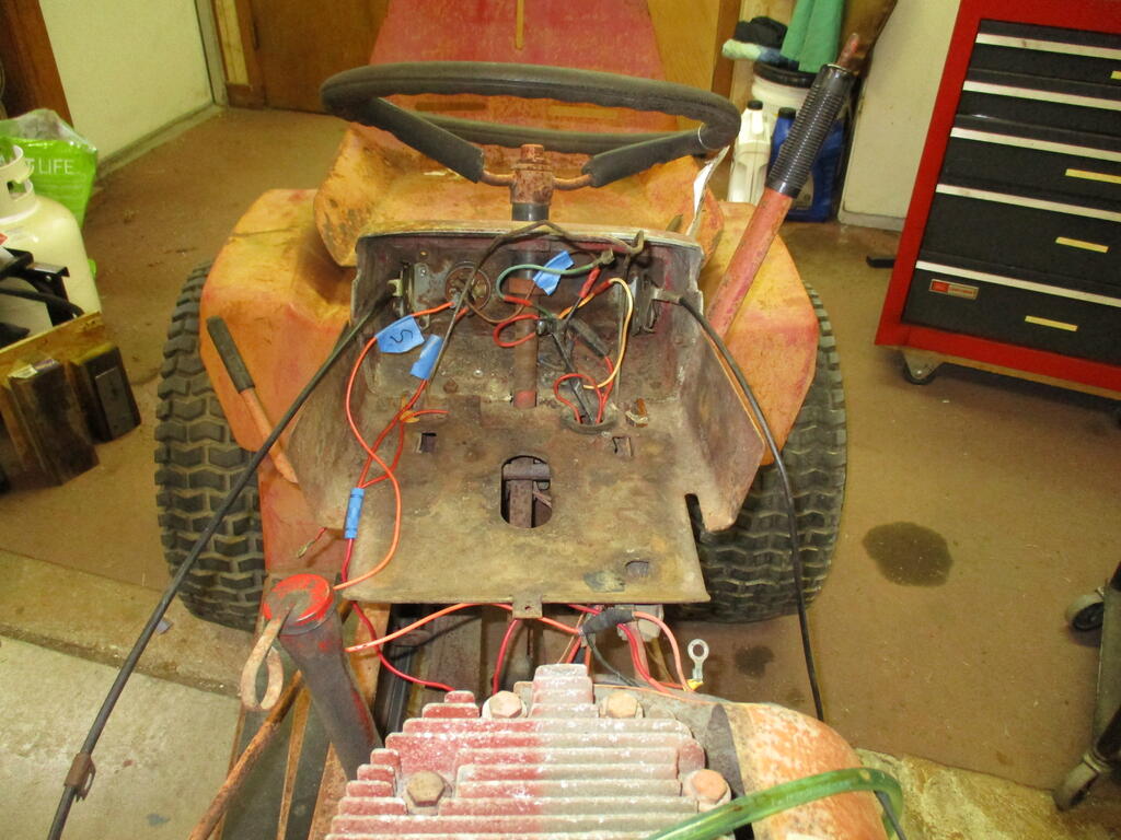

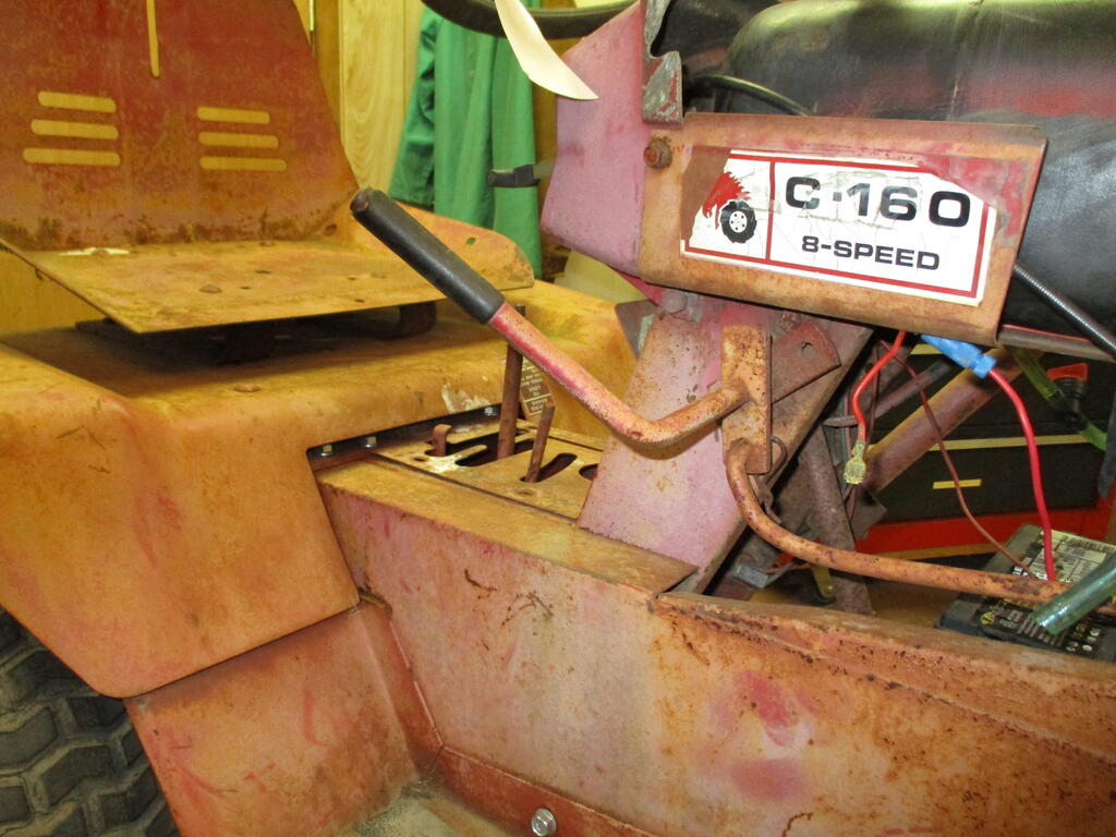

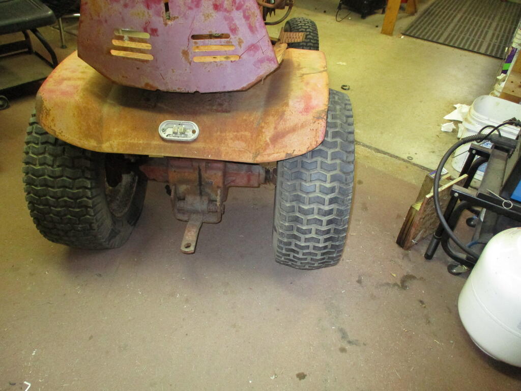

pfrederi 21,145 #1 Posted November 13, 2023 Trying to decide what to do with this C160. have had the engine running no smoke or strange noises. She drives but given no shifter boot I imagine tranny is pretty ugly in side... I like the mechanical repair part and will pull the head ans she what she looks lkie. I have good machine shop near me so she may get full overhaul...problem is I do not have any need for her. All my horses have assigned implements/duties with a couple back ups for mission critical stuff (mowing snow plowing). It looks to me like the sheet metal is beyond a Marvel oil rub down. However i do not like painting and all the prep work that goes with it. I paint for corrosion control only (rattle cans on sheet metal, brush on tranny/frame.) 3 Share this post Link to post Share on other sites

pfrederi 21,145 #5 Posted November 13, 2023 (edited) Would have been helpful if I included the picture ..anything that can be done short of sanding and painting??? Not looking for a show queen just stop the corrosion..or slow it down Edited November 13, 2023 by pfrederi 1 1 Share this post Link to post Share on other sites
ebinmaine 80,654 #6 Posted November 13, 2023 45 minutes ago, pfrederi said: just stop the corrosion..or slow it down To do that simply..... Just spray it with a penetrating oil. Or... Lightly sand or wire brush or steel wool it, then clear coat. 1 Share this post Link to post Share on other sites
RJ Hamner 1,029 #7 Posted November 13, 2023 Paul I think its beyond Patina From the pictures I don't see anything bent or rusted thru It does have some serious potential though It really needs some serious time in the blast cabinet That being said.....you could do what EB posted Just spray her down and hope for the best How's the engine?????? 1 Share this post Link to post Share on other sites
pfrederi 21,145 #8 Posted November 13, 2023 I have had the engine running drove her around no smoke no noises. I am going to pull the head and see what she looks like I suppose if I go the Marvel mystery oil route it wild make it exceedingly difficult for some future owner to paint. Share this post Link to post Share on other sites
ebinmaine 80,654 #9 Posted November 13, 2023 7 minutes ago, pfrederi said: I have had the engine running drove her around no smoke no noises. I am going to pull the head and see what she looks like I suppose if I go the Marvel mystery oil route it wild make it exceedingly difficult for some future owner to paint. It'd be an extra step to clean for sure. But.... Not unsolvable. Hot water. Decent degreaser. Pressure washer. It'll take a layer of whatever off the paint. 2 Share this post Link to post Share on other sites
kpinnc 18,940 #10 Posted November 14, 2023 9 hours ago, pfrederi said: Not looking for a show queen just stop the corrosion..or slow it down Looks like all of them I found in NC. They will clean up, although it can be an absolute bear. Whatever you decide to do with it, good luck! One more C160 still living! 2 Share this post Link to post Share on other sites

Retired Wrencher 6,979 #12 Posted November 16, 2023 (edited) Paul to me it looks like keeper. I would clean then use marvel. I have had one like this [Sitting under a tree for years] before and it came out good or good enough. That will be a great winter project. I think you will find it is handy to have a big block 16 around. If this was mine I would NEVER sell it. Edited November 16, 2023 by Retired Wrencher 2 1 Share this post Link to post Share on other sites
ohiofarmer 3,475 #13 Posted November 19, 2023 (edited) I did a fender pan from a 1075 that had no visible red paint at all as a test. I kept bombing it and rinsing off the metal prep [oxalic acid] and the underlying metal with no paint turned black doing several applications. i hit the raised rust with 400 grit wet soapy paper and maybe thirty percent got red. The overall feel was sort of smooth and I hit that with rustoleum rattle can clear a few coats at a time and rubbed it down with 600 and 800 as the film built. then i used 1200, 1500, and 2000 grit and buffed it and she took on a beautiful marbled finish. So long as the metal is straight, there is a way. Of course, patina with oil is perfectly fine and much easier. Just something I tried on a basket case that turned out well. One thing to remember is that the satin and semi gloss clears will still work under the gloss coats and will set up faster to build up some depth. If you add gloss over them too soon, the first coats will wrinkle. Some of the older tractors had black primer and that helps as well Edited November 19, 2023 by ohiofarmer 1 Share this post Link to post Share on other sites
