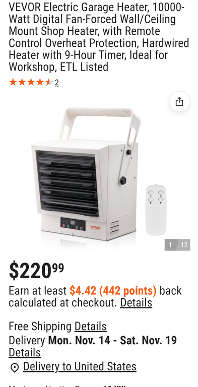

wh500special 2,474 #38 Posted November 13, 2023 4 hours ago, ebinmaine said: Good catch Bob. They're $221 each plus wiring and breakers. I edited my post. Any specs or links? Steve 1 Share this post Link to post Share on other sites
ebinmaine 81,283 #39 Posted November 13, 2023 1 hour ago, wh500special said: Any specs or links? Steve They also sell a 7500 watt model. That's around $135 I think. Share this post Link to post Share on other sites

wh500special 2,474 #45 Posted November 14, 2023 1 hour ago, ebinmaine said: They also sell a 7500 watt model. That's around $135 I think. Thanks. I need a couple electric heaters at work and the price sounded good. 👍🏻 Steve 1 Share this post Link to post Share on other sites
