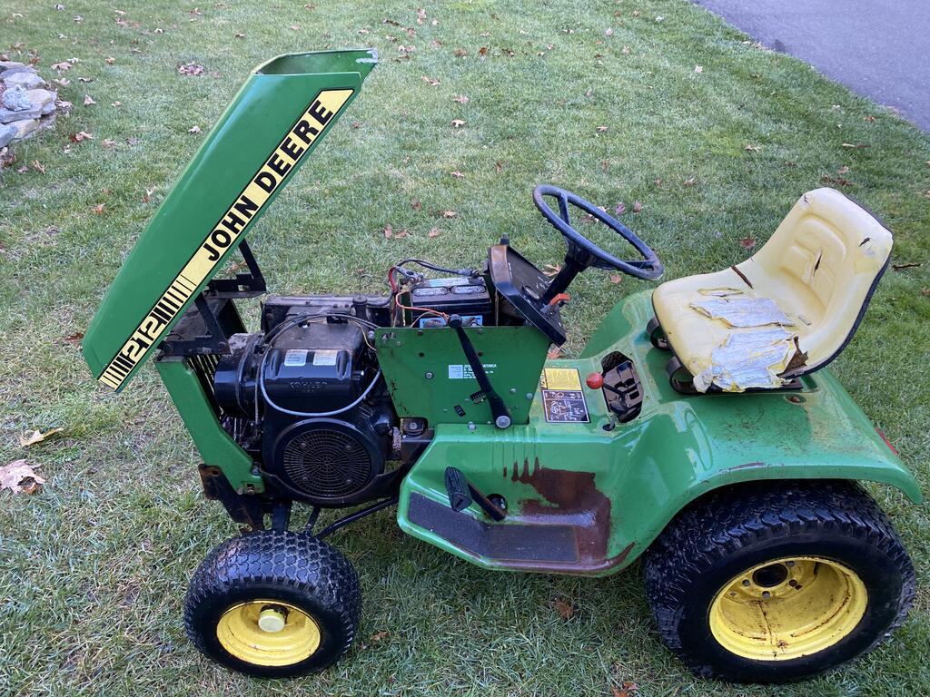

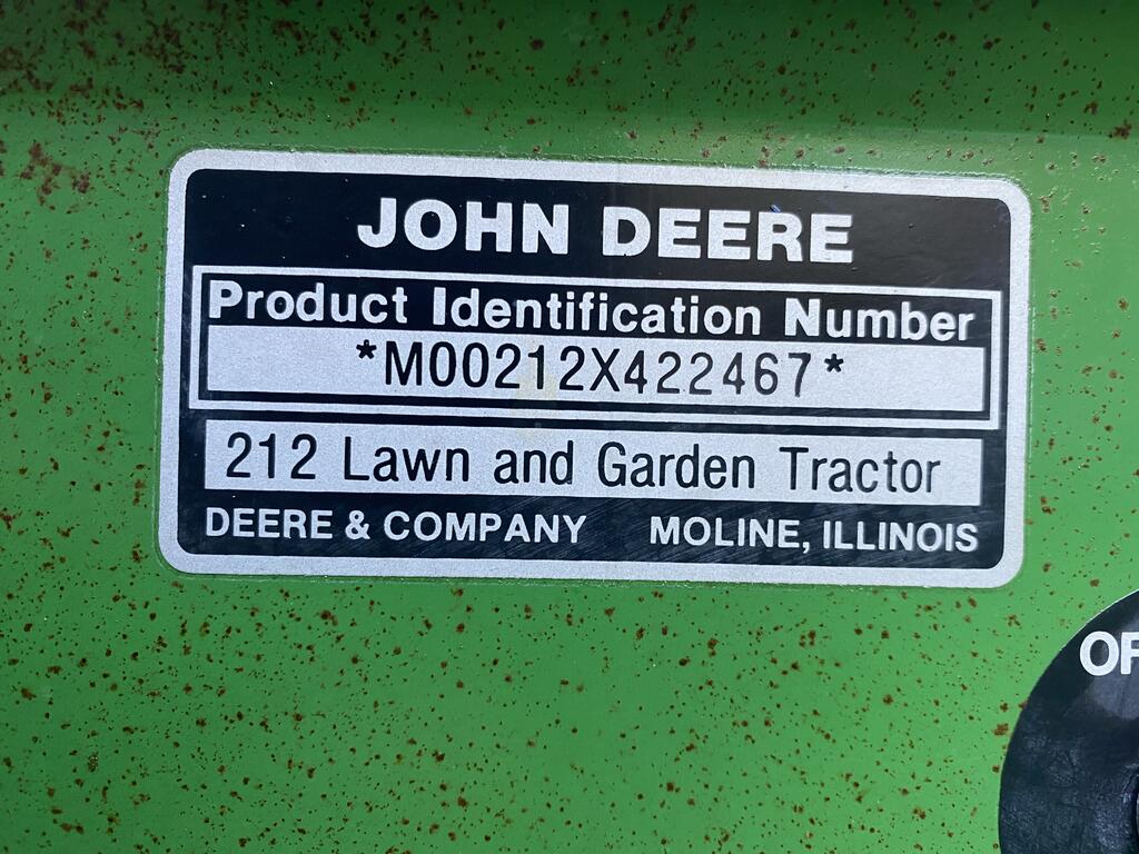

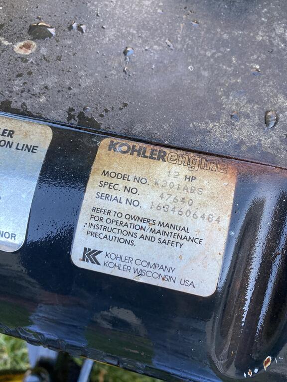

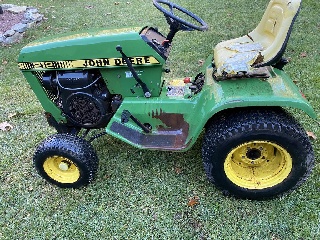

Sparky-(Admin) 26,387 #1 Posted November 12, 2023 Hauled this home today. Keeping the rear weights and selling the tractor. Turns over with a jump so the motor isn’t locked up ! So what year is is? Desirable? I included a pic of the data plate. I know I could “google it” but rather use our non-WH section instead. 1 Share this post Link to post Share on other sites
oliver2-44 11,758 #2 Posted November 13, 2023 The ten digit Kohler serial number beginning with 16 was manufactured in 1986. The John Deere Model M00212x was built from 83 to 87. The JD serial number 422467 fits in the 420001 to 475000 range that was manufactured in 1987 https://partscatalog.deere.com/jdrc-services/v1/image/getAttachment/200__210__212__214_and_216_Lawn_and_Garden_Tractors__Introduction?a=5867&br=1061&locale=en-US 1 Share this post Link to post Share on other sites
Achto 32,781 #3 Posted November 13, 2023 4 hours ago, Sparky said: Desirable? In my area JD = $. Always someone willing to buy it just because it says John Deere on it. 3 Share this post Link to post Share on other sites
T-Mo-(Moderator) 4,973 #4 Posted November 13, 2023 The John Deere 200 series were the replacement for the square fender 110 and 112 and debuted in 1975 and were built until 1987. They were solid, durable tractors with heavy duty frames, Kohler single cylinder engines, 2300 Peerless 4 speed transmission and all but the 208 had variable speed. The line included the 200, 208, 210, 212, 214 and 216. The last two digits represented the horsepower, except the 200 which had a 8 hp Kohler. The 200 and 208 were one or two year tractors. There are thousands of the 200 series tractors out there since it was a very popular model in it's day. I had a couple of 210s, a couple of 214s and a 208, which I wish I still had. Mike, just send that 212 my way...... See this link for more info: https://www.wfmachines.com/threads/200-series-tractors.134673/ 2 Share this post Link to post Share on other sites
Sparky-(Admin) 26,387 #5 Posted November 13, 2023 25 minutes ago, T-Mo said: Mike, just send that 212 my way...... See this link for more info: https://www.wfmachines.com/threads/200-series-tractors.134673/ If you were only closer! Appreciate the info 1 Share this post Link to post Share on other sites

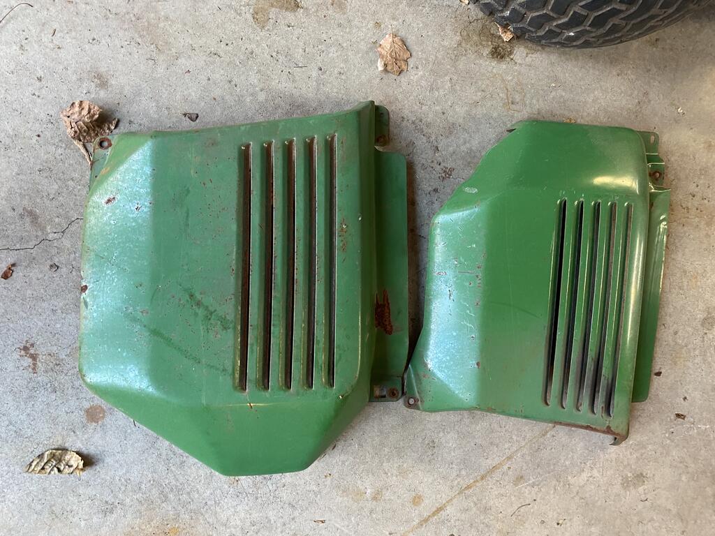

T-Mo-(Moderator) 4,973 #6 Posted November 13, 2023 34 minutes ago, Sparky said: If you were only closer! Appreciate the info BTW, that one is missing the engine side panels which isn't uncommon since the right side panel has to be taken off to adjust the pto clutch or to replace mower deck drive belts (as well as the transmission drive belt). Share this post Link to post Share on other sites
Sparky-(Admin) 26,387 #7 Posted November 13, 2023 20 minutes ago, T-Mo said: BTW, that one is missing the engine side panels which isn't uncommon since the right side panel has to be taken off to adjust the pto clutch or to replace mower deck drive belts (as well as the transmission drive belt). I have em…we’re already off when I picked it up. 2 Share this post Link to post Share on other sites

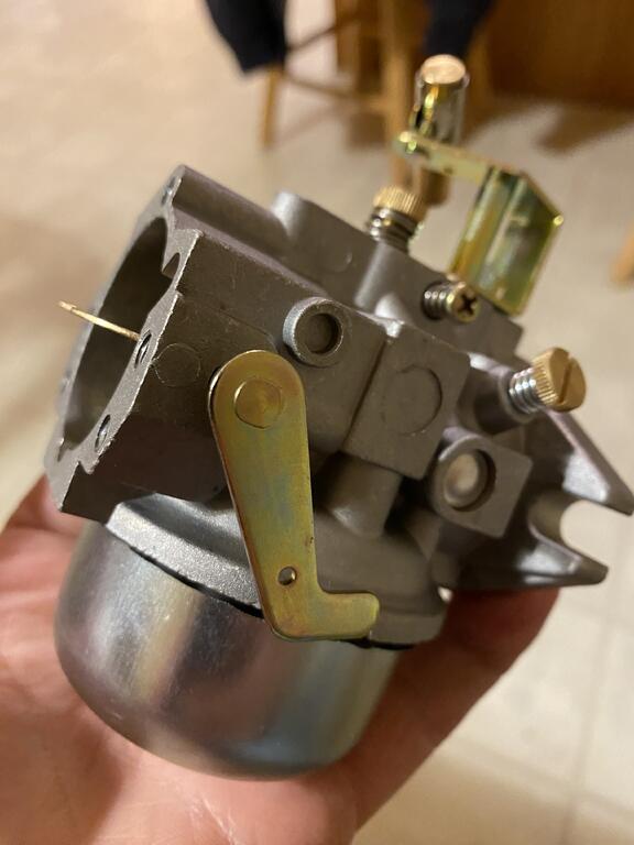

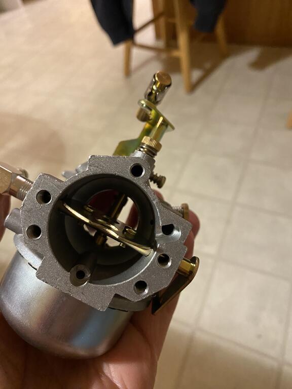

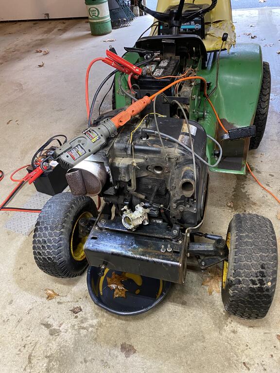

Sparky-(Admin) 26,387 #8 Posted December 2, 2023 She just wouldn’t run on the original fixed jet carb no matter what I did. So an Amazon $24 made in China carb to the rescue. Fired right up and runs well without any adjustments https://youtube.com/shorts/2NzYQ9zWV7g?si=oS9LviieNzt7cJhg 1 Share this post Link to post Share on other sites

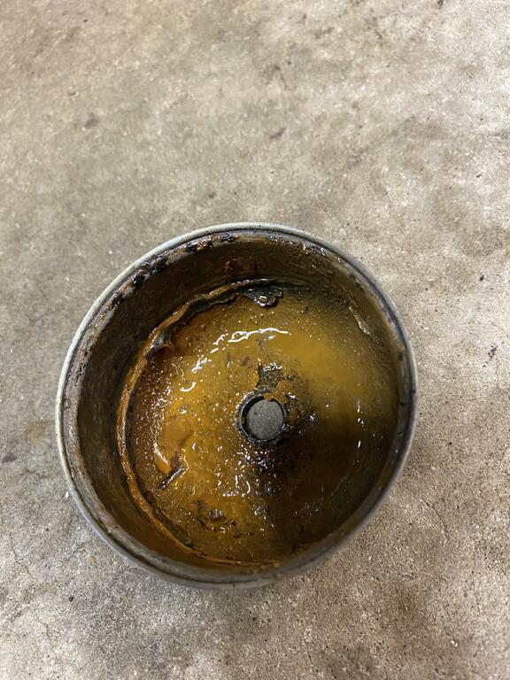

Sparky-(Admin) 26,387 #9 Posted December 2, 2023 By the way.. this is how the bowl looked when I first removed it from the original carburetor… Share this post Link to post Share on other sites
peter lena 10,074 #10 Posted December 3, 2023 @Sparky been using STA BIL in all my engines for years now , fuel filter near tank another closer to carb , fuel filters are clean / clear , there is nothing at all in my carb bowls , 3 horses , stand by generator , walk behind blower , always top off my tank after use , and always add 1, 1/2 oz of STA BIL fuel storage treatment to my tank , all my fuel lines are clear vinyl fuel rated . there is no break down anything in the carbs . did a base line clean out , before STA BIL , to try it out , zero fuel debris since , heard all the ethanol stories , thats all I use , with zero issues , helps maintain a clean / clear fuel system . my fuel experience . Pete Share this post Link to post Share on other sites
Sparky-(Admin) 26,387 #11 Posted December 3, 2023 Thanks Pete. This tractor has been sitting with water in “everything” for a few years. She now has an in-line filter and a clean fuel system and a new carb. Little more tweaking and it will be up for sale. 1 Share this post Link to post Share on other sites
ML3 2,510 #12 Posted December 5, 2023 On 12/2/2023 at 6:27 PM, Sparky said: She just wouldn’t run on the original fixed jet carb no matter what I did. So an Amazon $24 made in China carb to the rescue. Fired right up and runs well without any adjustments https://youtube.com/shorts/2NzYQ9zWV7g?si=oS9LviieNzt7cJhg Hate to admit but so far I been good 3 for 3 on the Amazon cheapo carbs. 🤞 Put one on my 604 (sold it but it's still running) 654 & C105- both those are my "working" tractors. Eventually I'll get around to rebuilding my OEM carbs. I'll be curious to see how they stand test of time. I do only run non-ethanol fuel. Share this post Link to post Share on other sites
