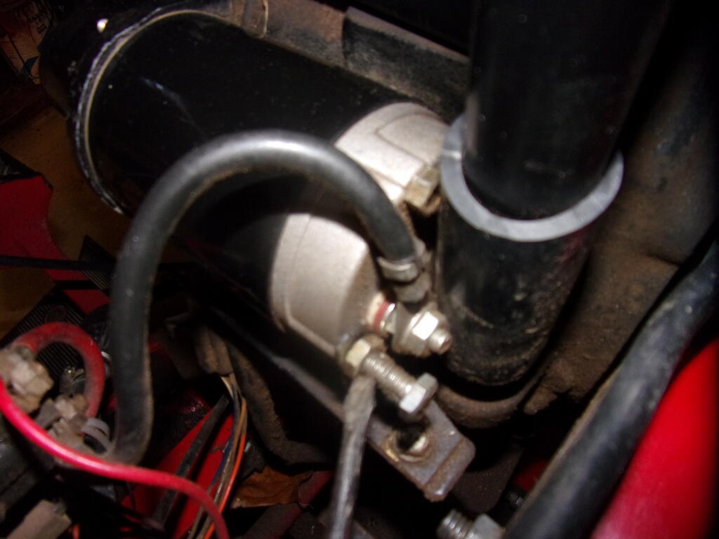

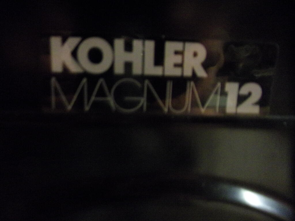

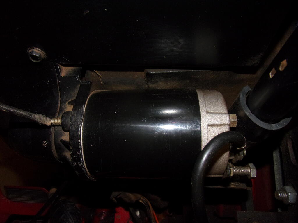

Ed Kennell 45,323 #14 Posted November 11, 2023 12 minutes ago, Gasaholic said: On a Magnum? Nah, I think you're thinking of the Command This is a Magnum 12. Maybe a Mag 10 is different, but I doubt it. Here you can see the long starter assembly bolts that also thread into the block bracket. Here is the bolt that attaches the rear of the starter to the support bracket. You can also see the piece of rubber hose around the oil fill pipe to isolate the 12volt lug on the starter. 1 Share this post Link to post Share on other sites

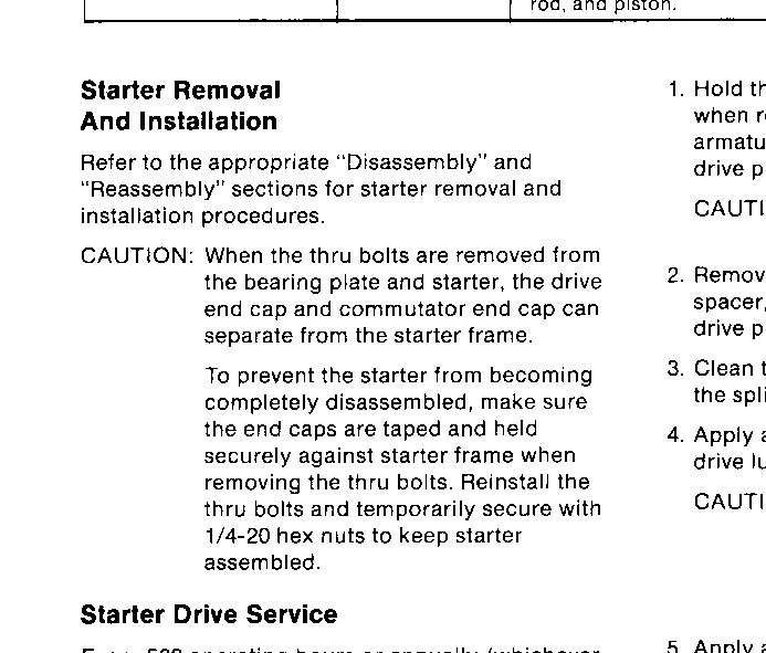

pfrederi 20,060 #16 Posted November 11, 2023 Be careful removing Magnum starters they can fall apart. 5 Share this post Link to post Share on other sites
Ed Kennell 45,323 #17 Posted November 11, 2023 3 minutes ago, pfrederi said: Be careful removing Magnum starters they can fall apart. Good point Paul. I always use a shorter bolt and nut in the near hole to hold it together while removing and installing the long bolt near the block. 1 Share this post Link to post Share on other sites
