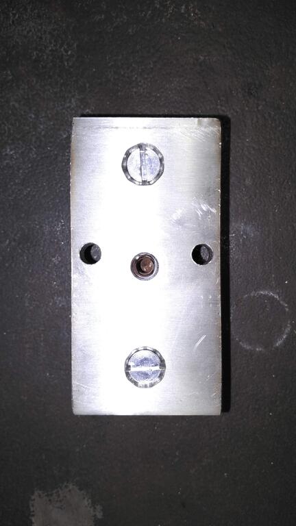

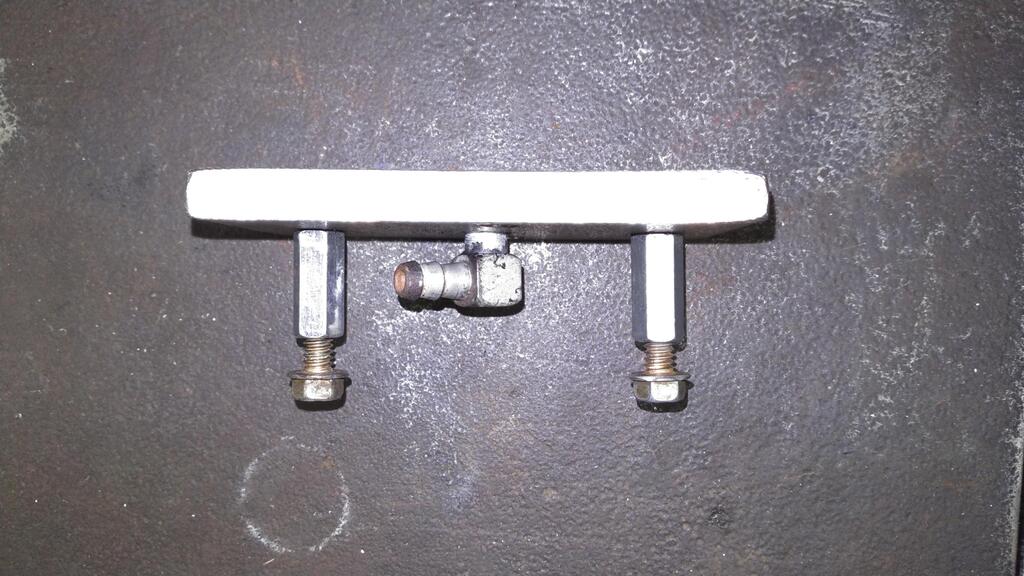

Bill D 2,997 #13 Posted November 13, 2023 I make a plate like this and use it to install a commonly available pulse pump. Works well. Share this post Link to post Share on other sites
