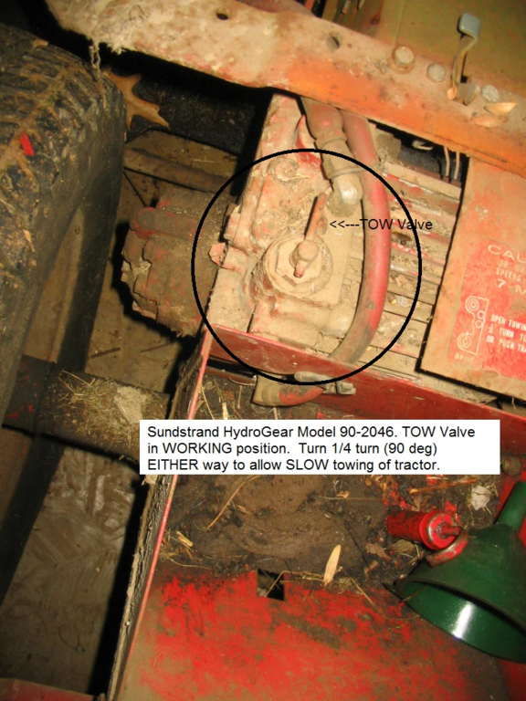

daveoman1966 3,884 #32 Posted November 13, 2023 If original, the Charger 12 would have the Sundstrand HydroGear model 90-2046. Here is a pic of the TOW VALVE on top. Turn this TOW VALVE 90deg --left or right-- to tow the tractor. Even then, tow it slowly---at a walking pace...not fast. 1 Share this post Link to post Share on other sites

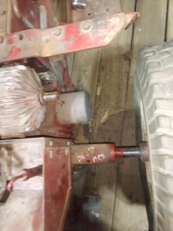

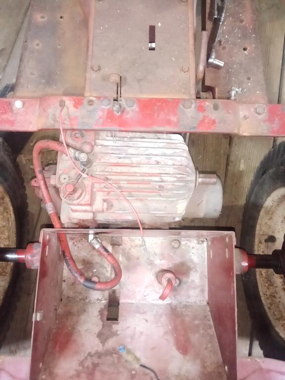

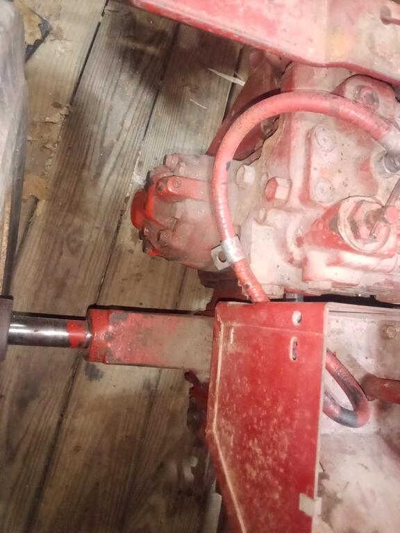

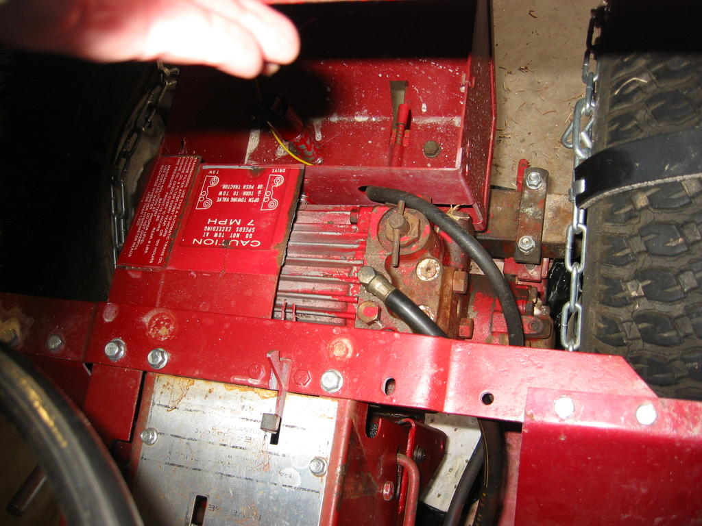

daveoman1966 3,884 #34 Posted November 13, 2023 15 minutes ago, Colby G said: I've swapped it out, but idk if it came out of a charger 12, it's quite a bit wider than the old one. Post a couple pics of what you now have... Left side, top, and right side. Share this post Link to post Share on other sites
Colby G 248 #35 Posted November 13, 2023 3 minutes ago, daveoman1966 said: Post a couple pics of what you now have... Left side, top, and right side. Share this post Link to post Share on other sites
Colby G 248 #36 Posted November 13, 2023 (edited) There's your pictures!👍 Edited November 13, 2023 by Colby G Share this post Link to post Share on other sites
daveoman1966 3,884 #37 Posted November 14, 2023 Although the GEAR BOX may have been swapped out (wider axles), the HydroGear is still the power source...of which there are but 3 models...90-2046, 90-2062 (GT-14 tractor) and an older version model 310007. Noting that the INPUT SHAFT of your pump is the 'Double-D' shape...likely a pre 1972 model. ANYWAY... the single hyd line shown in your pic effectively bypasses the hydraulic lift system. Share this post Link to post Share on other sites

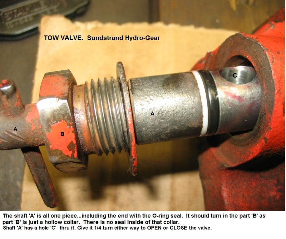

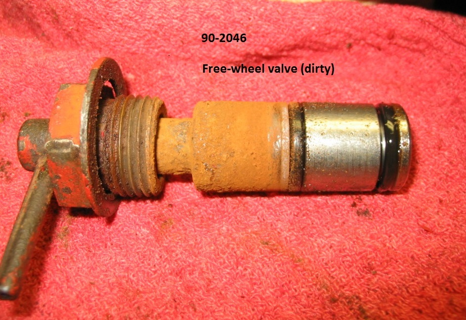

daveoman1966 3,884 #41 Posted November 14, 2023 Here again is the TOW VALVE (free-wheel valve) with the LEVER in PARALLEL position...for normal operation. It does not matter whether the 'long' end of the lever is to the front or back of the tractor...either way is for NORMAL operation. For towing, turn the TOW VALVE...left or right... so that it is PERPENDICULAR TO the tractor frame. That LONG end of the lever is to make it easier to turn...that's all...except that if turned toward the back, it MAY cut into the hyd hose. The 2nd pic here is the TOW VALVE removed from the hyd pump end cap. Note that there is a hole in it...Turning the top LEVER turns this hole to either FRONT (for normal use) blocks fluid from flowing thru a BYPASS. Turn it Left or Right, then the fluid BYPASSES ---releasing pressure---and allows for towing... SLOWLY. 1 Share this post Link to post Share on other sites
