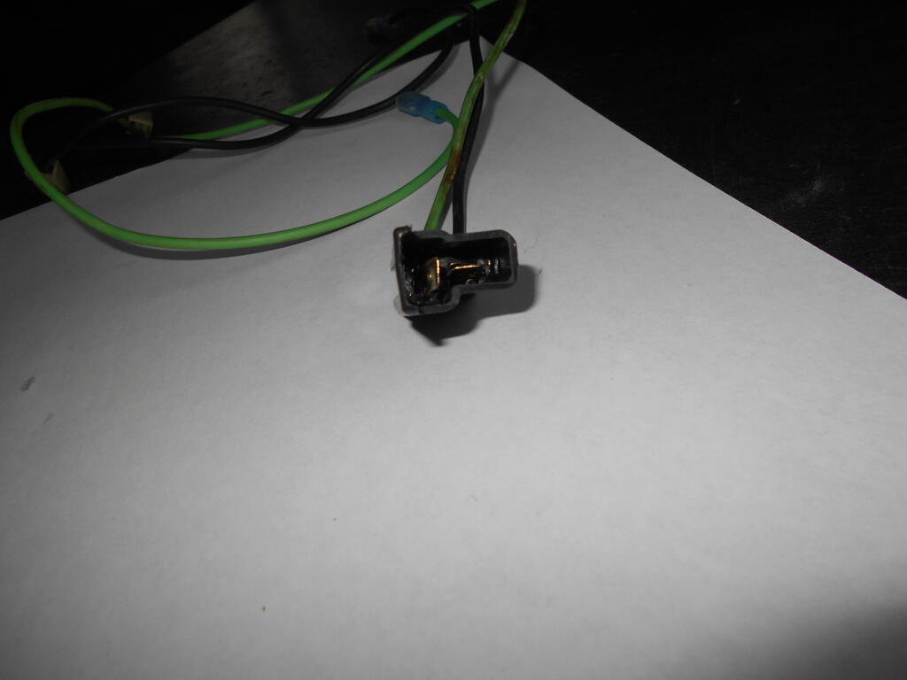

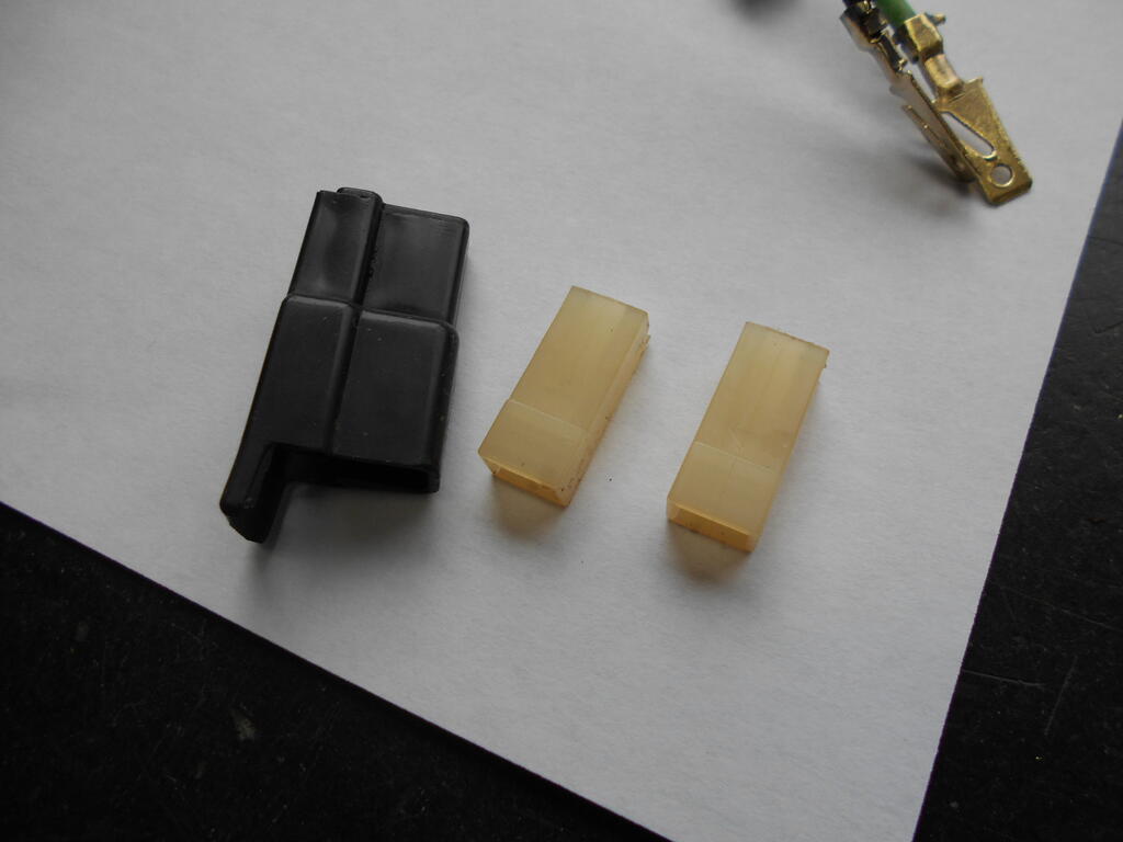

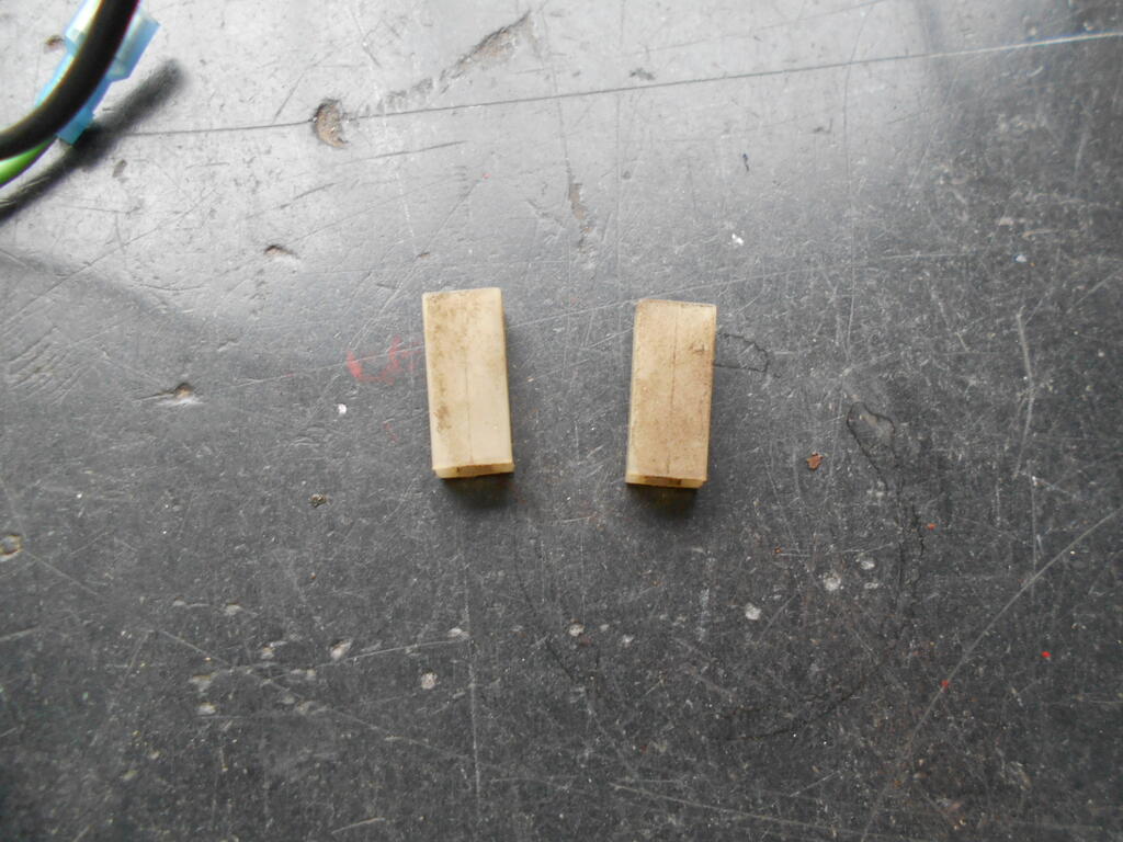

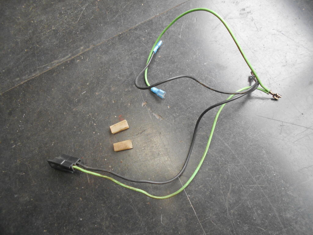

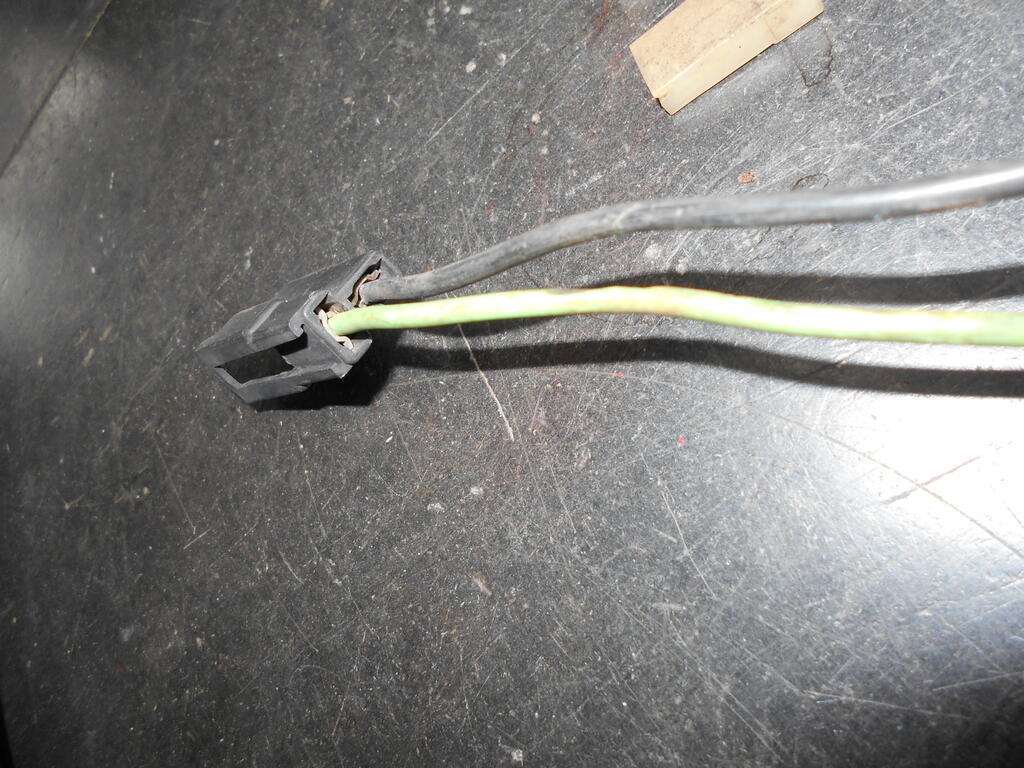

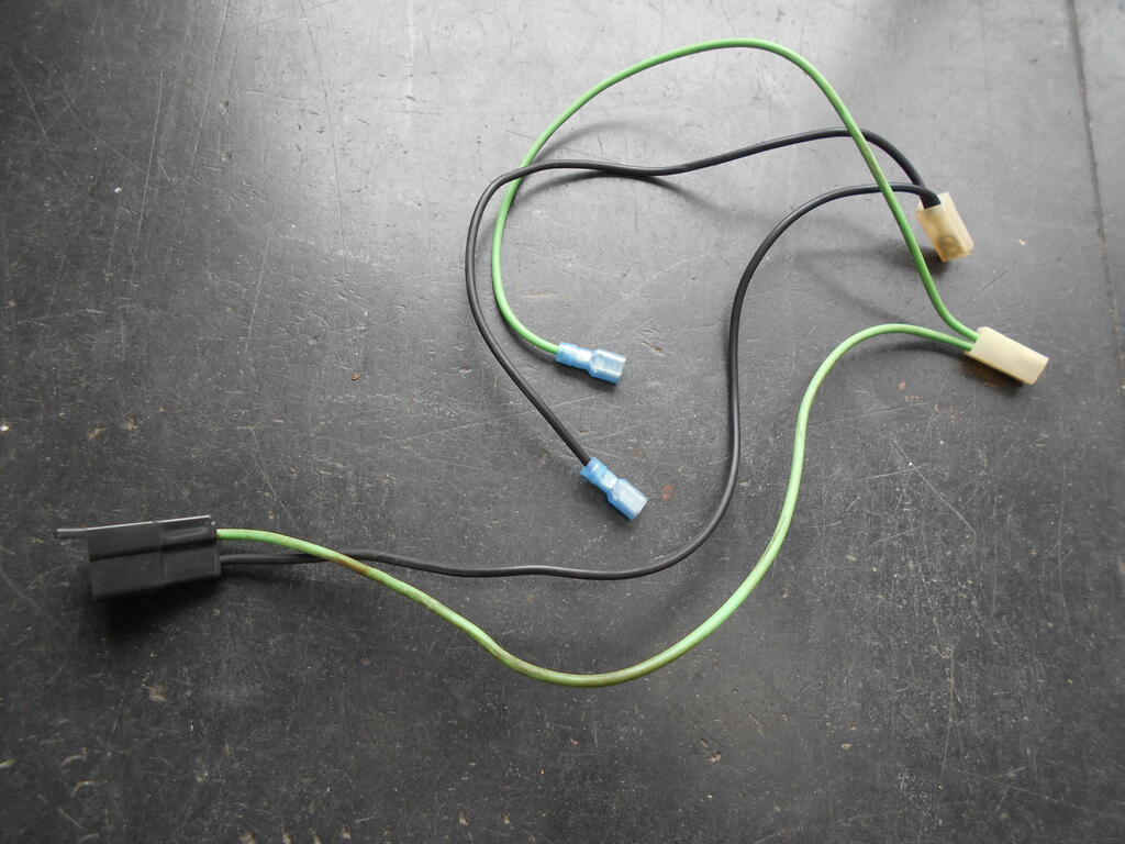

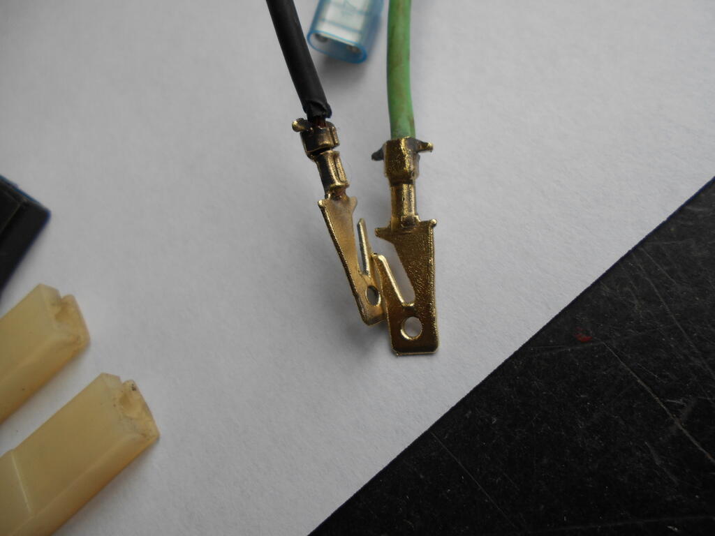

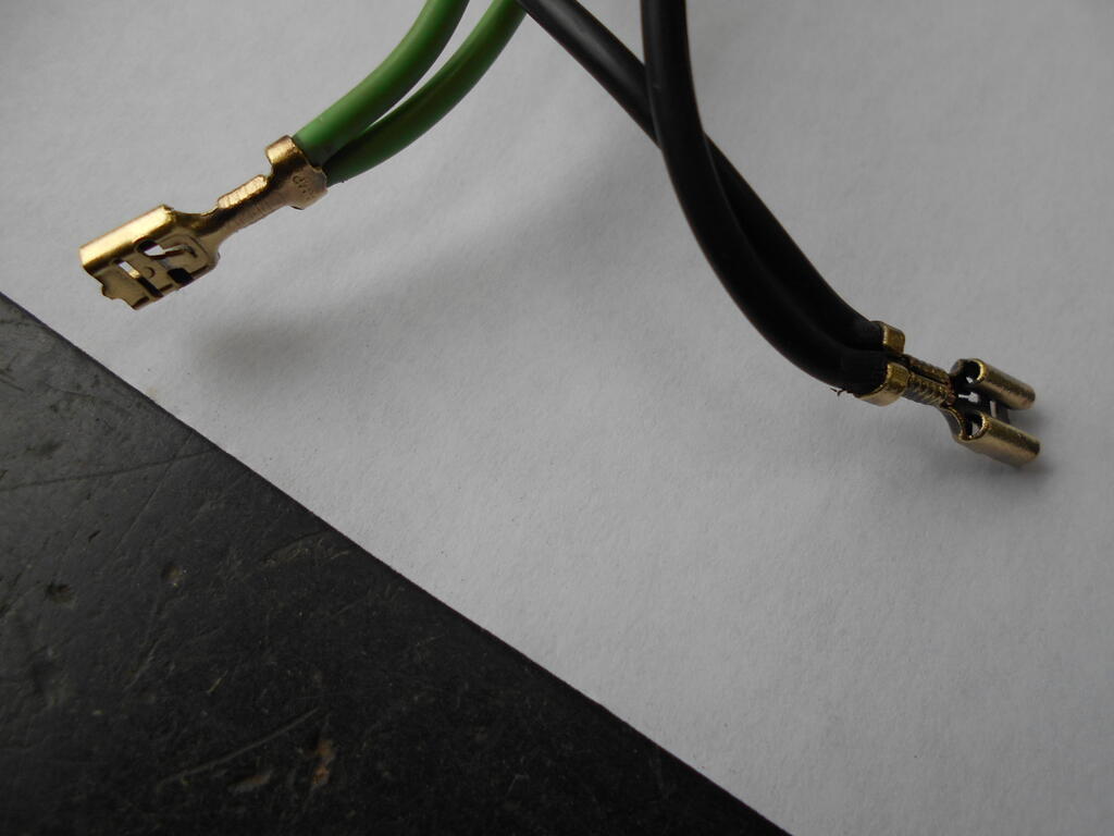

cleat 9,333 #151 Posted December 28, 2023 Did a little work today cleaning up the headlight harness for the hood. This is the entire harness with the plastic covers removed from the headlight connectors and connectors partly polished. Headlight plastic connector covers as removed. Wire harness connector before disassembly and cleaning. Plastic covers cleaned up. Wire connectors polished and cleaned. Wire harness reassembled. Harness complete and ready to install. 2 3 Share this post Link to post Share on other sites

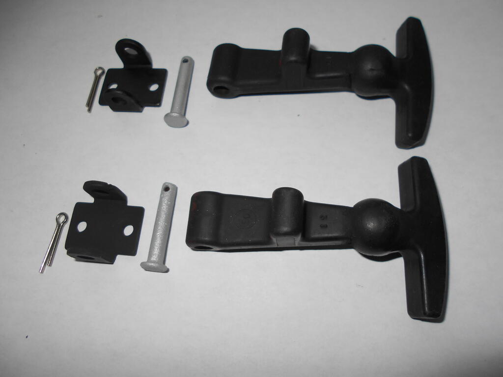

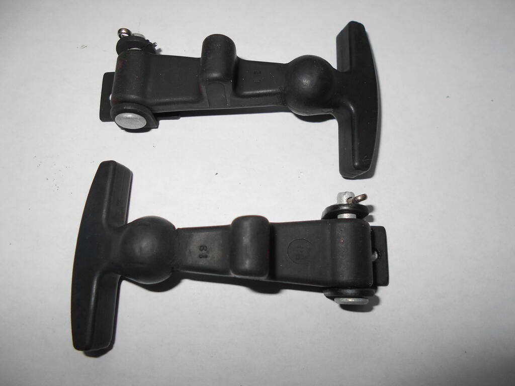

cleat 9,333 #153 Posted January 1, 2024 Hood latches ready for assembly Hood latches assembled Just working on little things while hood and fender are at the painters. 8 1 Share this post Link to post Share on other sites

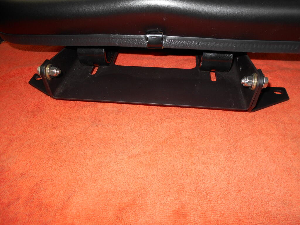

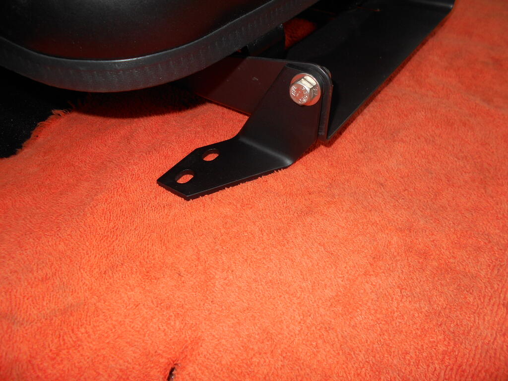

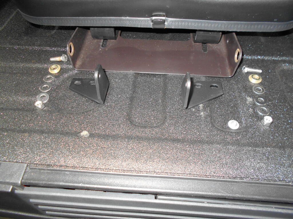

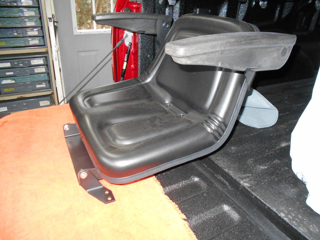

cleat 9,333 #154 Posted January 2, 2024 Seat assembly was already restored on this machine a couple of years ago. The paint was messed up on the pivot brackets so I pulled them, sanded them smooth and flat then primed and painted in low gloss black. They have been drying for a few weeks so I decided to put the seat assembly together today. New stainless steel hardware and pivot bushings were used. One side complete Seat assembly ready for installation. 5 2 Share this post Link to post Share on other sites

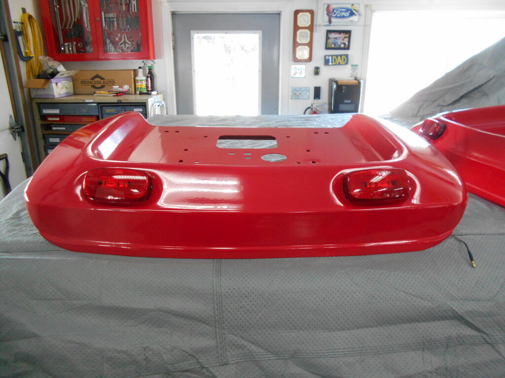

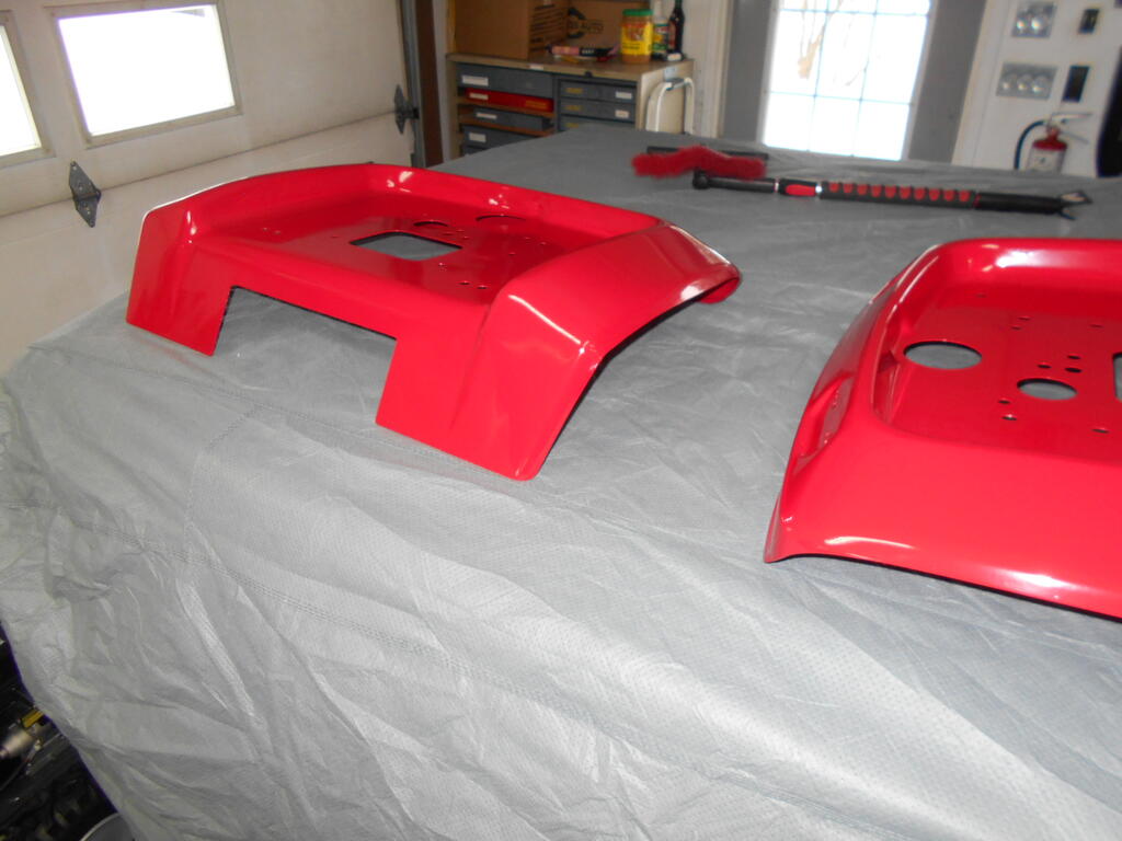

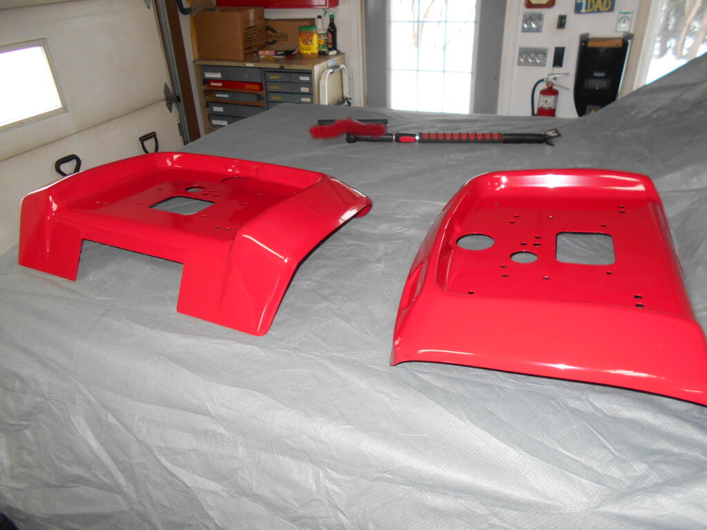

cleat 9,333 #155 Posted January 14, 2024 (edited) Rear fenders back from my painter's One is for the 520-8 I am building and the other is for a 520H that I was working on last year that has not got finished yet. I will let these dry likely until spring as the tractors are moved to a garage out back and snowed in. He still has the hoods. The red paint is finished but he still needs to paint the black grill. Edited January 14, 2024 by cleat 1 8 Share this post Link to post Share on other sites

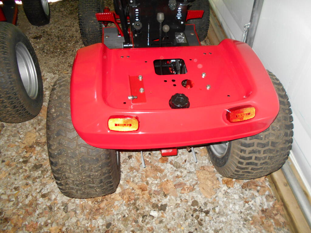

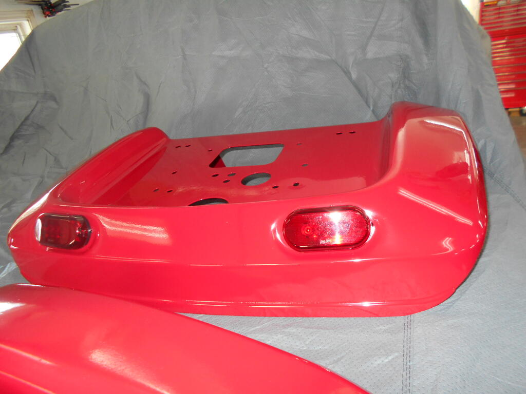

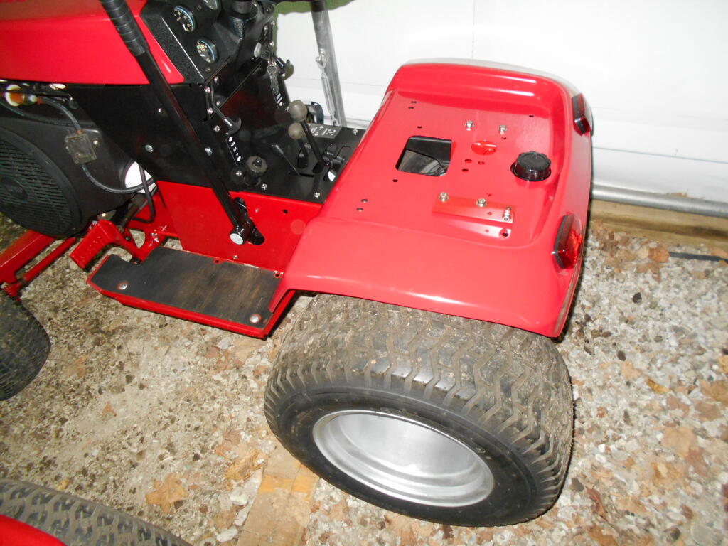

cleat 9,333 #156 Posted January 21, 2024 LED tail lights installed in the rear fenders. One of these is for this tractor and the other is for a 520H I am refinishing. 5 1 Share this post Link to post Share on other sites

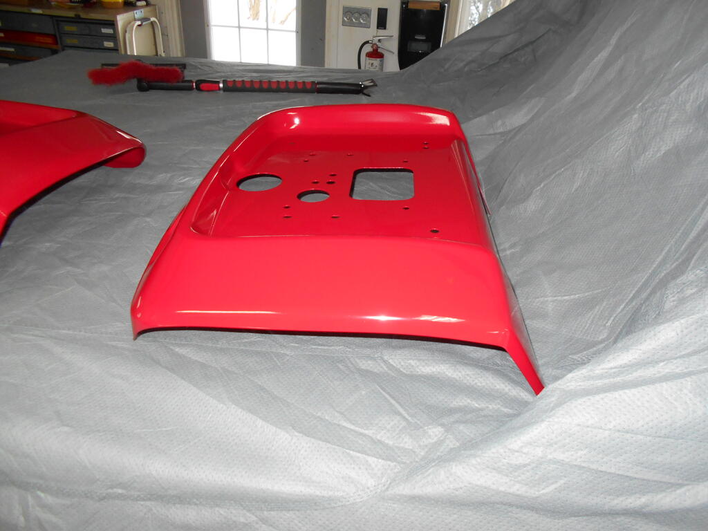

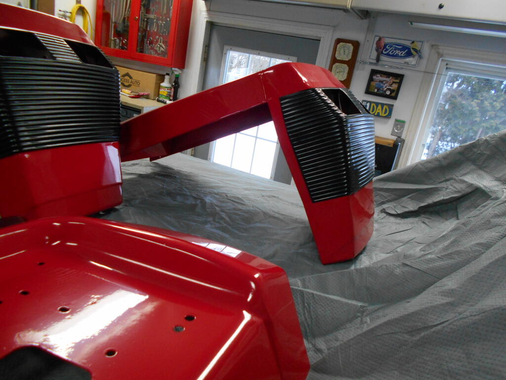

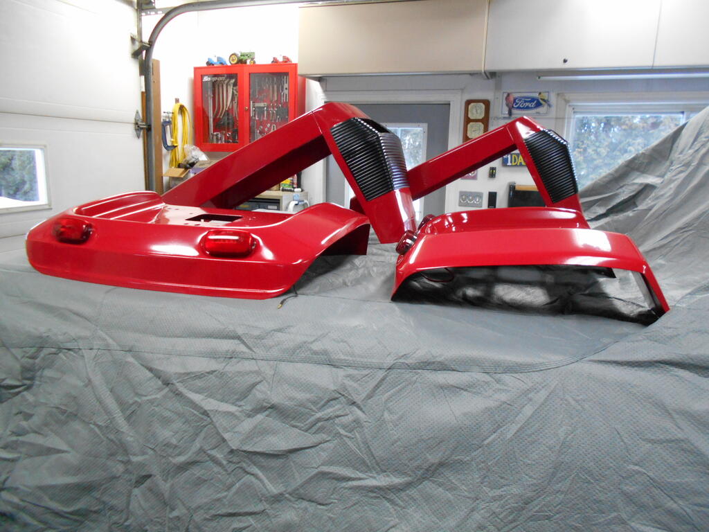

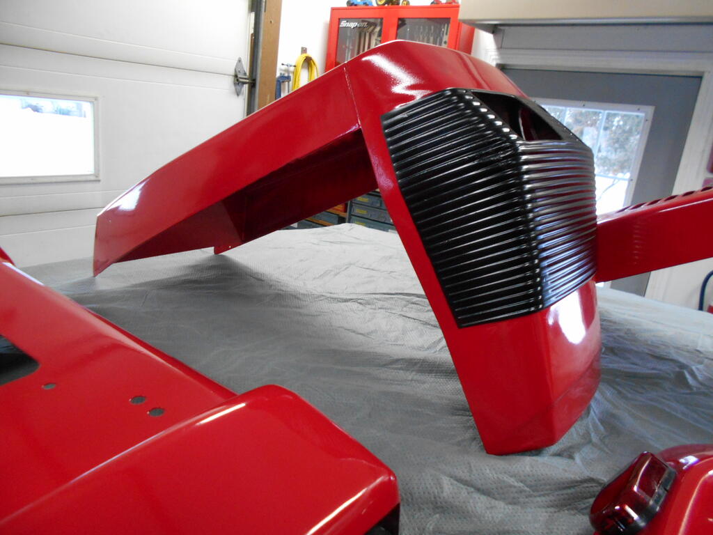

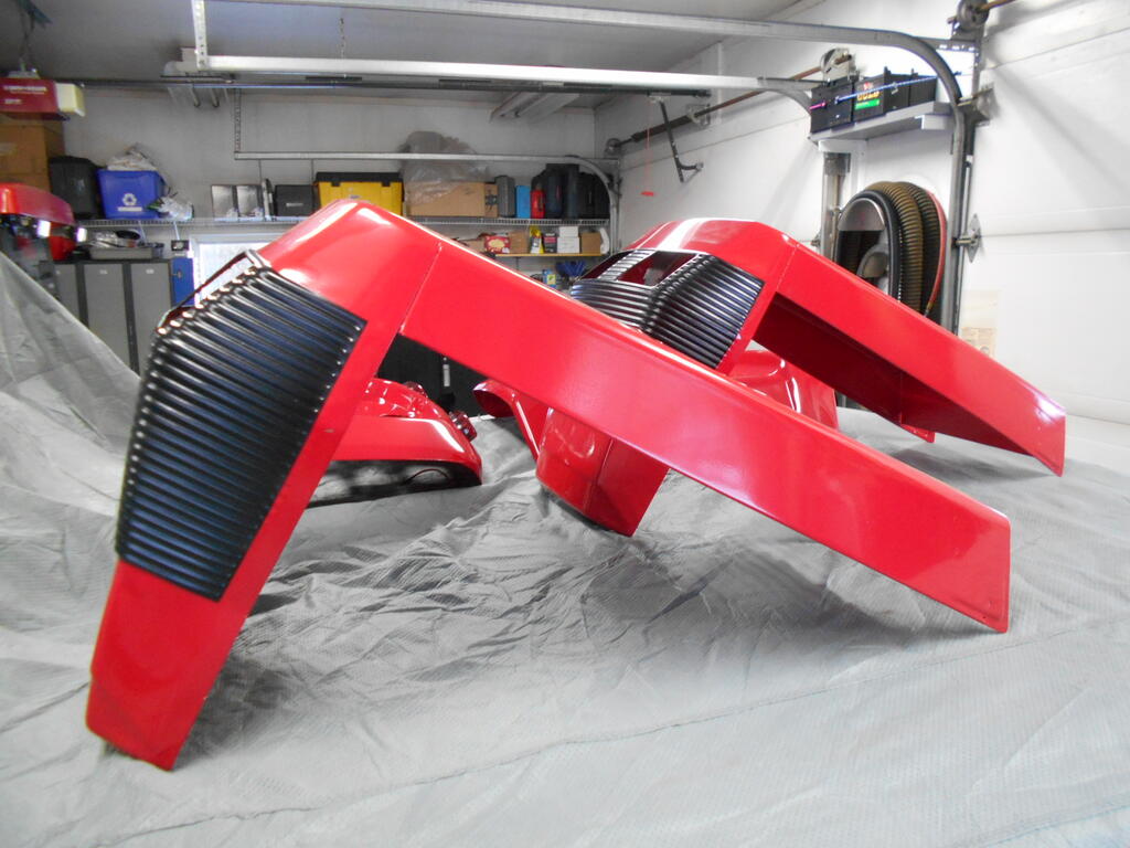

cleat 9,333 #157 Posted January 29, 2024 Hoods back from my painter. One is for this tractor and the other is for a 520H I have been working on since last year. These will sit here until the snow melts and can move the tractors from the garage out back easier. That will allow the paint to dry more as well. 2 7 Share this post Link to post Share on other sites

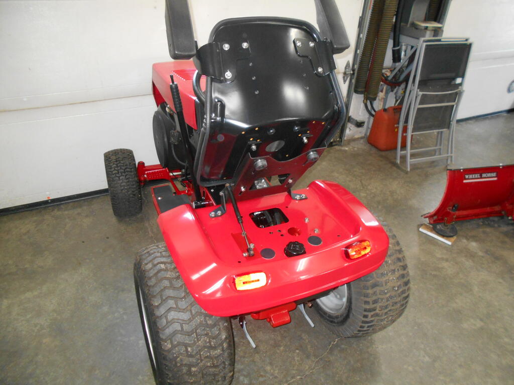

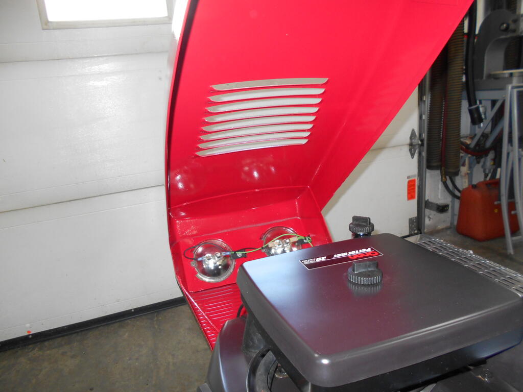

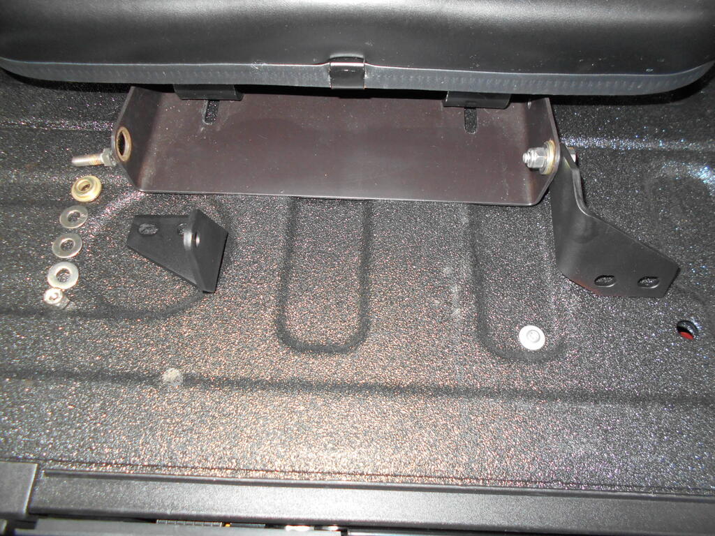

cleat 9,333 #160 Posted February 25, 2024 Fender and seat gas lift bracket bolted on using all SS hardware. Hood bolted on using SS hardware. I still need to order the decals for this machine. 6 Share this post Link to post Share on other sites

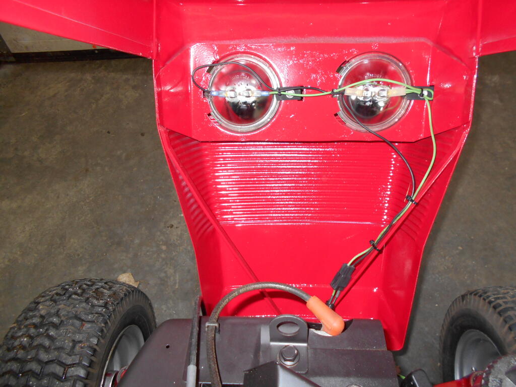

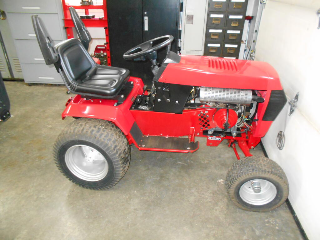

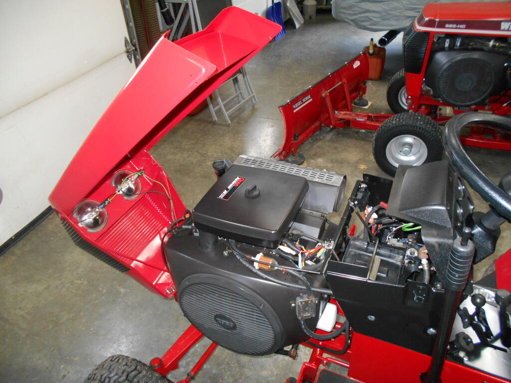

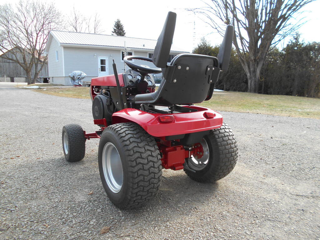

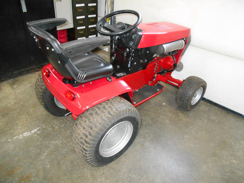

cleat 9,333 #161 Posted February 29, 2024 Moved tractor to shop. Installed seat. Installed seat gas lift and fender protectors. Hooked up headlights. Overall view of tractor as of today. 9 Share this post Link to post Share on other sites

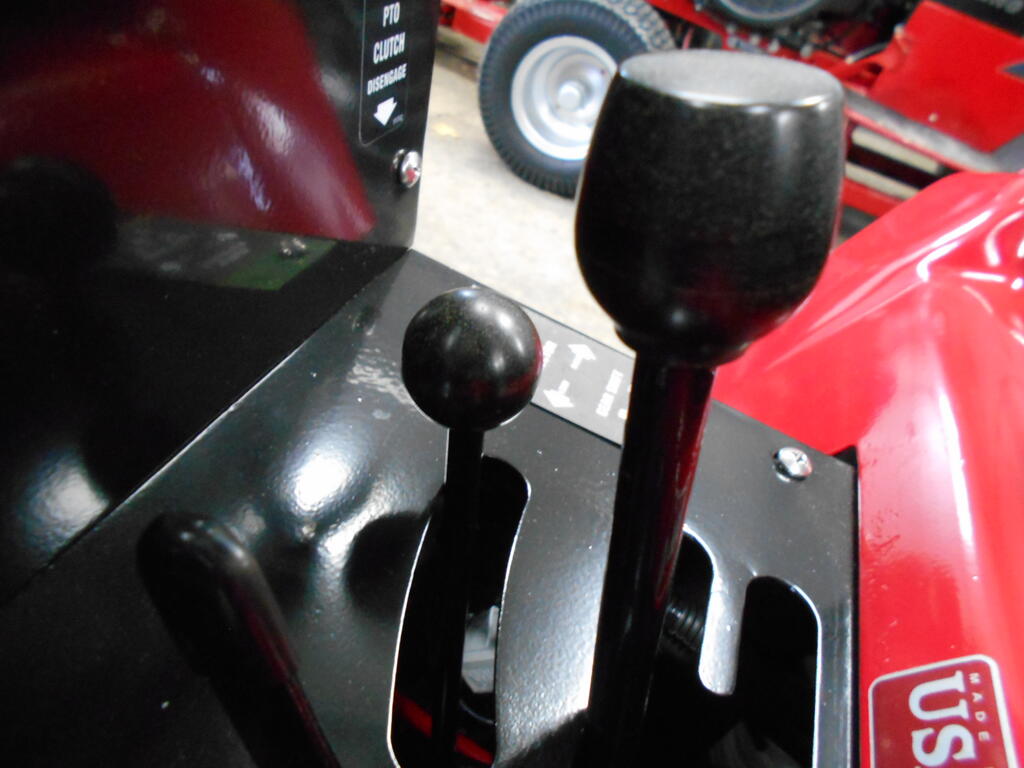

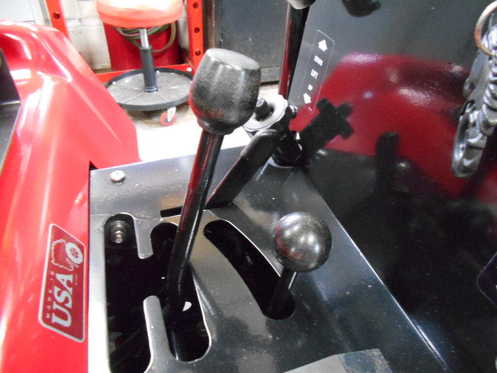

cleat 9,333 #162 Posted February 29, 2024 Polished shift knobs best I could by spinning them on a stud mounted in the drill press. I used scotch brite, then 2000 grit sandpaper followed by rubbing compound then back to black polish. Not perfect but a lot better than they were. 8 Share this post Link to post Share on other sites

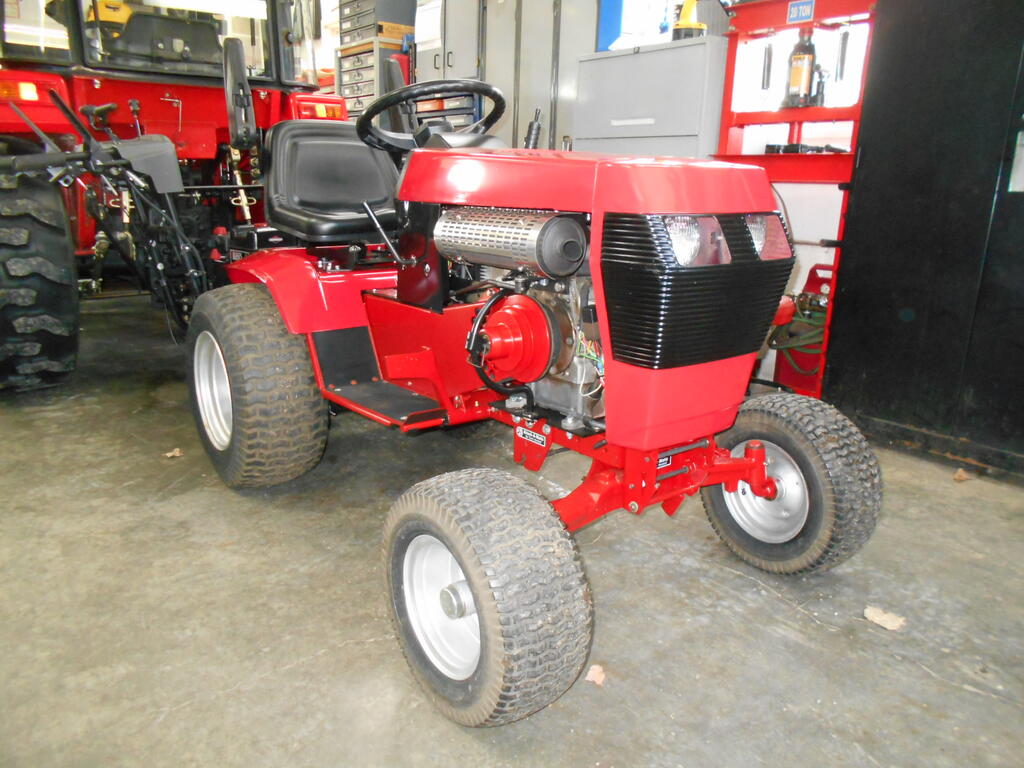

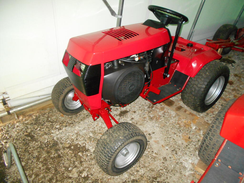

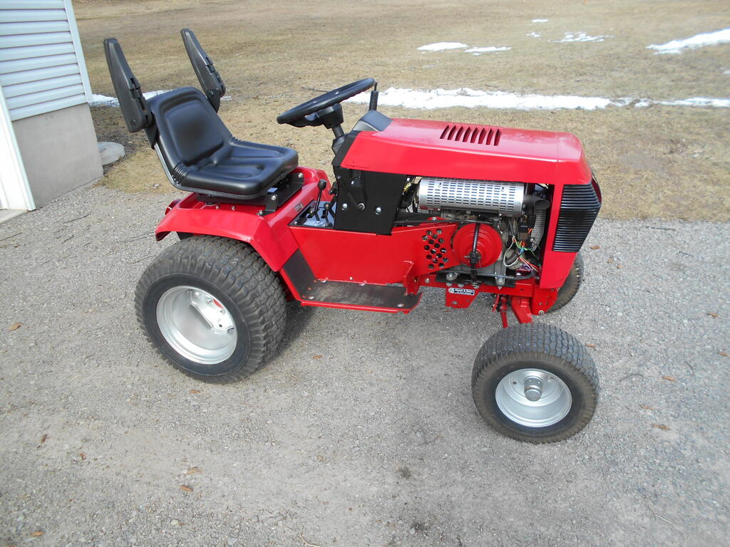

cleat 9,333 #165 Posted March 1, 2024 Put a battery in and went for a maiden drive. Machine is very fast with the hydro pulley on the engine. However, low 1 is still quite slow so it should be just fine. Now I just need to order the decals and I am good to go. 1 8 2 Share this post Link to post Share on other sites

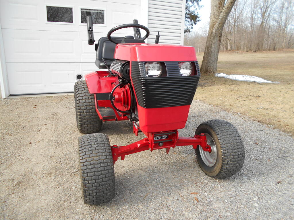

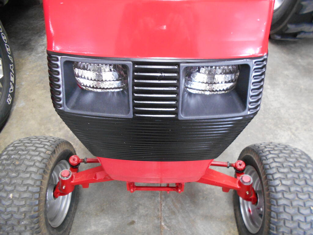

cleat 9,333 #172 Posted March 18, 2024 Headlight bezels installed. Now I need to order the decals from Terry. 1 2 Share this post Link to post Share on other sites
