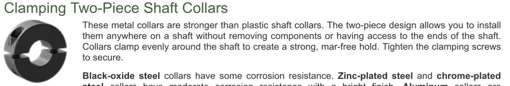

Pat Marchwick 94 #1 Posted November 6, 2023 I was putting on the single stage snowblower today and instead of washers I put a split collar clamping stop on the 3/4” diameter shaft that slides inside the lift tube. Works great and much easier to adjust the lift height. they cost no more than $10.00 depending where you buy them 3 5 1 Share this post Link to post Share on other sites
moe1965 774 #2 Posted November 6, 2023 Now that's a cool idea. 1 Share this post Link to post Share on other sites
